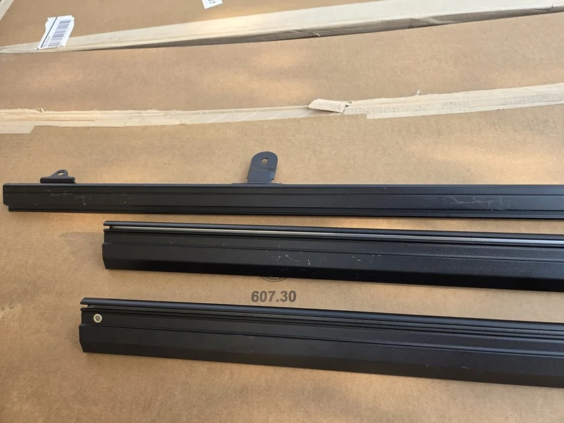

Initial Unpacking: My top was delivered and the boxes were pristine, but I discovered several damaged parts after unpacking. Two of the window J-rails have rub/scratch damage, and the passenger quarter window somehow got folded over and is creased and scuffed. The rails are hidden when the top is fully on, but exposed when the windows are off and top are up so I will be seeking warranty replacement for those. The window I will also be seeking warranty replacement on -- hopefully Bestop stands behind their products including shipping mishaps.

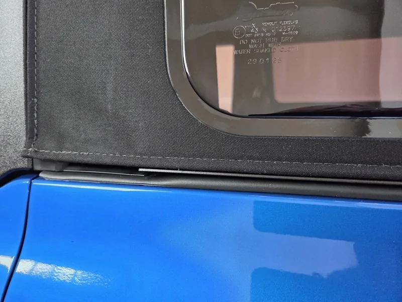

Most of the install went very smoothly, but I had one major issue that took a while to resolve. The J-rail attached to the bottom on the driver's side did not fit correctly - it butted against the B-pillar in a way that made it very difficult to line up the holes for the bolts until I loosened the B pillar attachment. I then could line up the rail to the holes. This let me get the rail on, but the B pillar attachment doesn't quite line up right now and I had to ream out the bottom hole on the B-pillar attachment a smidge to get it tightened down. The B-pillar attachment is a bit crooked as a result.

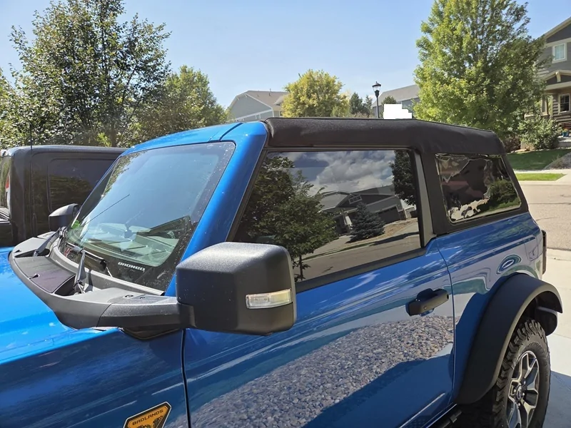

I though maybe I'd resolved this reasonably, but after getting the top fully on I note that there is a very large gap between the bottom of the window and the rear fender that is not present on the other side. It's unclear what is causing this gap -- it could be that the bottom window J-rail is bent. I will have to take it apart and look. I will wait until I put my hard top back on in a couple months though.
The driver side has an ugly gap:
Ford Bronco Bestop Trektop - 2Dr - First Impressions & Install tips 20250907_121533-sm - Copy

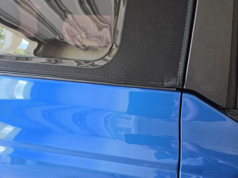

The passenger side is very nice:
Ford Bronco Bestop Trektop - 2Dr - First Impressions & Install tips 20250907_121543-sm - Copy

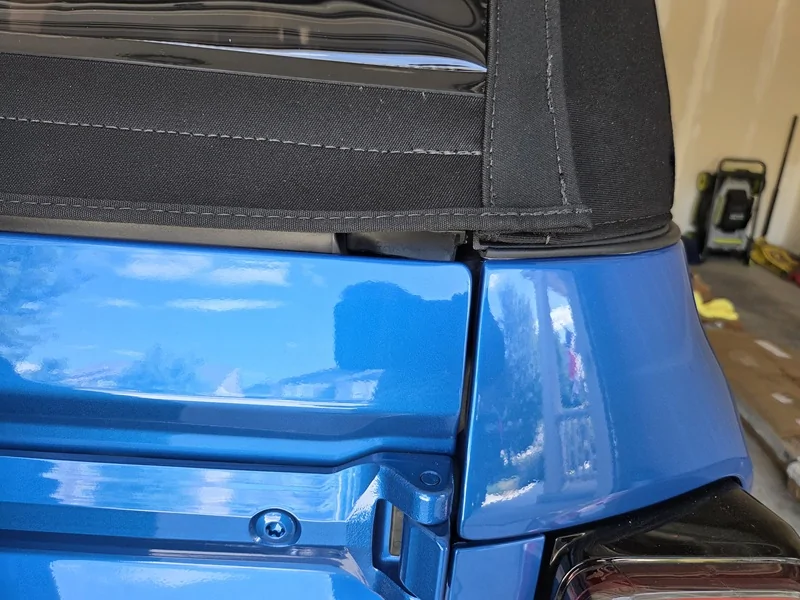

  • The weather sealing on the tailgate bar has a slot on the hinge side that leads all the way into the interior, and the top doesn't quite cover it. The tailgate needs a bit of a notch, but this goes all the way in. This is going to be a major leak area. I'll have to plug this with some weather stripping. No idea why this is here, at first impression is seems incredibly dumb.

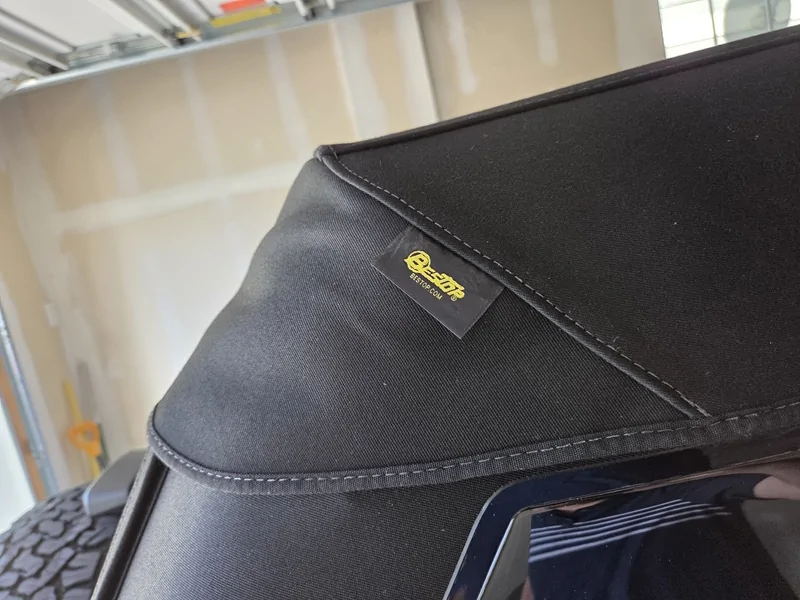

  • This tag sewed into the top is extremely annoying. A terrible idea.
Ford Bronco Bestop Trektop - 2Dr - First Impressions & Install tips 20250907_121548-sm - Copy

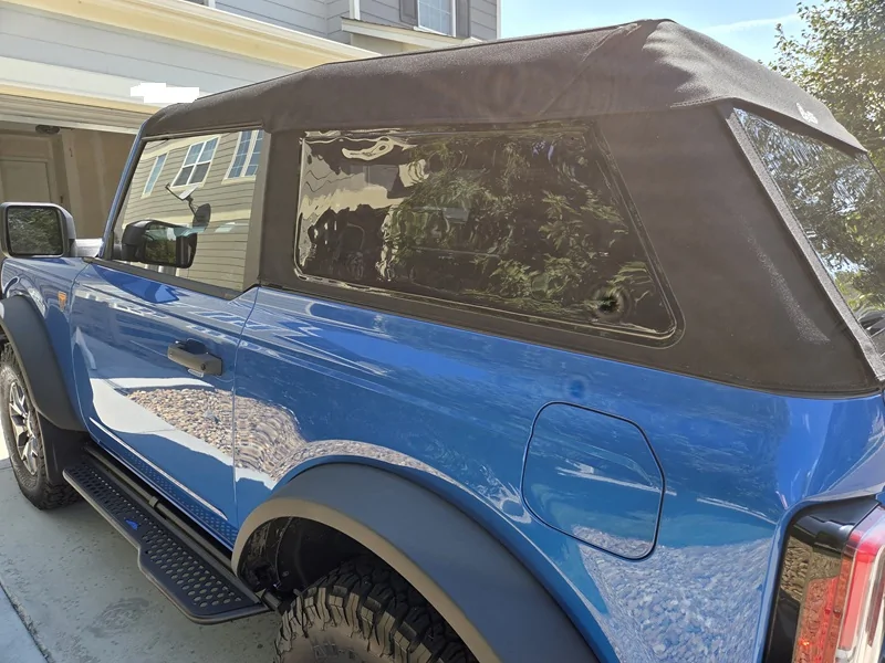

Here's a pic of the finished product:
Ford Bronco Bestop Trektop - 2Dr - First Impressions & Install tips 20250907_124639-sm - Copy
Ford Bronco Bestop Trektop - 2Dr - First Impressions & Install tips 20250907_124645-sm - Copy
Ford Bronco Bestop Trektop - 2Dr - First Impressions & Install tips 20250907_124706-sm - Copy

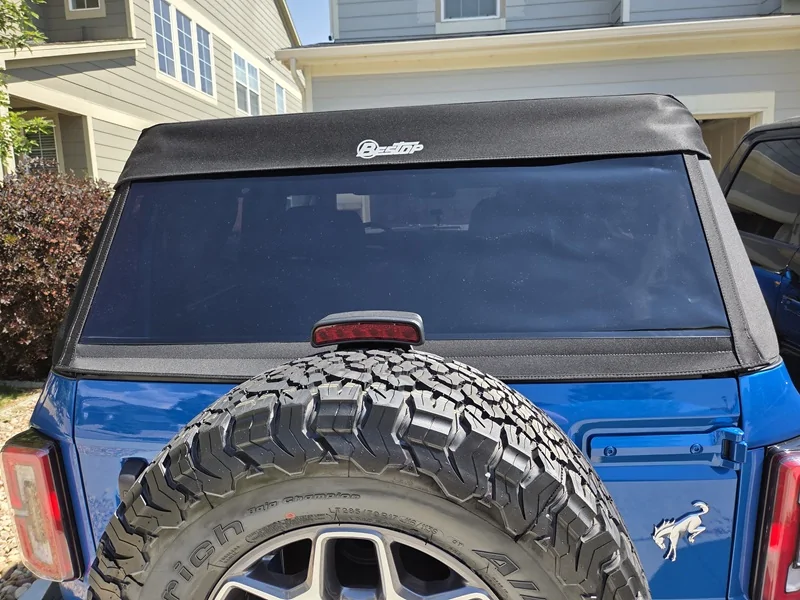

Baja Bronco
Nov 15, 2022
936
2,150
2Sun AZ
22 Ford Bronco, 20 Ford Raptor
The tag is just fine with me. It’s the hideous Bestop logo above the rear window I can’t stand. Glad I got mine before they started that. Enjoy being a member of the slant backs!
