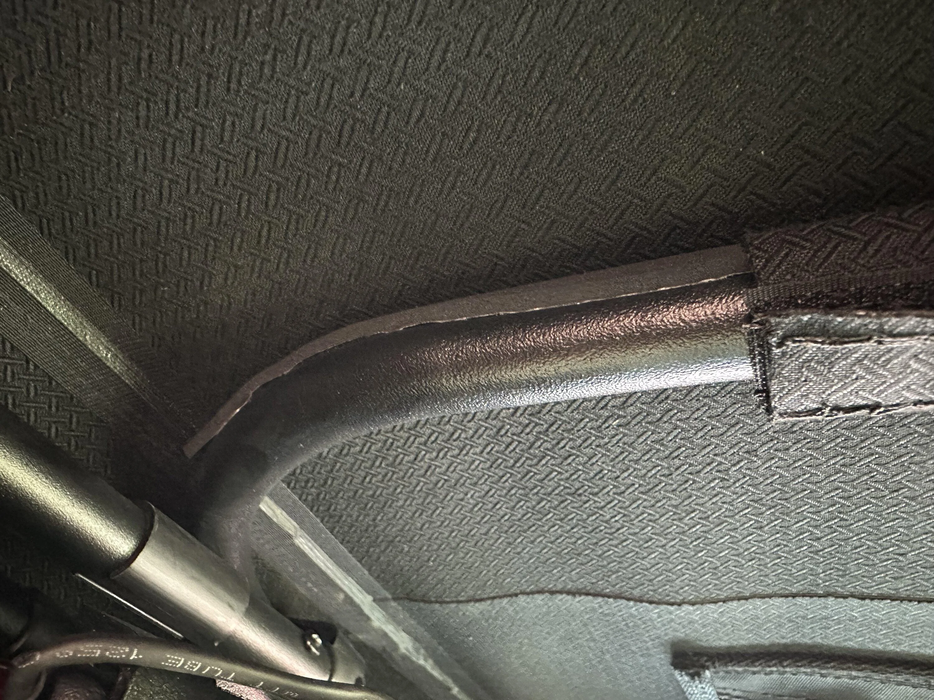

Ordered the foam strips and look forward to wrapping the bars.
THANK YOu
When taking this pic for you I remembered the area in the corner of the bend seemed to be a problem area, so that’s why i wrapped it past the Velcro.

Awesome - pics are super helpful.
Thanks again.
