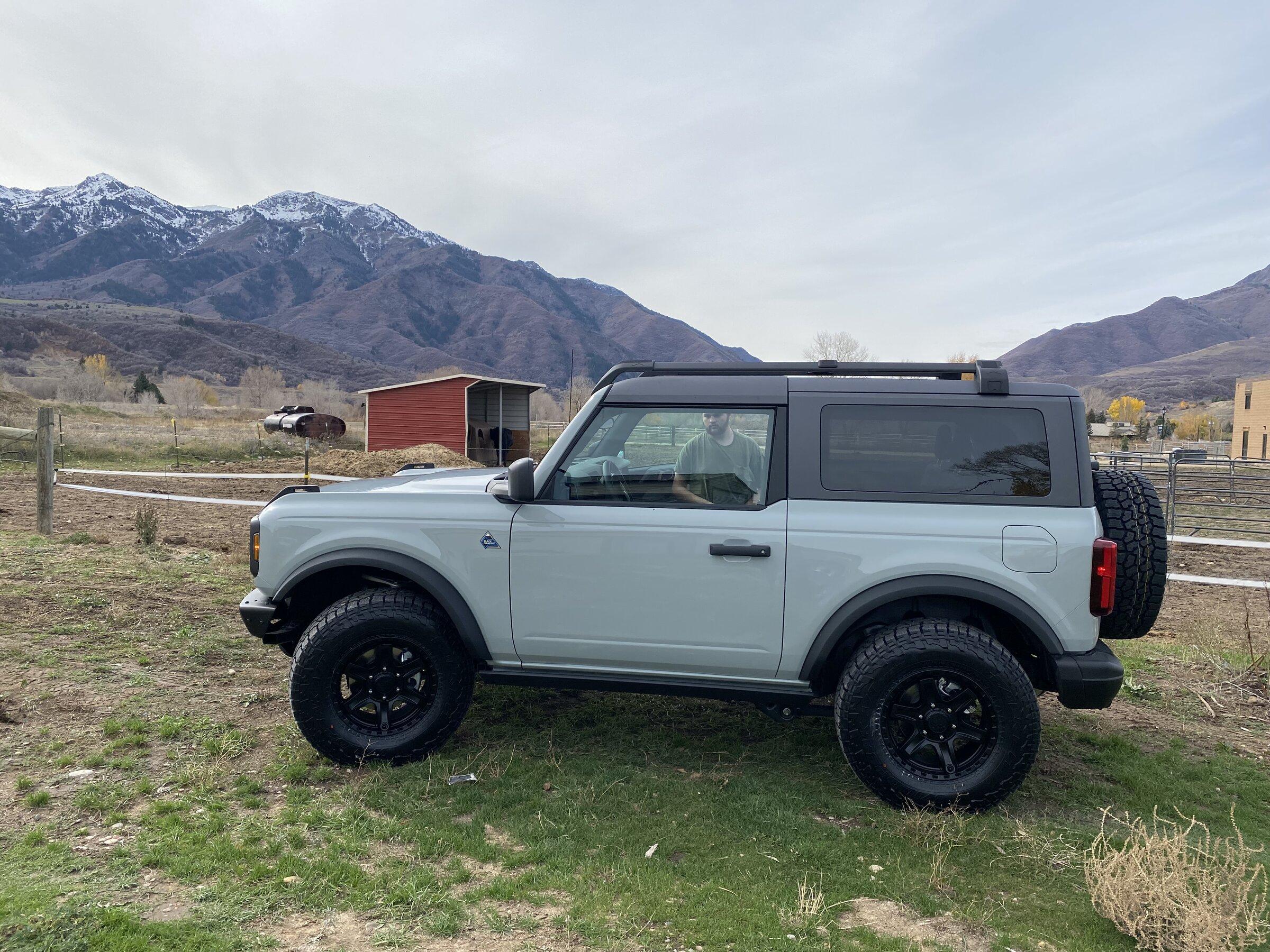

LT285/70R17s Falken ATw3s (same size as non-dad Badlands) on Alpha Delta 17x8.5 wheels with +35mm offset. They do not come even close to rubbing on anything.

The stock steelies are 17x7.5 with +55mm offset. So my wheels “push” the tires out about an inch. LT 285/70R17s will fit on the stock wheels and I’m certain they won’t rub anywhere. I kept my steelies and plan to buy a second set of 33s (MTs) to put on them for summer fun.

The 1 inch (actually 0.78") is from the difference in the offset (20mm less positive offset). Offsets are based on the center of the wheel. For example, an 8" wide wheel with 0mm offset has the mounting face at the centerline of the wheel/tire. Change that offset to +55mm (the stock wheel offset) and that moves the mounting face towards the outer edge of the wheel, thus moving the wheel centerline towards the center of the vehicle a couple inches. The width of the wheel doesn't affect the position of the wheel in the wheel well. I went with an 8.5" wide wheel simply because I eventually want to run 33x12.50 tires and the stock 7.5" wide wheels are too narrow for tires that wide.
Where it can get confusing is when you compare wheel widths based on back spacing. Back spacing is the distance from the mounting face to the inside edge of the wheel. If you have 8" wide and 7" wide wheels and both have 4" of backspacing (BS), then the outside edge of the 8" wide wheel will be 1" further out than that of the 7" wide wheel.
