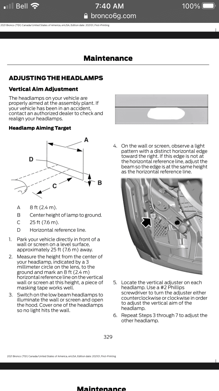

You probably need to adjust the beam like Scotty said.
following these instructions seems to be a waste of time, unless you replaced / moved the headlights after the factory alignment.
Step #2 measures the center point of your headlight to get the height of the 'target' line.
If I lift my Bronco to where the headlight center point is 10ft in the air, following the instructions you'll mark your target at 10ft.
I'm guessing that's not what people are recommending here.
With the at least 3 different heights of the Bronco (base, badlands, sasquatch), I find it interesting that Ford doesn't adjust the angle of the beam relative to the height of the headlights from the ground.
Instead, the angle of the beam is constant no matter the height of the headlights (including my exaggerated 10ft example).
Edit:
It could be they were misaligned from the factory. This procedure would tell you that. 🤷‍♂️
