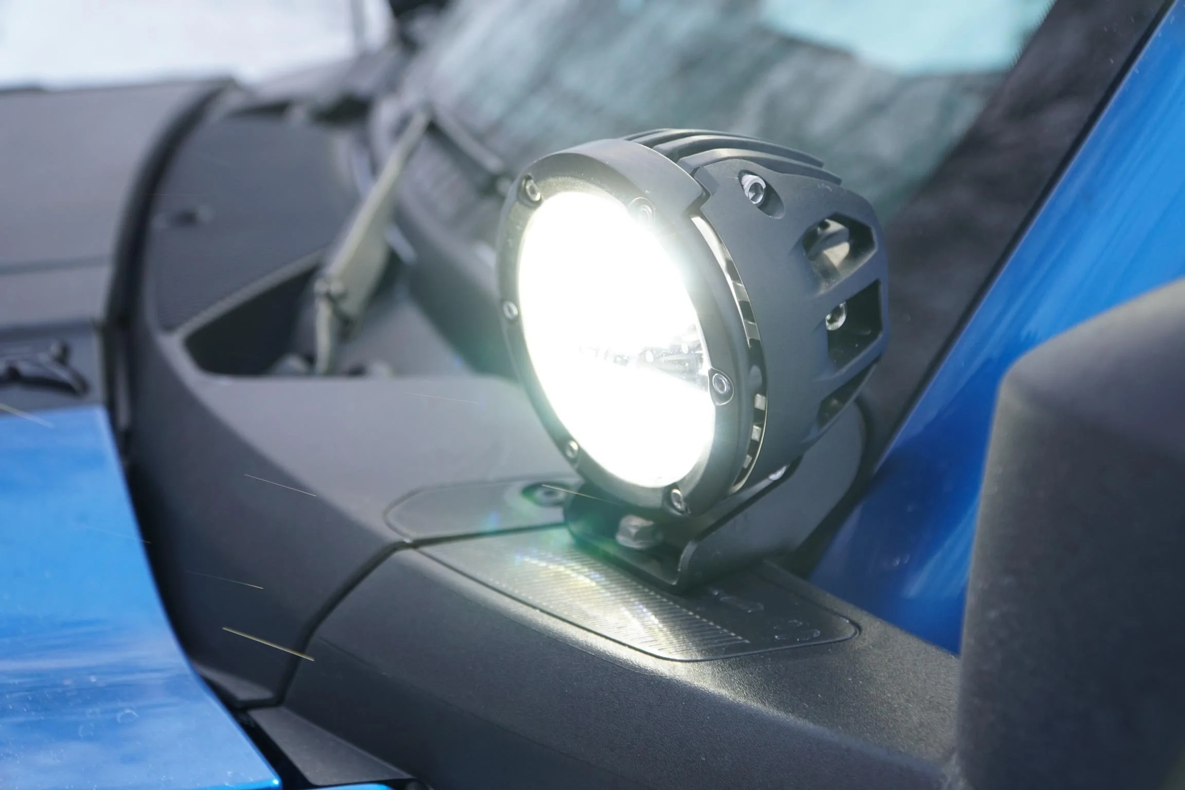

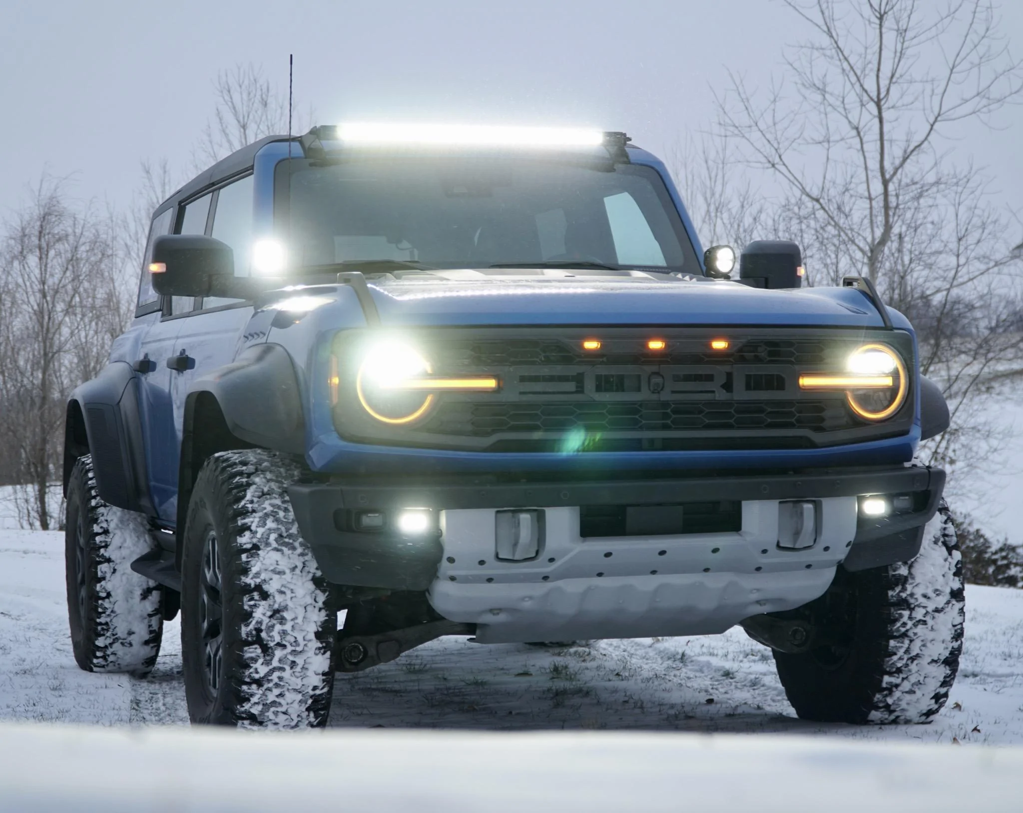

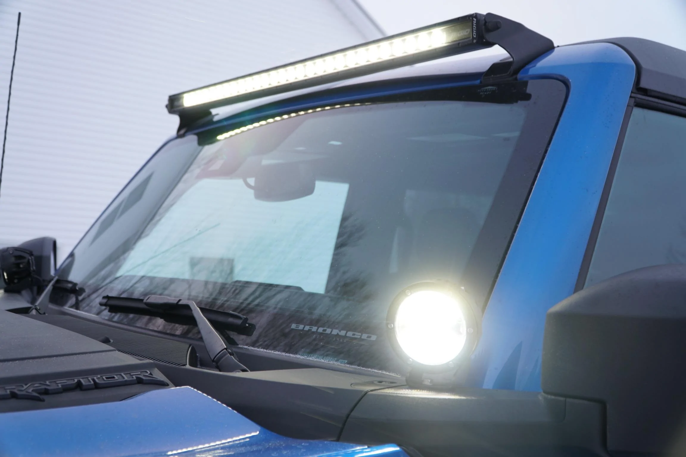

Installed the Ford Performance RIGID light bar and ditch lights on Bronco Raptor. It’s incredible how much of a difference the lighting makes. Regular headlights are like candle light in comparison.
AUX-1: Factory RIGID Fog Lights
AUX-2: Ford Performance RIGID Ditch Lights
AUX-3: Ford Performance RIGID Light Bar
Video clip shows lights activated (In order 1, 2, & 3) on a backroad with no traffic.

Two fog lights are controlled by the dial while the other two fogs are controlled by AUX-1.

The glare from the light bar was harsh. I assume that was because of the snow? or is some of the light "spilling" down from the light bar onto the windshield? I was thinking about the bumper mounted light bar because of this concern (and the additional wind noise).
Just based on the 3 second video, the roof bar looks like it's aimed a little low, which might explain some of the light spilling down on the hood.

Yes, 3 AUX switches total. Aux-1 is the extra set of fogs.

The light bar was already adjusted upwards once. It probably could go up a little more.

That controls the second set of lights that come from the factory wired that way.
Raptor upfitter switch are different than the rest of the Bronco's.
1=10 amp
2=15 amp
3=30 amp
4=10 amp
5=10 amp
6=10amp.
1 is the off road lights from the factory
