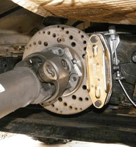

Hear that aftermarket? Bronco needs an easier to find and engage eBrake switch.
I'd like a tcase mounted e-brake with proper right hand lever mounted in some fashion, to allow for control of brake application (not just on/off). These sort of kits are made for some other vehicles:
