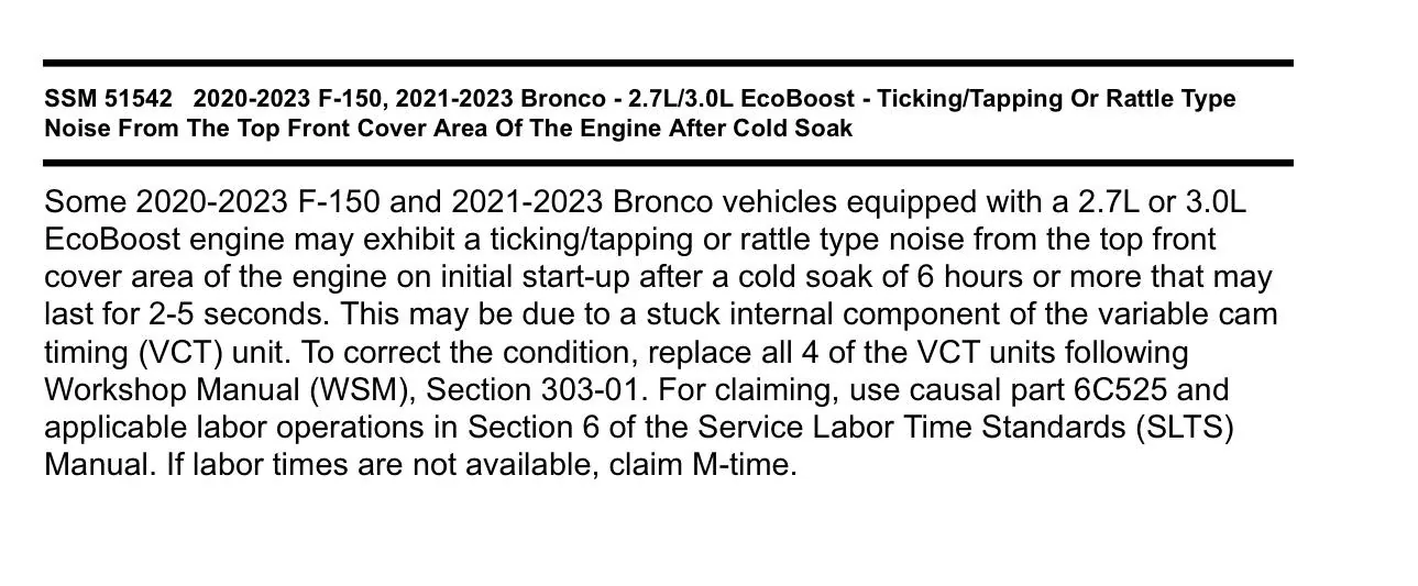

Sorry to hear. Did they say what the service bulletin says?
Ranger345
Donnie
109
152
Gretna,ne
Yes it's specific to the cam phaser and I guess there is a new part number with the updated phasers

From those that have had it done did they pull your engine?
Yes , and service manual actually states engine removal for it. I posted full notes of what's done when they pull engine a couple pages back if you want to reference how much is being taken apart.
