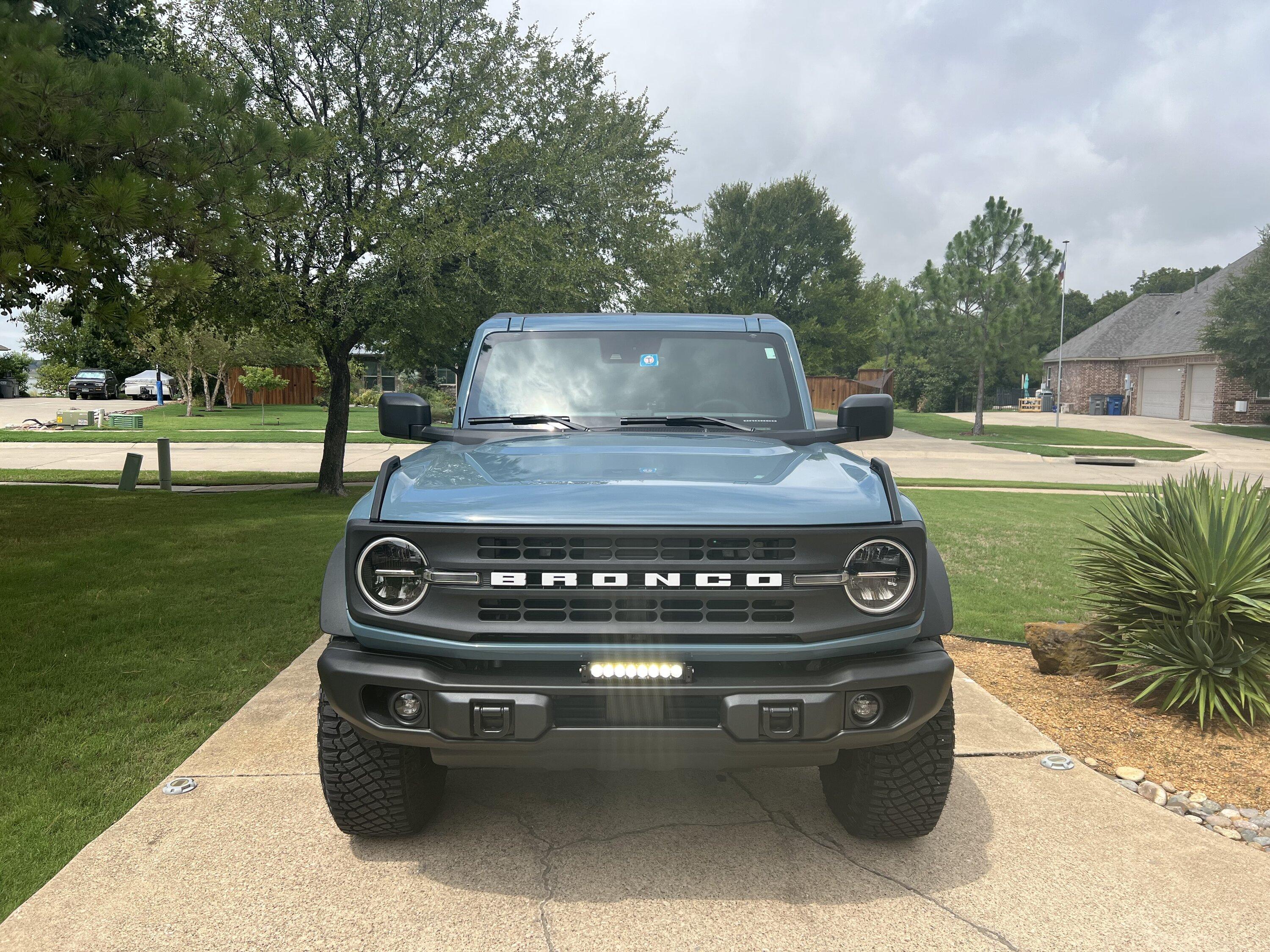

I just drilled into bumper to add this Baja Design 10" S8. It throws a lot of light and I was able to push it back far enough where it sits behind the bumper a bit.
Ford Bronco Capable Bumper - Light bar? light
I just spray painted these black and used self tapping screws ($5):
https://www.homedepot.com/p/Everbilt-2-in-Zinc-Plated-Heavy-Duty-Corner-Brace-2-Pack-15442/202034088
There is probably a better solution but so far this is working great.

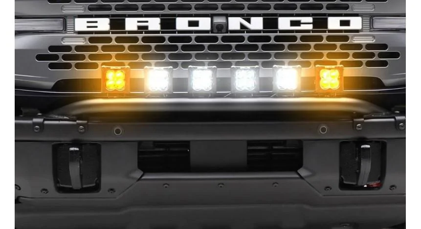

Not exactly like that, but I found this not too long ago: https://mandronline.com/products/copy-of-2022-ford-bronco-capable-bumper-40in-light-bar
Has options for white, amber, and white w/ amber DRL

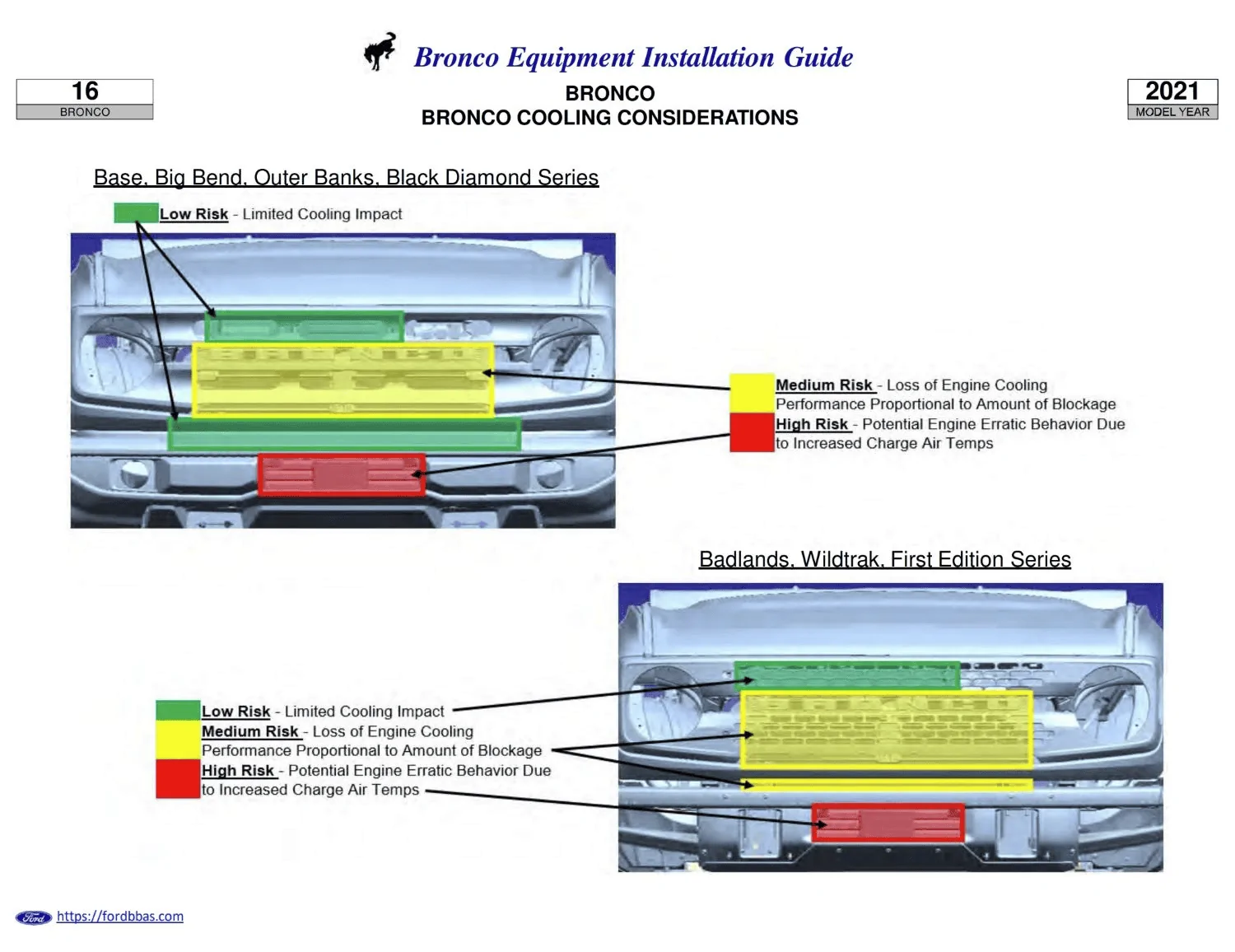

I do like the M&R bar and I think it fits nicely, but I decided I didn't want to block the "medium risk" area shown in the bottom diagram. Should be fine on a Base, Big Bend, Outer Banks, or Black Diamond though, since they all have bigger grill openings.
Of course, any bumper-mounted light bar is going to block some of the yellow area on the Badlands/Wildtrak/First, and the M&R bar is probably the smallest option. Personal preference on whether you're comfortable with it! I'm looking at other options, maybe fog lights, ditch lights, or a windshield light bar.
Ford Bronco Capable Bumper - Light bar? 1665586221379
Thanks for the diagram! I had not seen this one and I now understand why some folks were skeptical of mounting a winch in this same spot. Unfortunately, it's about my only option for one with the capable bumper
