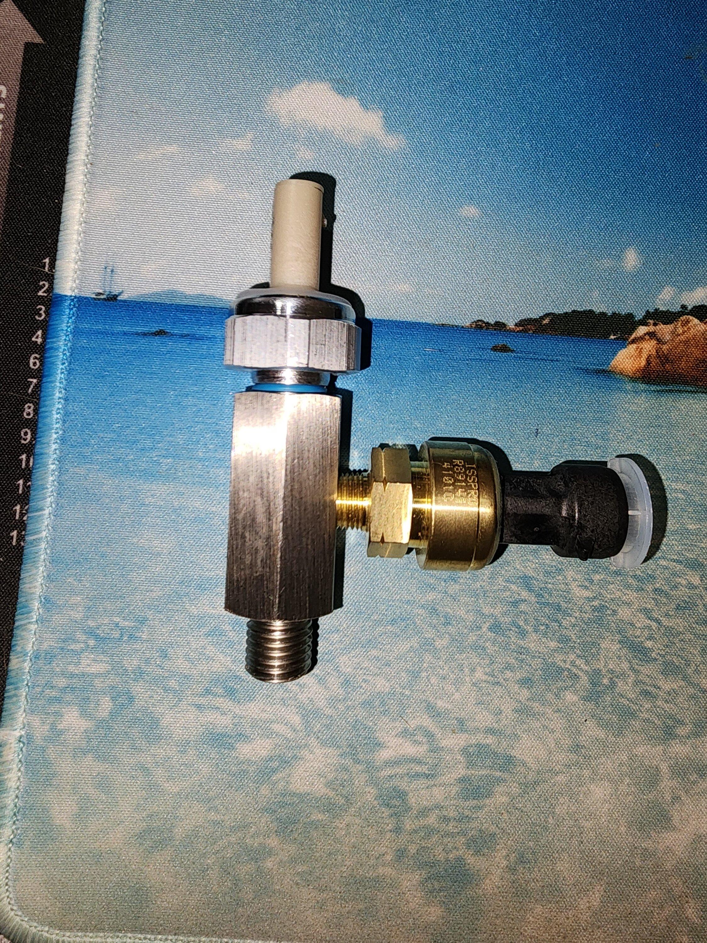

@PWillette - getting closer. Have both sending units now. OEM uses an o-ring so I will need to see if the OEM opening in the block is machined in any special way versus the adapter.
The OEM sending unit does have a flat shoulder so I could use a copper or aluminum gasket to seal if the o-ring presents a problem.

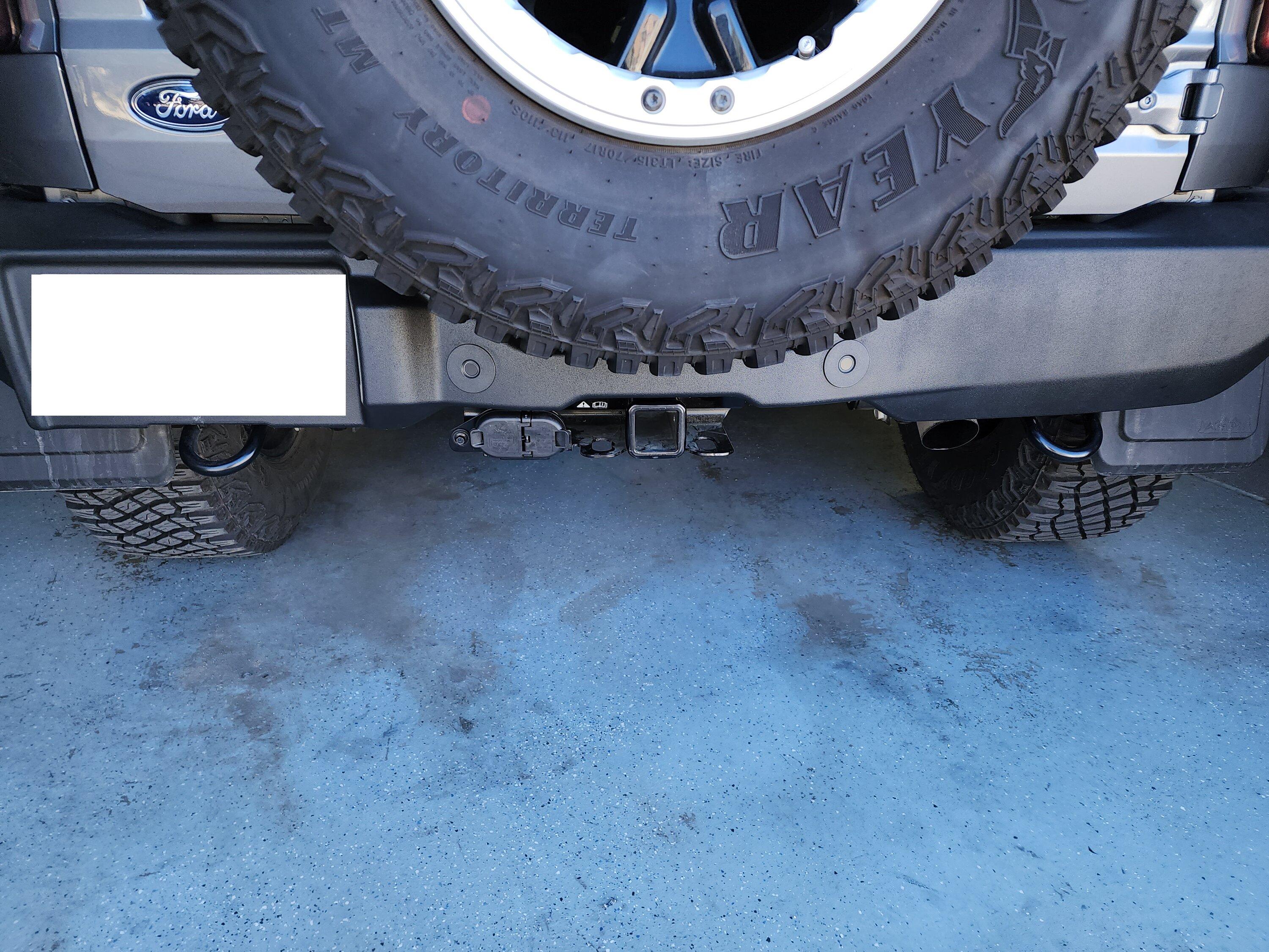

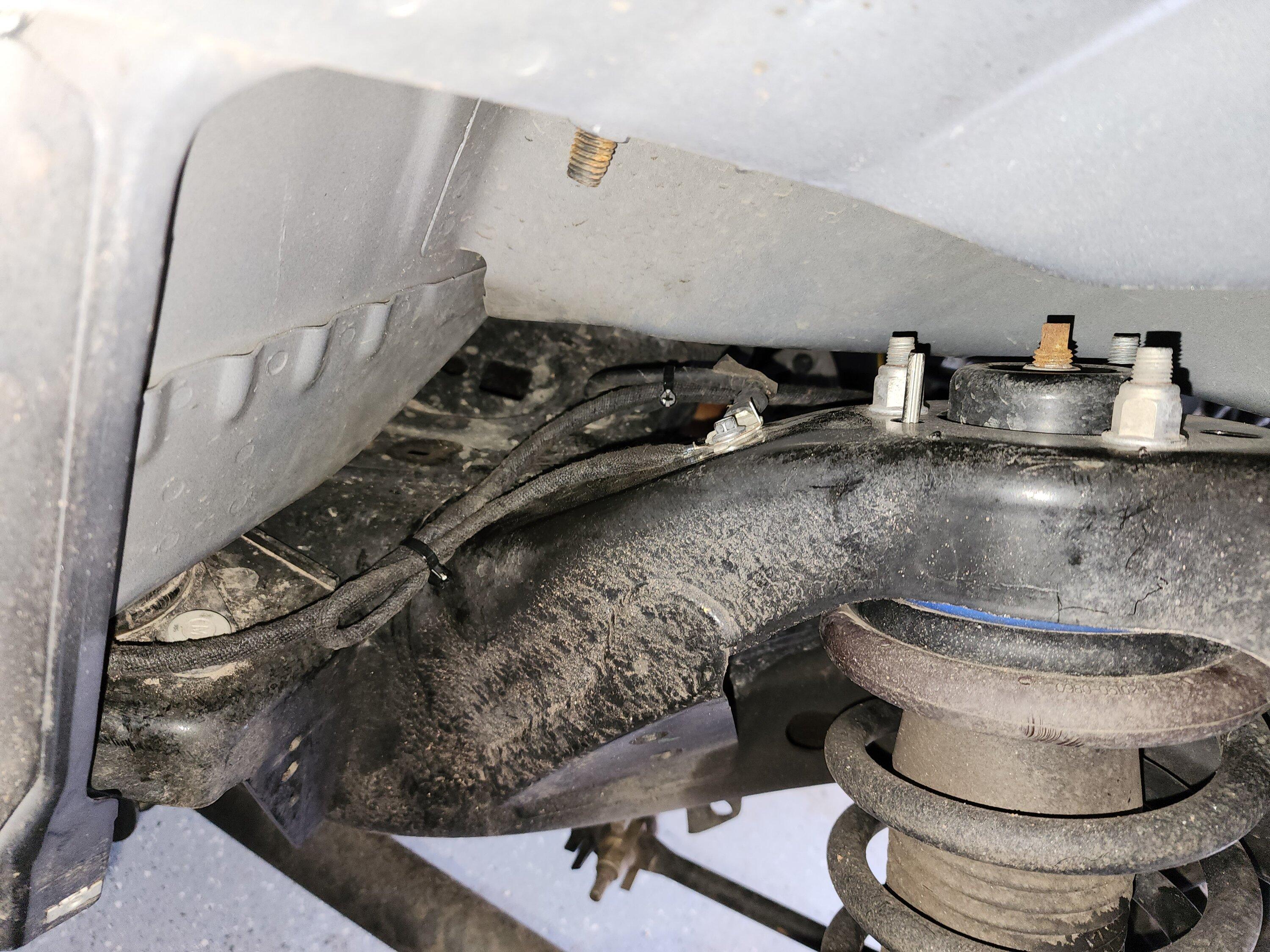

Added the Ford hitch and the Ford Accessories (Lumen) 4/7 pin connector and wiring harness. It was fairly straight forward and @Mr Toad's videos were a big help. The connectors were a serious PITA more from orienting the wires into them in the correct way versus anything else. This document will be a great resource as well - Lumen Trailer Tow Harness Installation Instructions.
A few deviations--I wrapped the entire harness with another layer of harness electrical tape for additional protection and I tossed the zip ties that were provided and used metal tab locking zip ties to ensure they would not loosen.

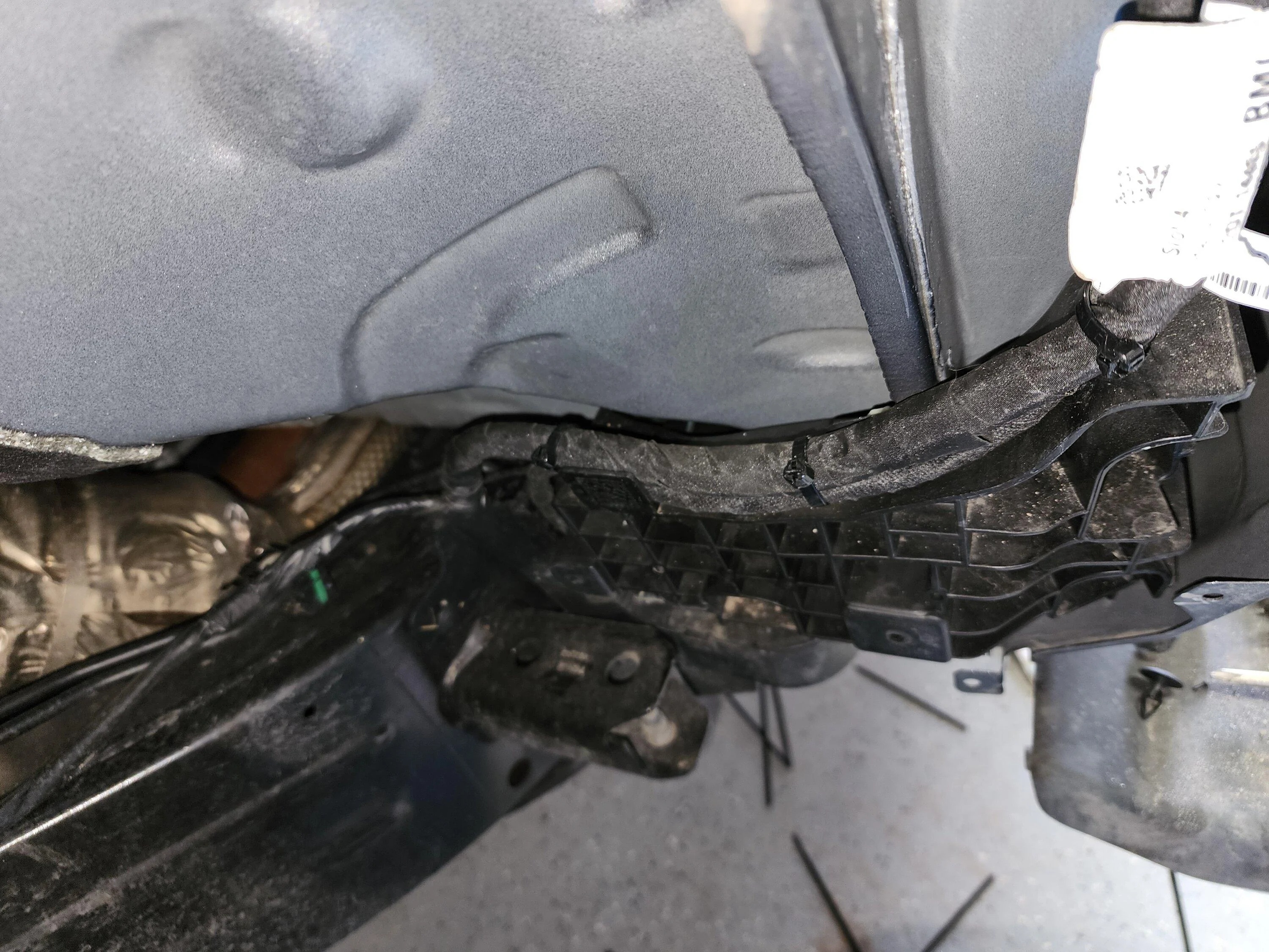

I had to remove both driver's side fender well liners (front and rear), there is no way that I could have routed the wiring, connected the ground at the rear wheel well and added all of the wiring to the two main connectors without doing that. I did have one casualty which was one of the fender flare locks lost one of its ears:
Ford Bronco CarbonSteel's Journal 20240303_140536
I had planned for that and bought some spares. I also bought more of the fender liner plastic screws from Amazon and they are better than the OEM.
I did not remove the wheels and I think it is fine to leave them in place. Otherwise, the module installation was simple and there is no need to remove interior side panel, you can move it to the side and gain enough clearance. I did use my own mounting nuts (6mm x 1.0 serrated flange nuts) versus the garbage that Ford supplies.
While I have the rear bumper off (I have seen that you do not have to remove the bumper to install the hitch and that is not possible given the length of the hitch bolts), I plan to run the stainless flex hose for the rear air compressor mount and the wiring for the rear axle temperature sensor.
One issue that I had is the right rear parking sensor connector would not fully engage (though I thought that it did) and so I had a parking sensor error when I started it back up. A little WD-40 in the connector solved it.

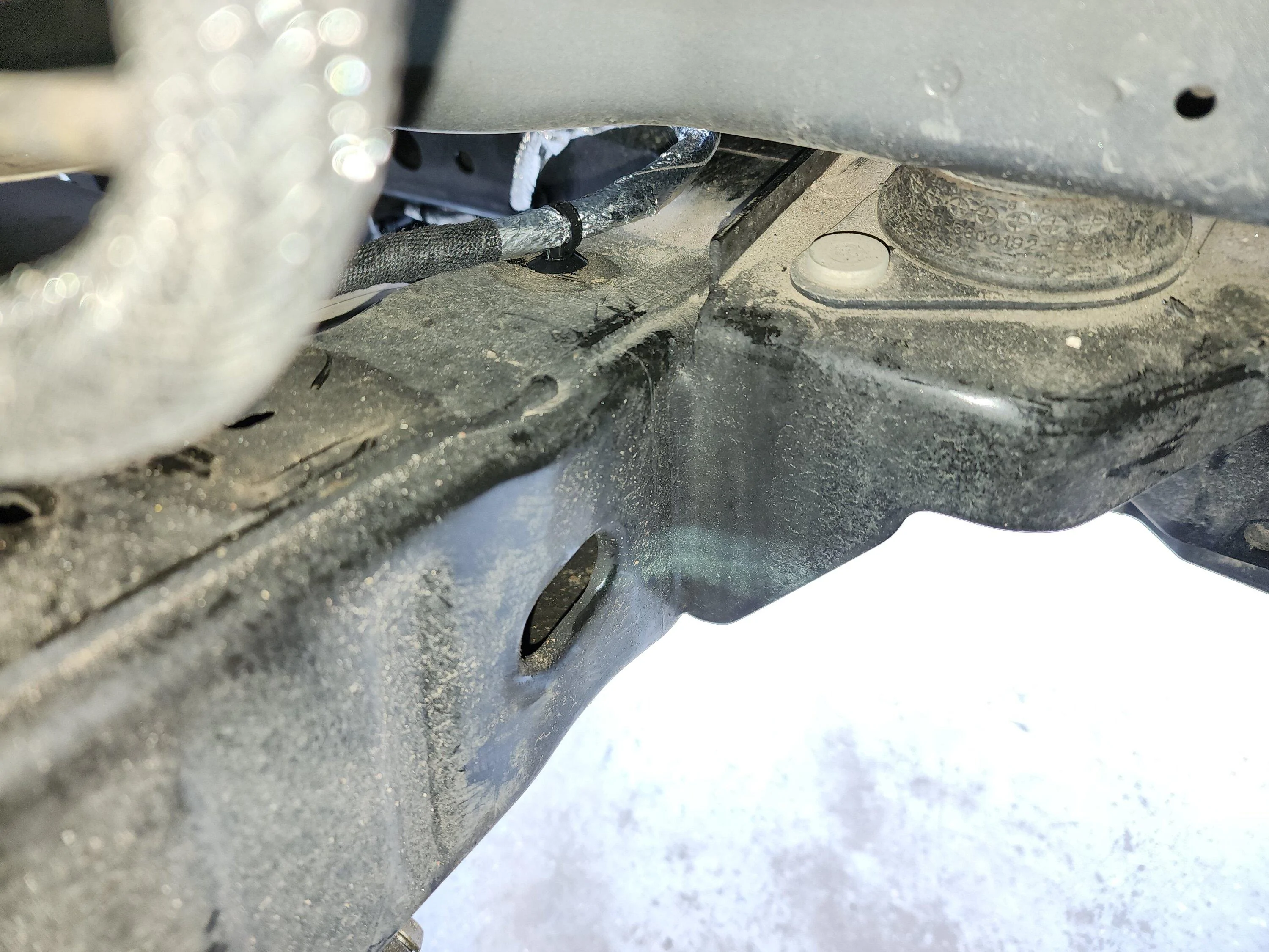

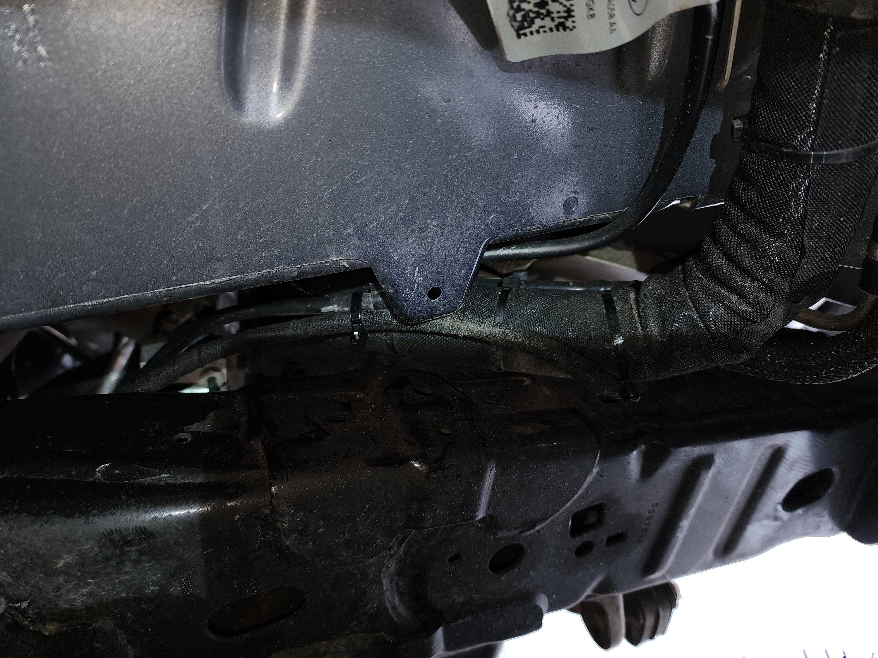

A few photos:

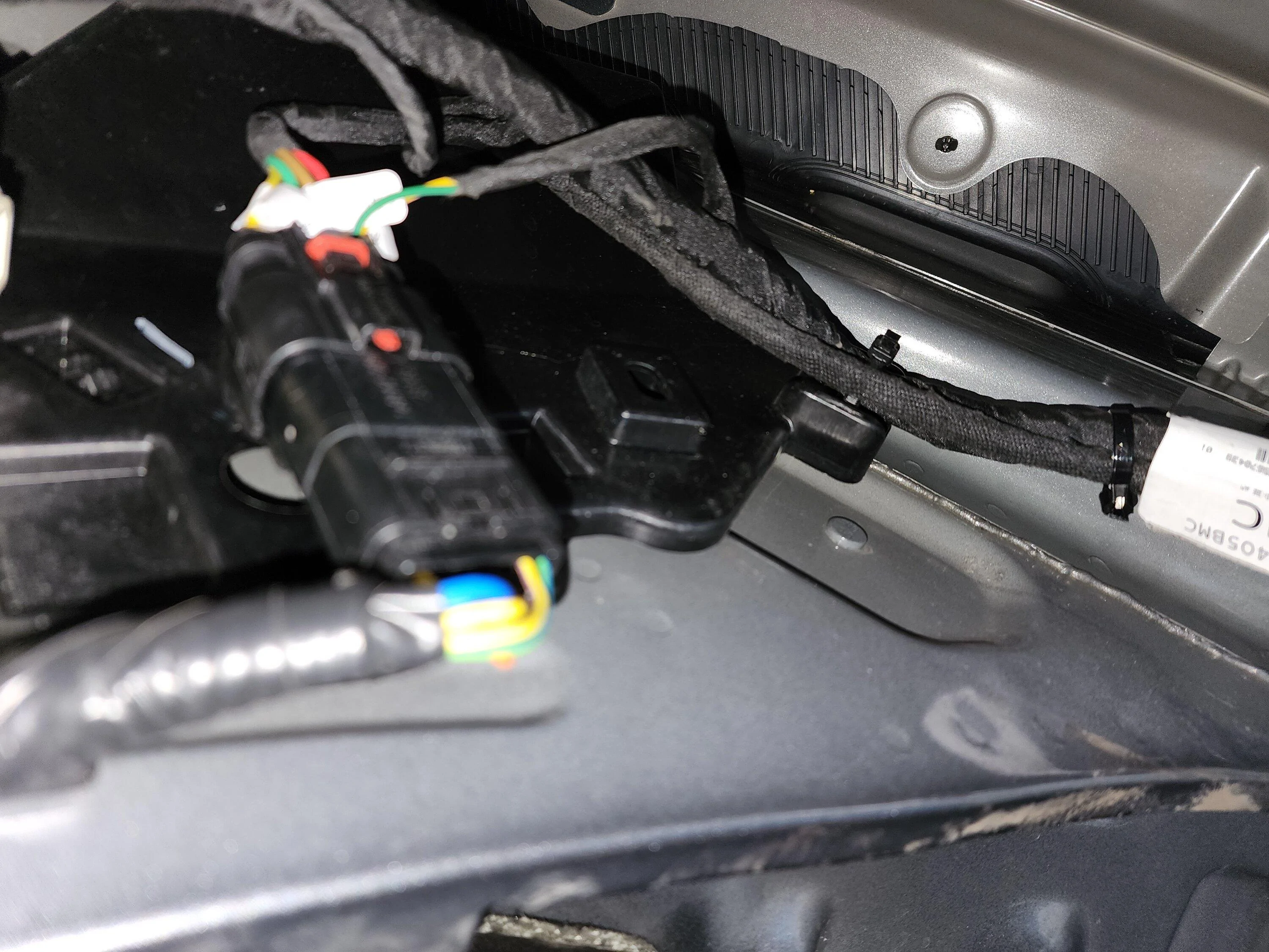

From the back of the 7 pin connector:
Ford Bronco CarbonSteel's Journal 20240303_113529

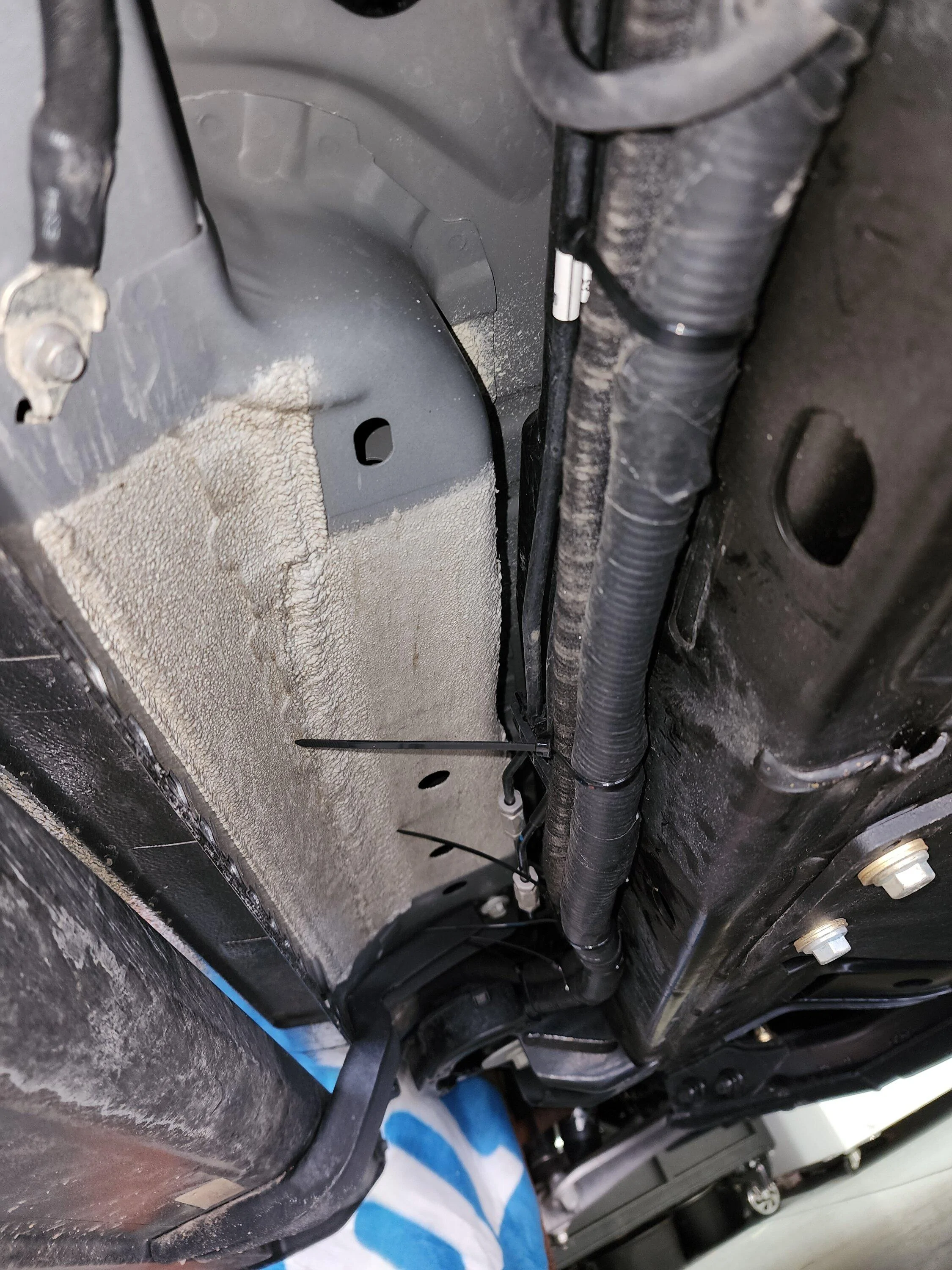

Passing by the fuel filler lines:
Ford Bronco CarbonSteel's Journal 20240303_113522
Ground connection:
Ford Bronco CarbonSteel's Journal 20240303_113516

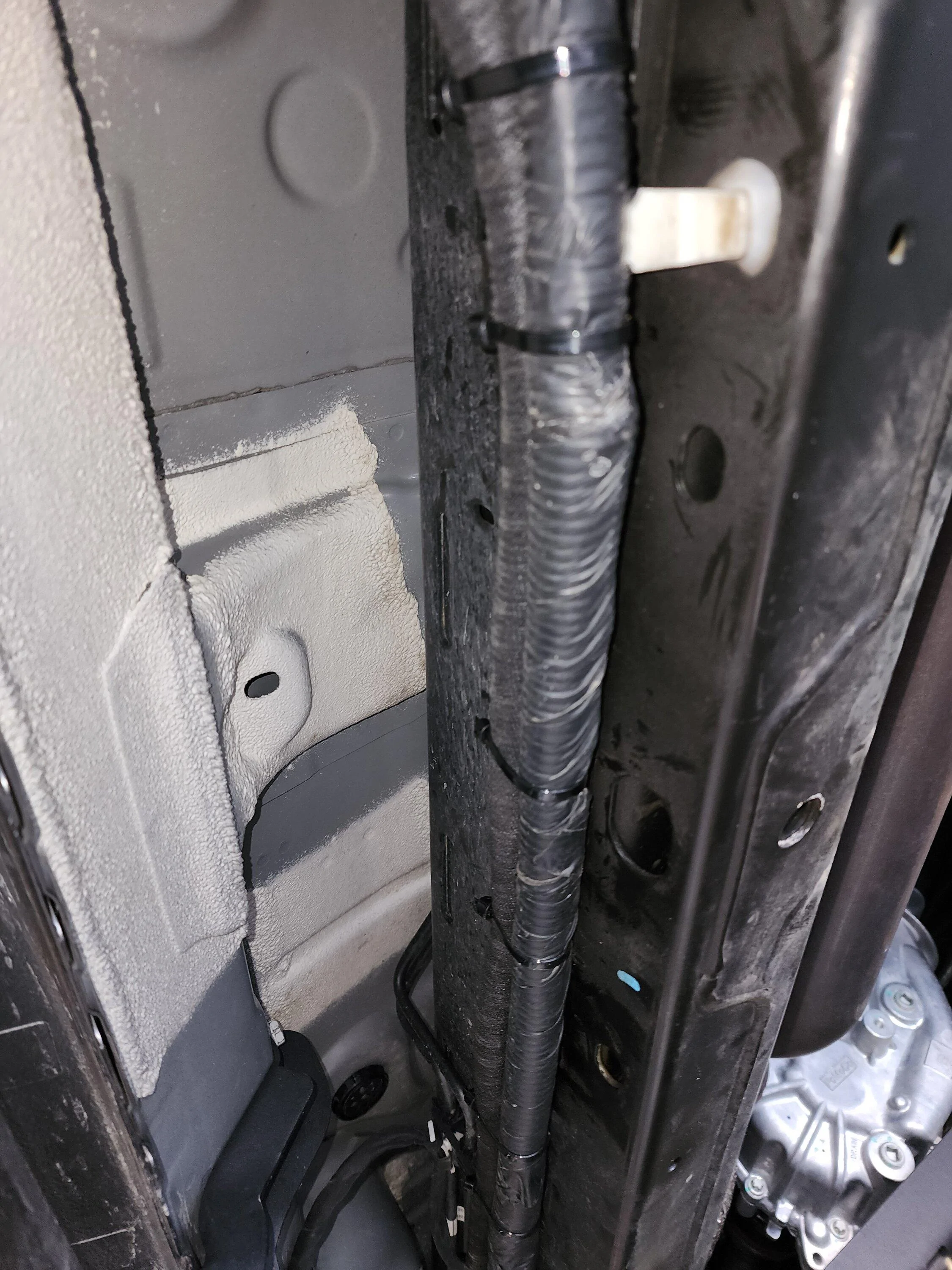

Headed towards the front:
Ford Bronco CarbonSteel's Journal 20240303_113900
Ford Bronco CarbonSteel's Journal 20240303_113904

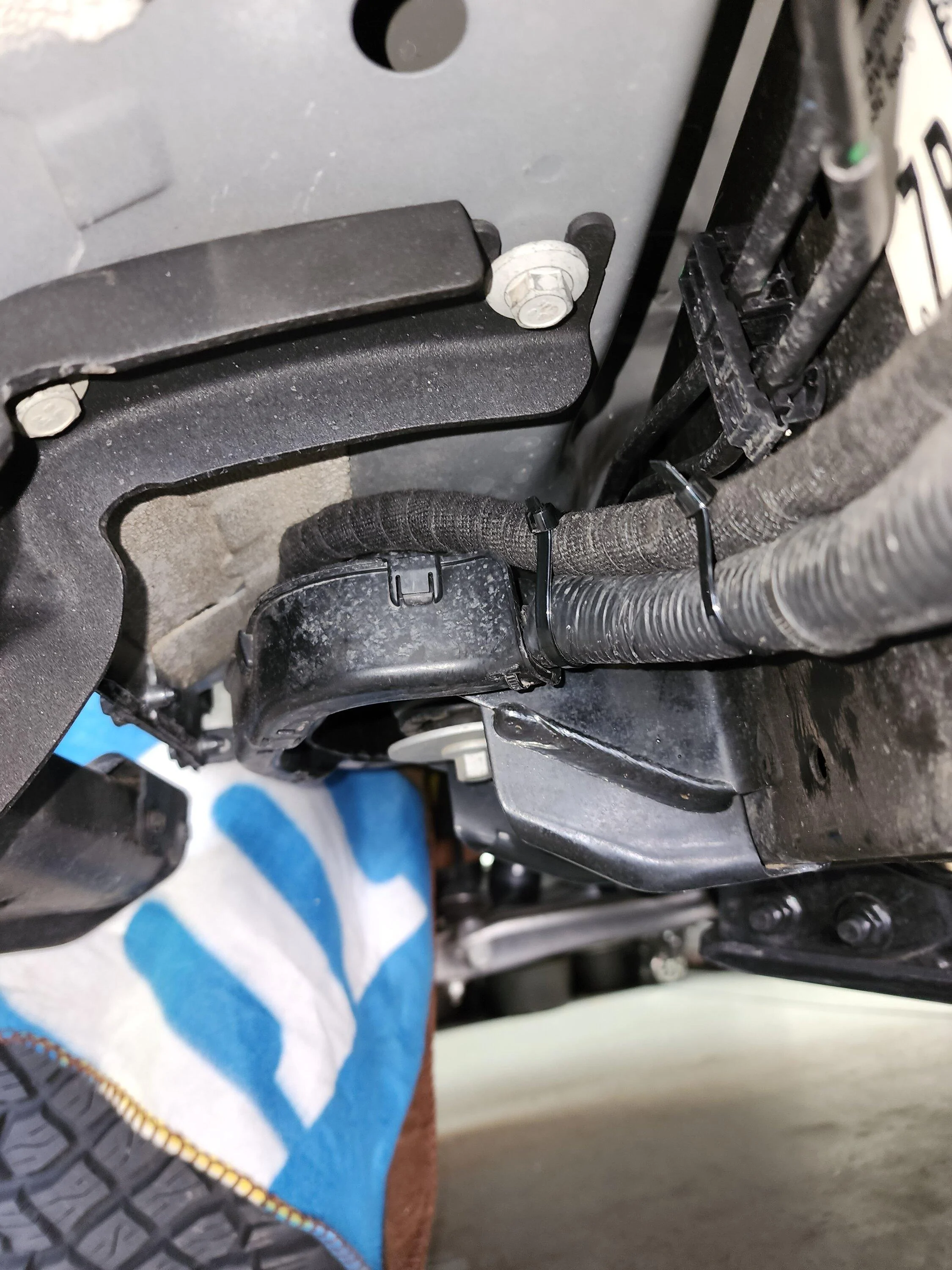

At the front body mount:
Ford Bronco CarbonSteel's Journal 20240303_113947
Routed inside the front fenderwell:
Ford Bronco CarbonSteel's Journal 20240303_114009
Connectors inside the front fender:
Ford Bronco CarbonSteel's Journal 20240303_114016
All complete:
Ford Bronco CarbonSteel's Journal 20240303_140223

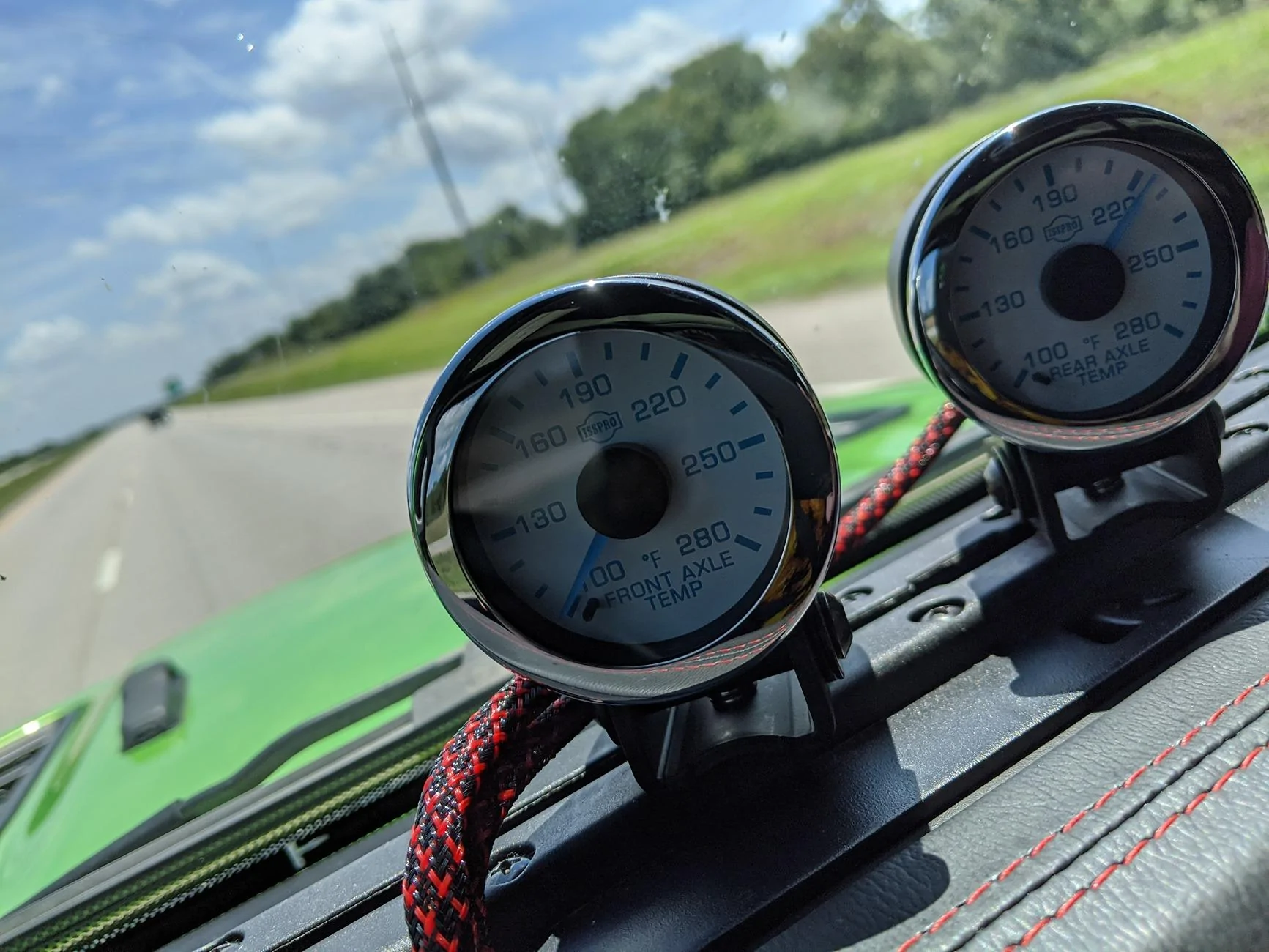

Here is a prime example. This is my (now retired) 2019 Rubicon running down the highway, unloaded at 75MPH at 95°F ambient temperatures. I saw upwards of 250°F at times and the primary reason that I run 75W-140 gear oil in my axles. I am in the process of adding a temperature gauge for the rear axle in my Bronco.
Ford Bronco CarbonSteel's Journal IMG_20200808_123245

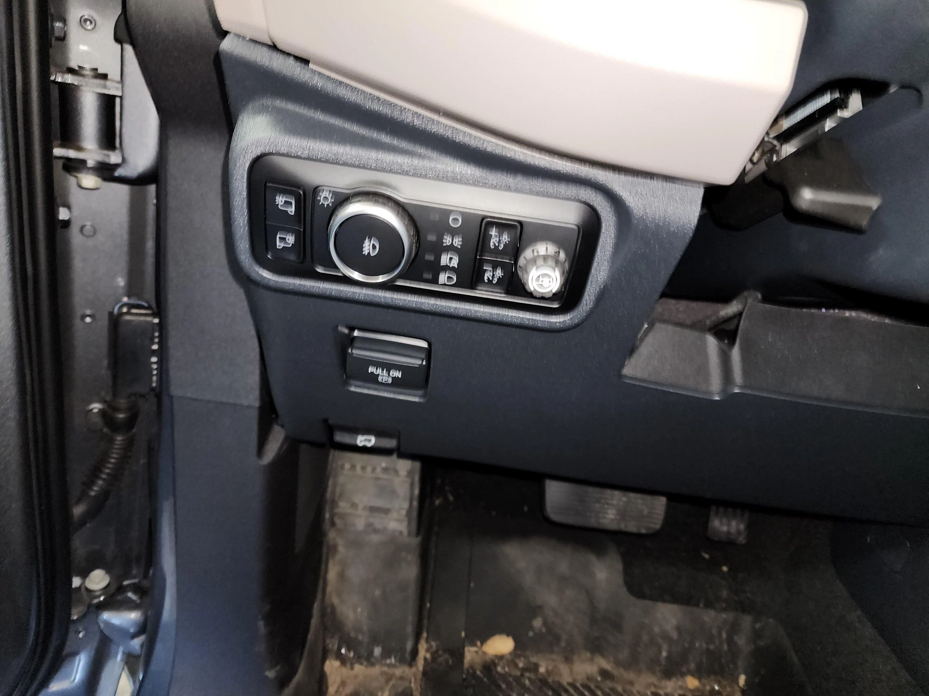

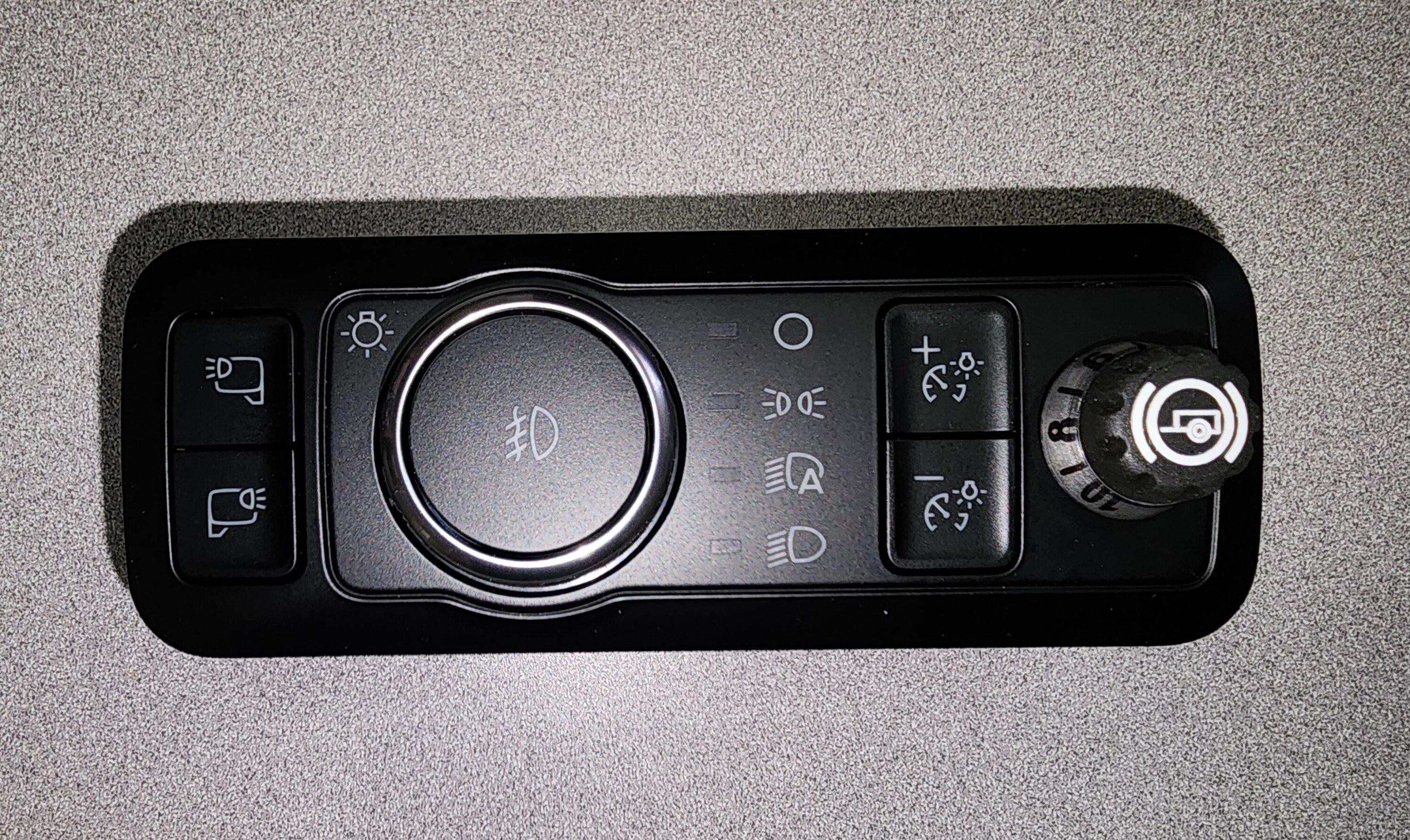

Just a few steps left to install the trailer brake controller followed by some Forscan work and the 7/4 pin trailer wiring, trailer hitch, and trailer brake controller project will be complete!
No way was I going to drill a hole in the console and do all of the work to route the wiring to it. It would be in the way and stick out like a sore thumb there...

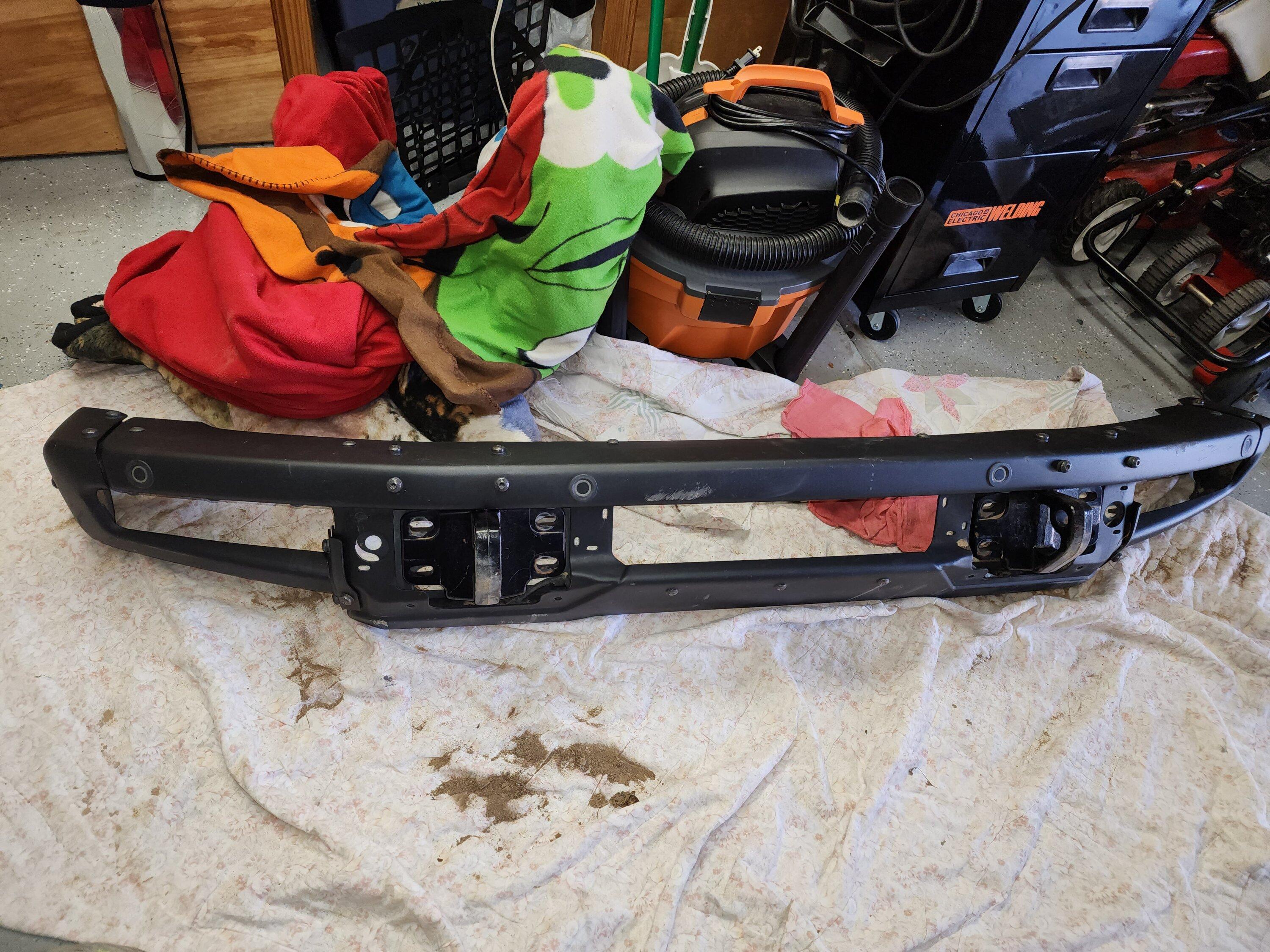

Made a run down to New Mexico and grabbed a modular bumper for $200. Has a few scratches, but nothing some paint won't fix and it included the sensors.

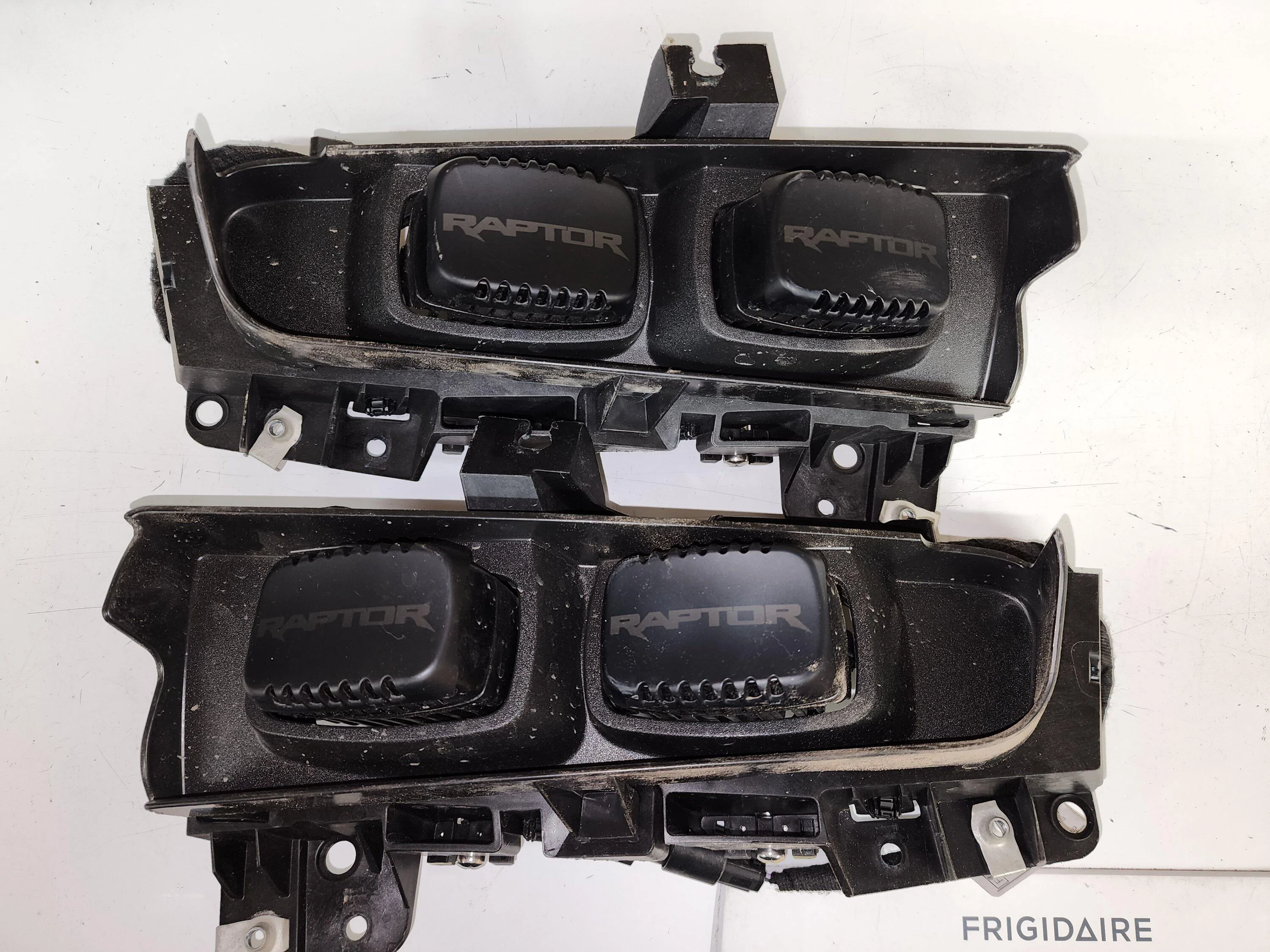

Picked up a set of BRaptor driving/fog lights for $150 locally that included the covers.
Ford Bronco CarbonSteel's Journal 20240310_145413
Just need to follow @2door+ @flip's post on how to install the lights and I'll be on the way.

And just like that, the mechanical part of the trailer towing wiring, hitch, and brake controller work is complete!
