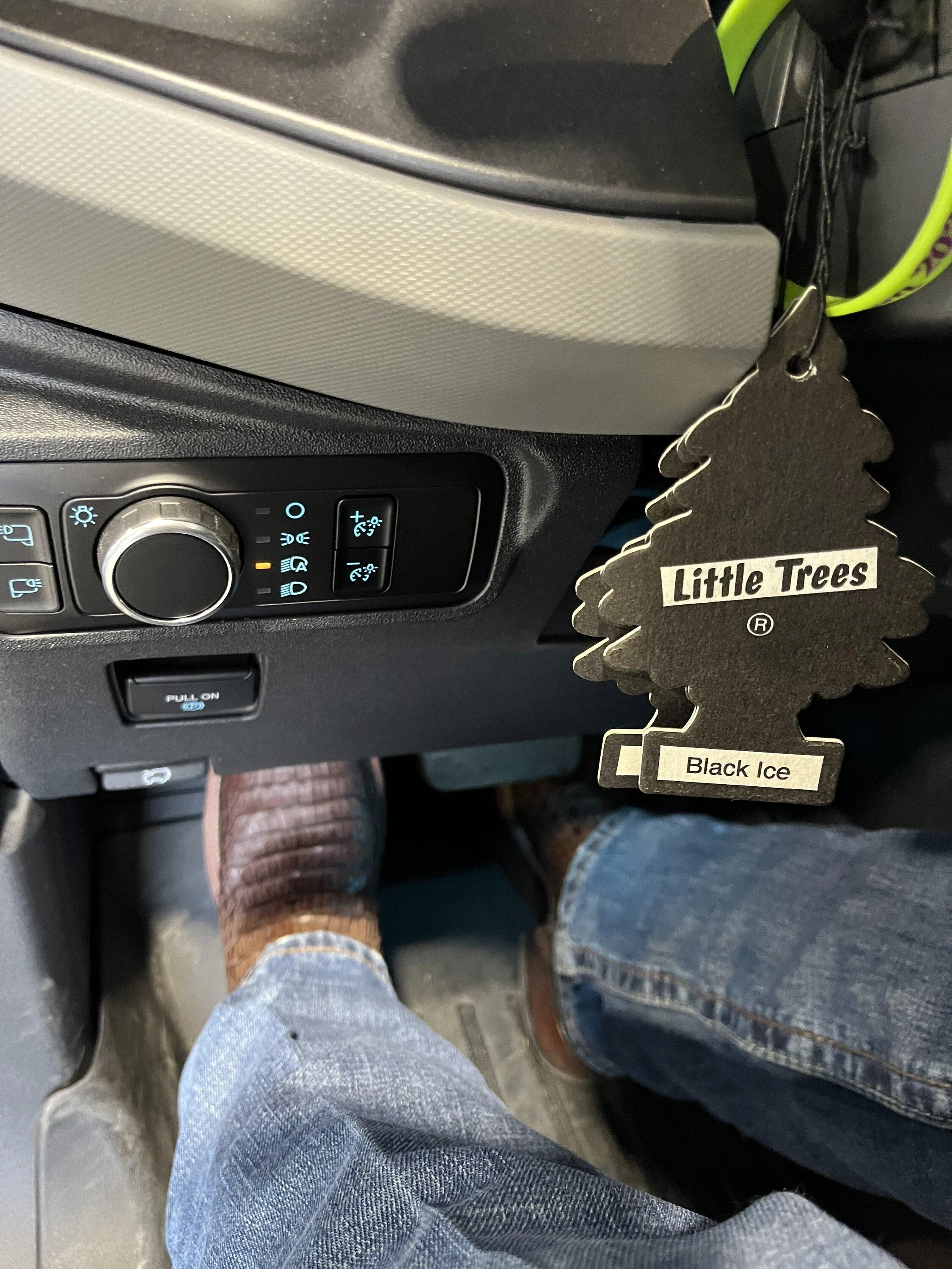

I can't figure out why people put air fresheners in their car, especially one two weeks old :unsure:. They don't get rid of orders, they just mix and make it worse (in my opinion). Never use harsh chemicals inside your car, even the ones made for cars. A damp cloth is all that's needed, and if you must use more just use a mild dish soap. I learned this the hard way when cleaning adhesive residue from the dash of my daughters Toyota. Its not just Bronco!

Chemistry lesson for anyone who is interested.
A broad class of chemicals called Terpenes are probably what caused the damage. A naturally occurring chemical that every plant creates - some plants more than others. They are part of what create the scents of Pine and Citrus fruits. They are very common in air fresheners that contain pine (Pinene) or citrus (d-Limonene) scents. Also common in some cleaning products like Pine-Sol, or Orange-Glo. They are also the dank smell of Cannabis and in a lot of your "essential oils'... Remember they are "Natural".... LOL Just not at the levels that we process them into via chemical extractions to have enough to use to make all the above.
Back in the 90s they were all the rage trying to replace cleaning solvents and CFC especially in the metal treatment industry. Plating, Powder coating, etc. Main problem with them is that they would leave a residue behind which would affect paint adhesion etc. They are good at dissolving Oils and Greases especially the Citrus based ones.
As a result of their solvent properties they like to attack some plastics. I don't know exactly what sort of plastic our interiors are made of but, d-Limonene for instance doesn't play well with polyethylene, polypropylene, natural rubber, nitrile, neoprene or Tygon.

It doesn't actually "melt" the plastics. Well... I guess it does, but it's a chemical reaction that causes it.
Air fresheners are nasty and contain (often volatile) compounds that are designed to evaporate/disperse quickly. That evaporation is what spreads the scent around the vehicle... but the compounds trigger a chemical reaction with certain plastics. This is especially true in the summer because the heat and sunlight increases the rate of the chemical reaction.
This is why many of the hanging air fresheners (like the little trees) recommend that you... well... hang the air freshener in a way so that it doesn't come in direct contact with any plastics/vinyl/etc.
Also... random pro-tip: The Black Ice air freshener is BY FAR the most abhorrent smell on the planet. I rather lather in dog poop than smell Black Ice... it's a near-instant puke trigger for me. So if for whatever reason you want me to go away and ensure I'll never come within 10 feet of your vehicle... Black Ice. :poop:
(Unfortunately for me, it pretty much instantly disqualifies me from ever riding in taxis/Ubers/Lyfts.)
LMAO! So funny you say this about the Black Ice. When I started writing service 20-someide years ago I would staple my business card to a black ice air freshener. Customers would forget my name but they would come back and ask for the "air freshener" or "Black Ice" guy. lol. To this day I still teach my young advisors to be "memorable". It worked! lol.
But yes, back to the OP... the chemicals react with the plastic and really jack some stuff up. It isn't just Ford but all manufactures before all the "Ford's interior is junk" starts.
