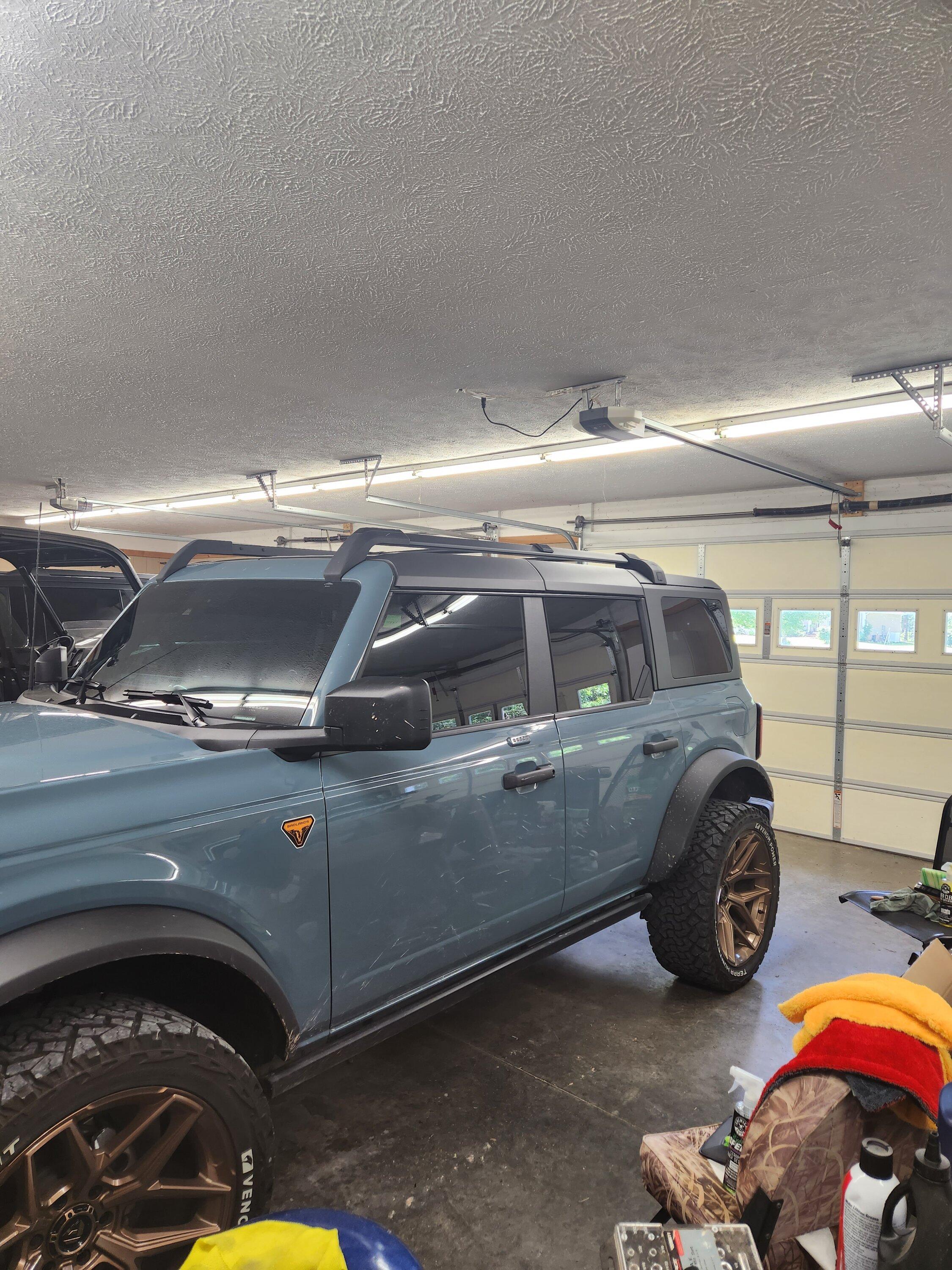

I have 15% on the fronts of mine with 20% over factory throughout the rear to balance the look with 50 over the windshield and a 15% brow strip....doesn't affect the auto high beams because that is in the box behind the rear view mirror...also mine seems clearer than any other tint I've used with no haze

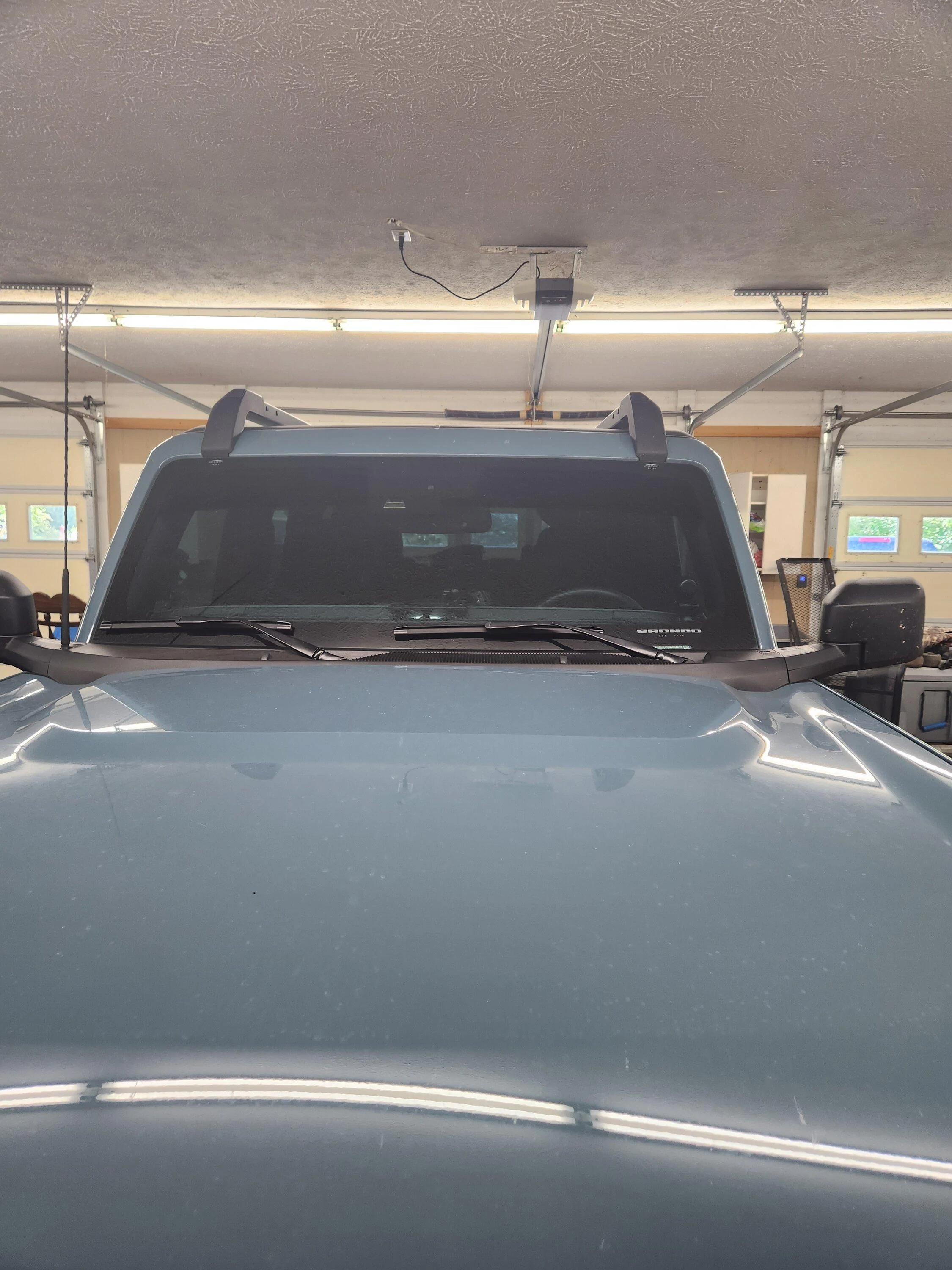

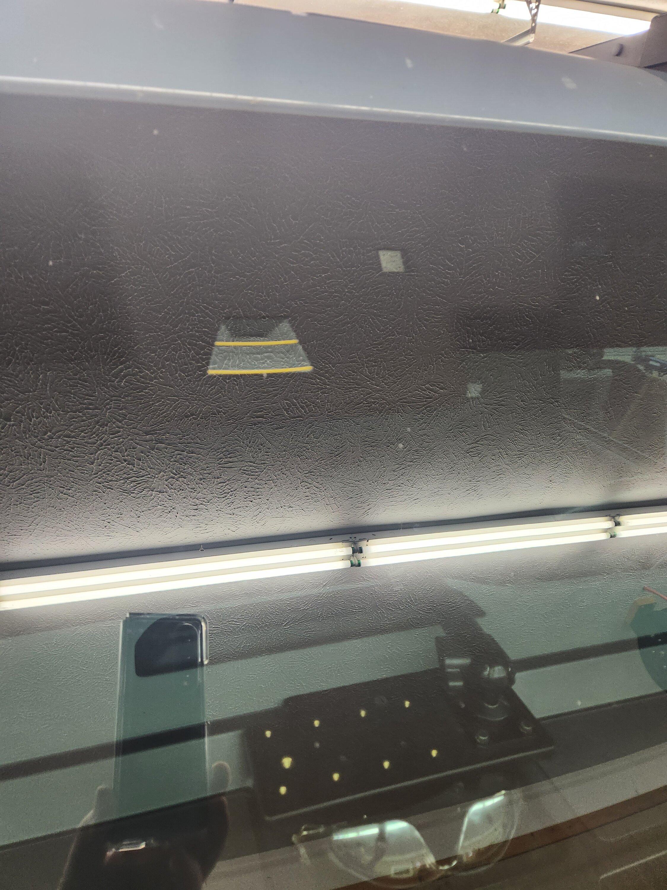

Also it is expel ceramic

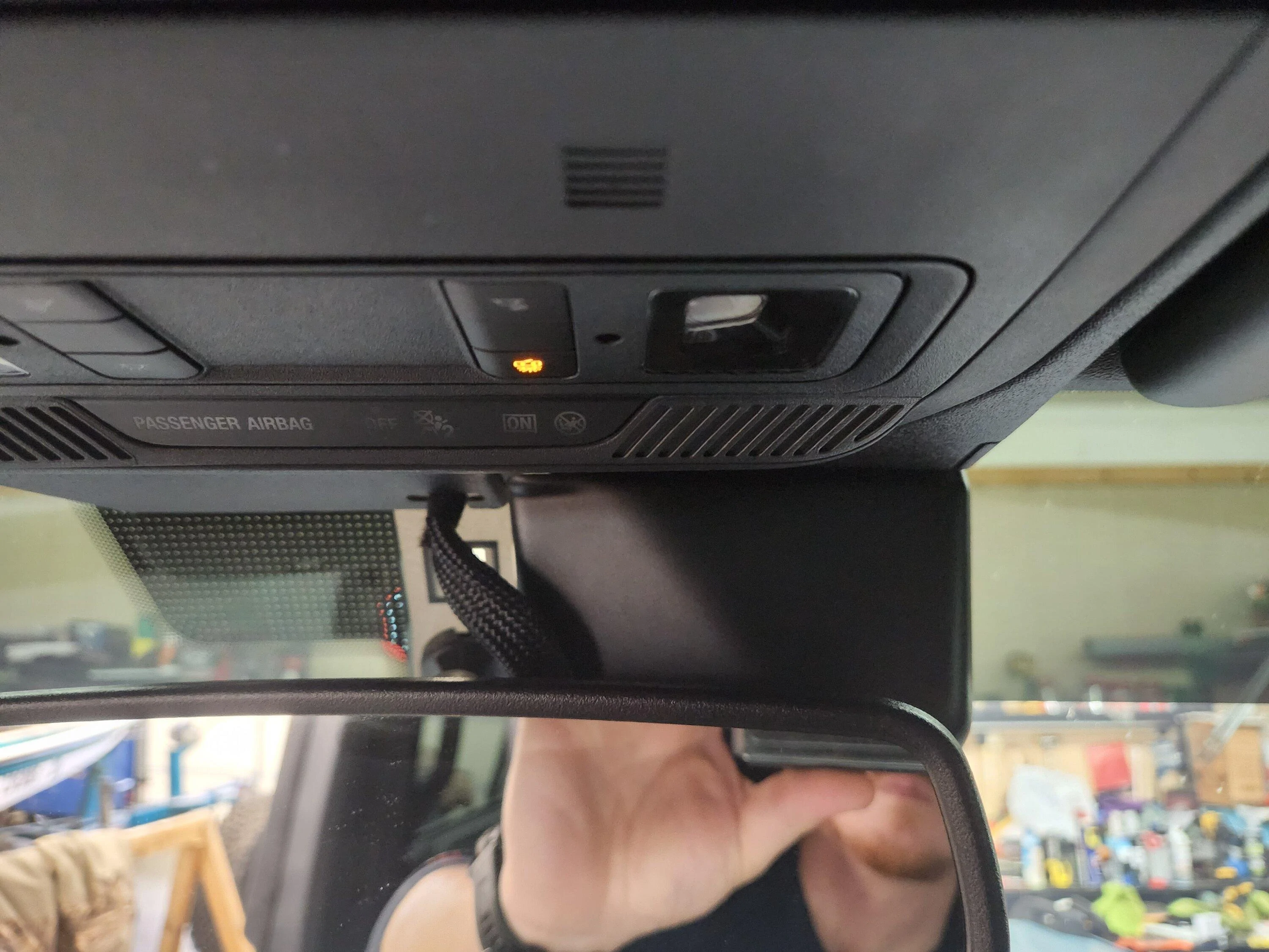

I have the mid package so I lack a few of the extra sensors but for the mid as far as I can tell as long as you don't block this sensor everything has been pretty well flawless

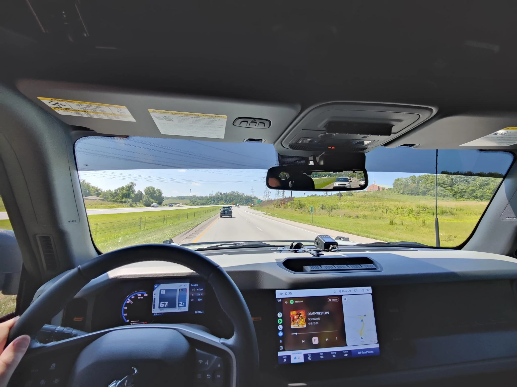

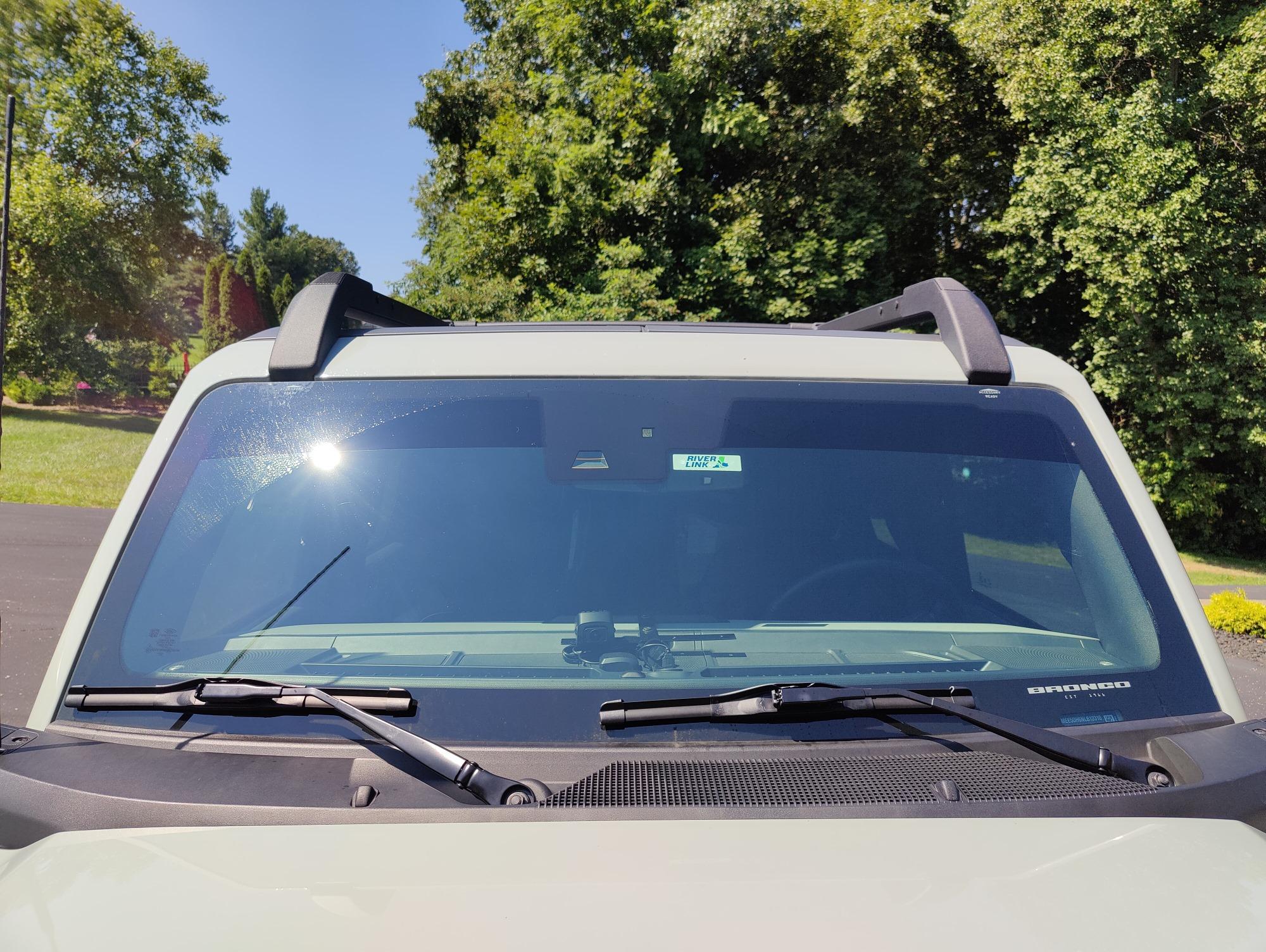

+1 on the brow. I was hesitant about a whole windshield tint as I've never had one before. I went 20% ceramic on the front windows and 5% brow. The brow is cut down to about half the height of the plotter template my tint guy had downloaded. I love it. Almost completely negates the sun visor. No issues with sensors.

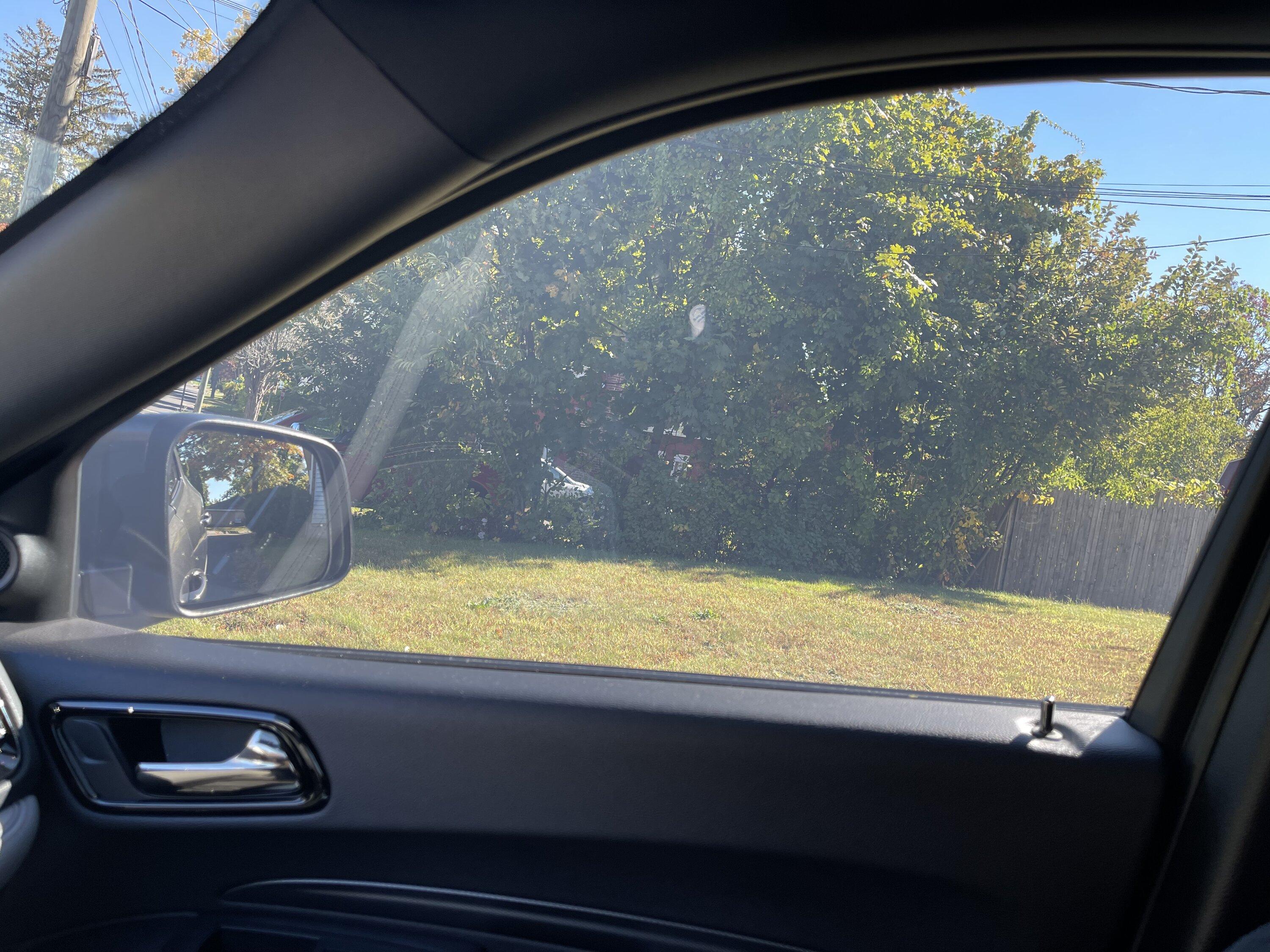

Yes it’s part of the normal drying process. (This is what I do for a living,) I do not use Xpel but a quality ceramic film does not have “low angle haze” as we call it. Xpel should not have the low angle haze. There are definitely other ceramic films (low quality) that definitely do have low angle haze. But not to worry yours should dry out.

Here is an example of low angle haze. This is 3M ceramic IR film …. Low quality film
