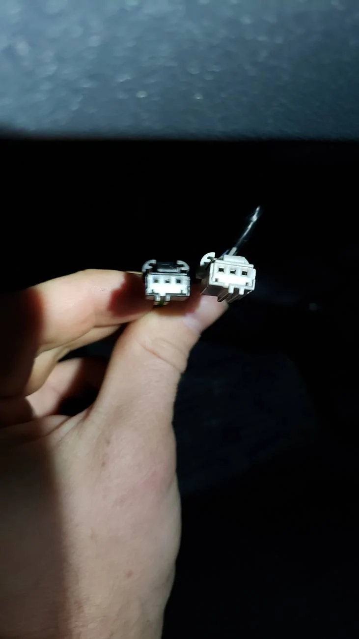

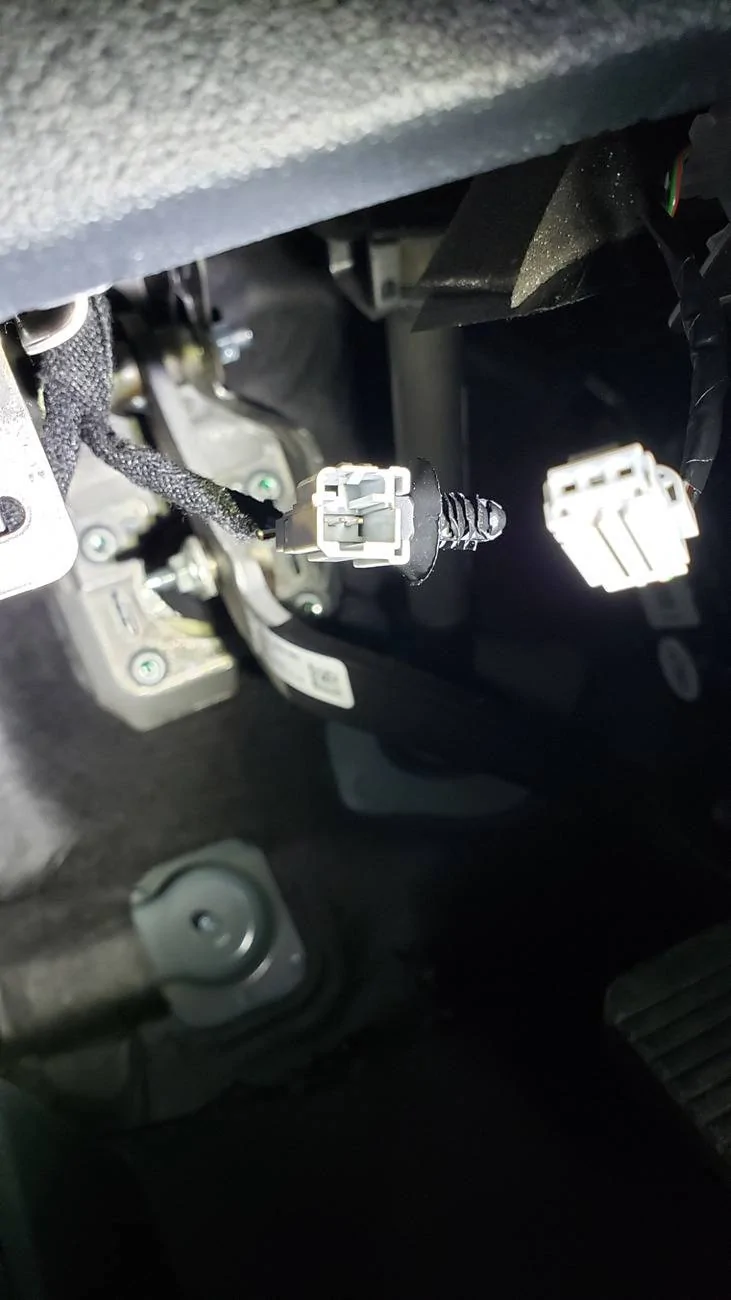

Just got around to adding the color change to my Bronco.
Bought 2x FL3Z-14A318-N and 2x FL3Z-14A318-L
I used the L's on the harness for the rear seats and the N's on the passenger side but the drivers side is the only one that had a different connector. Is there a different part I should have gotten?
Below is the drivers side connector and the comparison between the stock light (right) and the new light (Left).

No. You just need to swap the connectors. Remove the white front face and you will see where to push to pull the pin out. Pretty easy to do.
Yep that will do it. Thanks!
