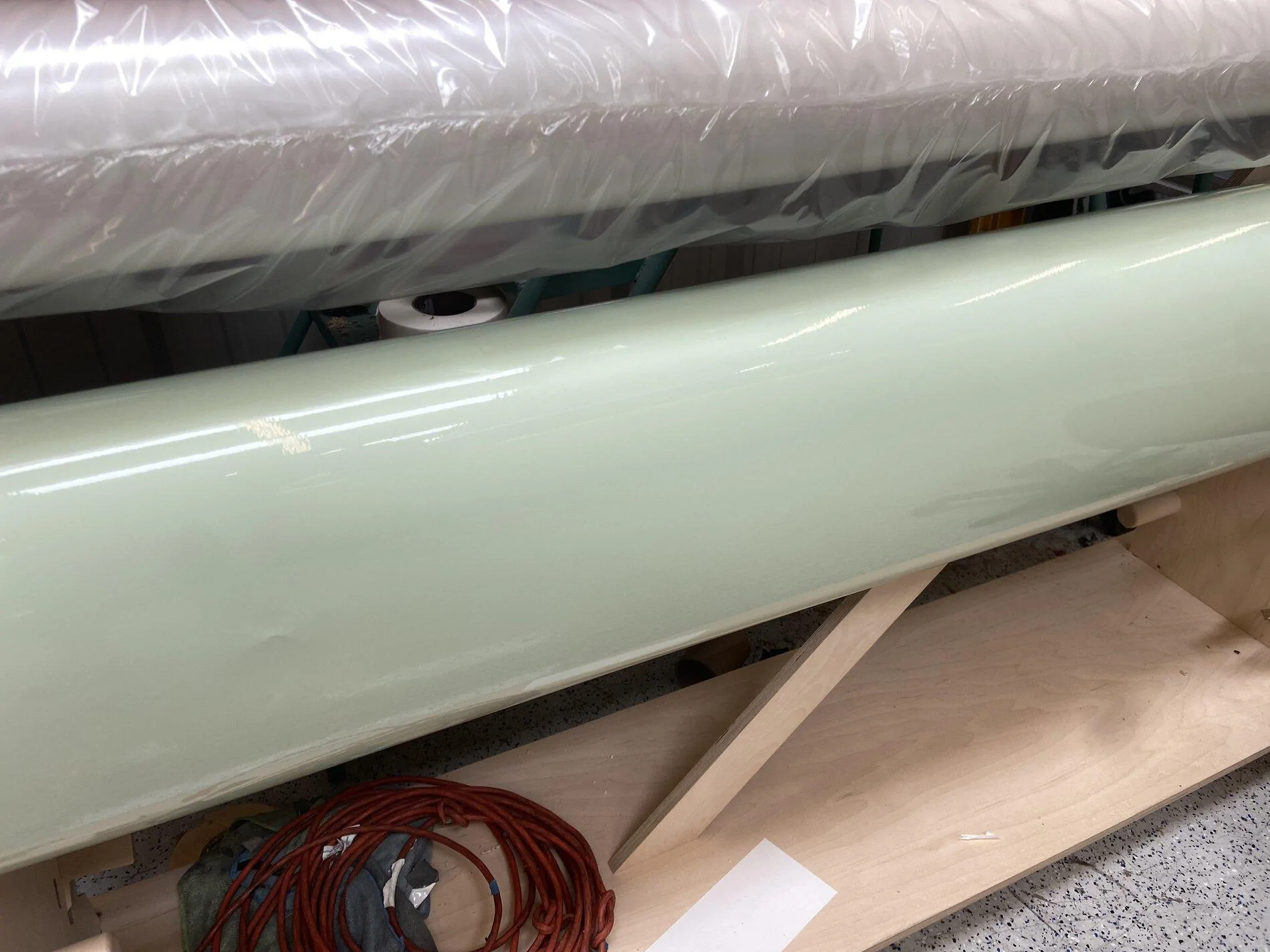

Oxford White is good looking.
There’s many colors to choose from, vinyl wise, that are in that same super light/bright color range. Plus toss in finishes. Gloss, Matte, Satin, Metallic, Glitter. And you have lots of options. Though you’ll regret matte white within hours of picking it up from the wrap shop. Matte white gets dirty super quick and it stains. If you’re dead set on wrapping and don’t love one particular color. Black is the best to wrap. You can always make it any color you want m, as often as you want, and it’ll look awesome. You literally have hundred of colors and finishes to choose from. Change every year if you want. Possibilities are endless. You’re not limited like you are with white paint.
BTW. We’re doing Gloss Light Pistachio. I’ll then do the roll bar, handles and grill gloss white for the nostalgic look. See pic of Gloss Light Pistachio (it’s a light/pastel green). Knowing me I’ll change it in a year. LOL Been doing this a long time, and there isn’t a color I truly love to keep. So I buy my cars black.
Hey, thats cactus gray.

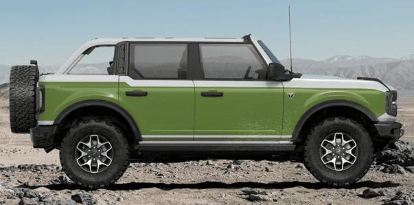

I had a quote from a local guy near me (Southern NJ) to do a broad stripe (like below) on the Bronco for about $800. Haven't decided on whether I will do it, and whether it will be a green or maybe copper, but I like that I can provide protection, get a 'retro' look, and change colors reasonably inexpensively. And yes, I know that because I am doing big flat removable surfaces, I can probably do this myself (or at least at some point), but I do not want to start that way. Let the pro do it.
