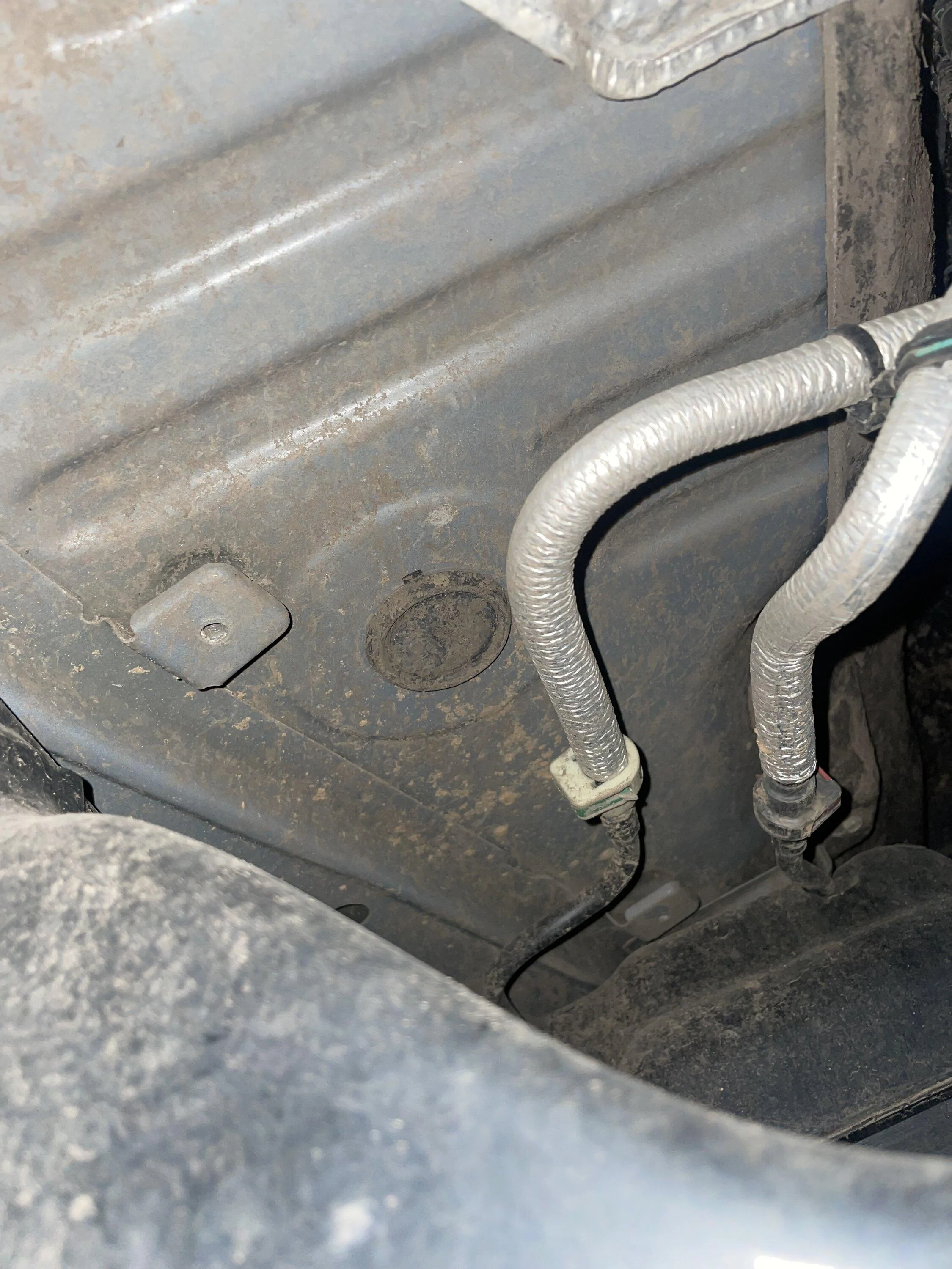

I’d like to know the source of this info? I’ve been trying for months to get part numbers for the rubber flooring. If I have to I’ll probably have the floor line x’d and buy the plugs. It would cost Ford a fortune to have two different floor pans. From what I’ve read they are the same all with passive drains. In carpet models the active drain is plugged from what I’ve read. Here’s my floor pan with the plugged drain hole.

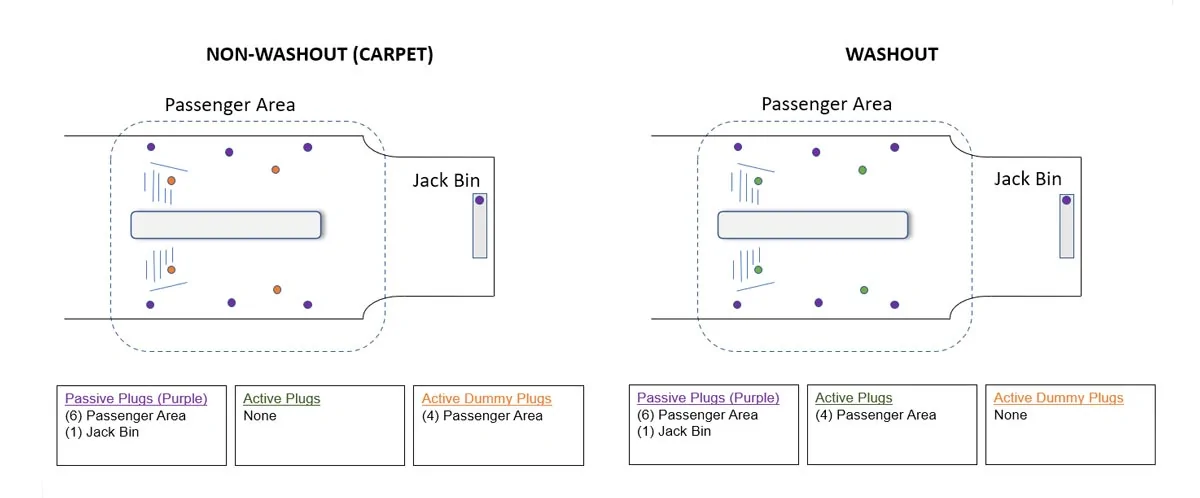

Ford Bronco Converting to washout interior? plus-difference (2)
It would seem like a unnecessary cost for ford to have 2 different floor plans
Didn't see your pic the first time. I slid under my BL to compare and it looks like your pan with the exception of a different plug inserted. Edited original post.
