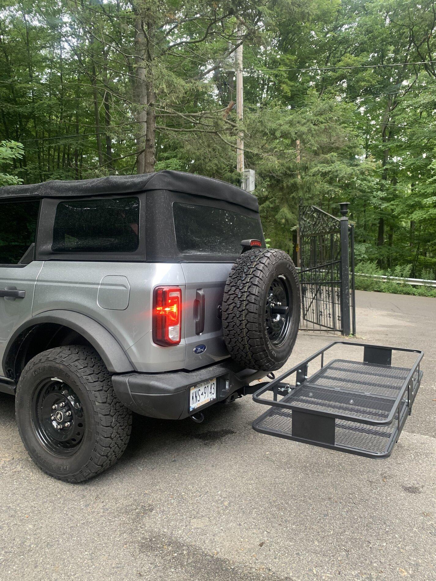

I have 1 which I used with my Jeep for the past few years. Very useful, It actually supports up to 500 lb. (I try to keep that weight under 150 lbs) I used it when I go camping, doing Goodwill trip keep wet items away from the inside cabin after water sports.

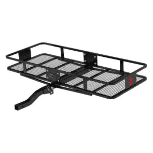

I have 1 which looks like this which doesn't clear the spare tires, and I have to use a hitch extension which lower a couple inches. (Pic 1), if I buy again, I would probably buy the version on(Pic 2) and use it with the same extension with the drop for better door clearance. (Provided ground clearance isn't an issue.
Ford Bronco Curt folding cargo basket 1629637697984

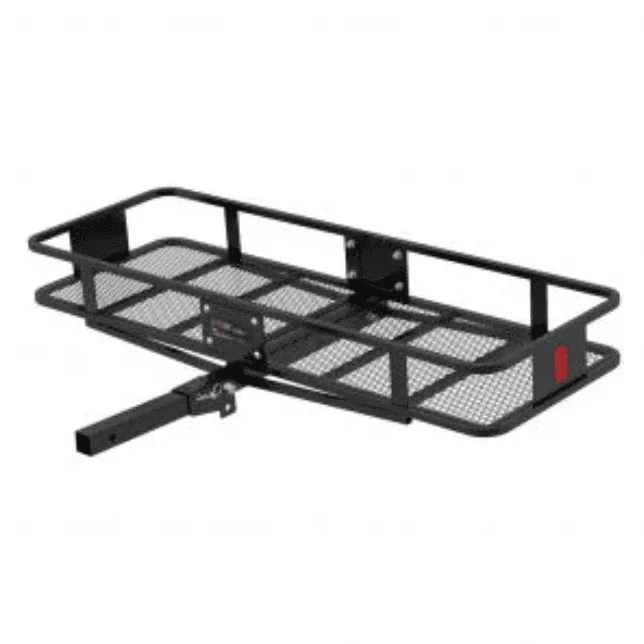

but I prefer this version if I have a chance to buy it again.
Ford Bronco Curt folding cargo basket 1629637762203

Is the only difference the height? I’m planning on installing fishing pole tube holders - so, was already worried about ground clearance.
