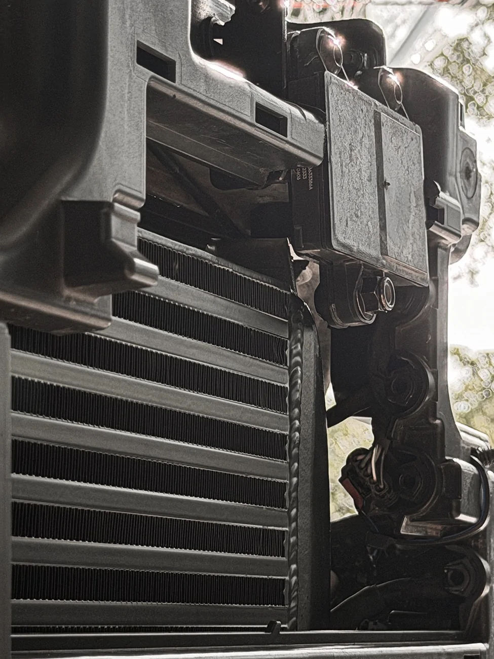

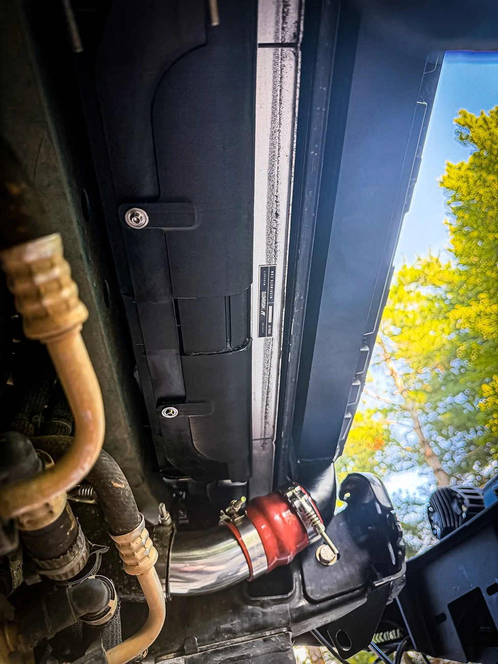

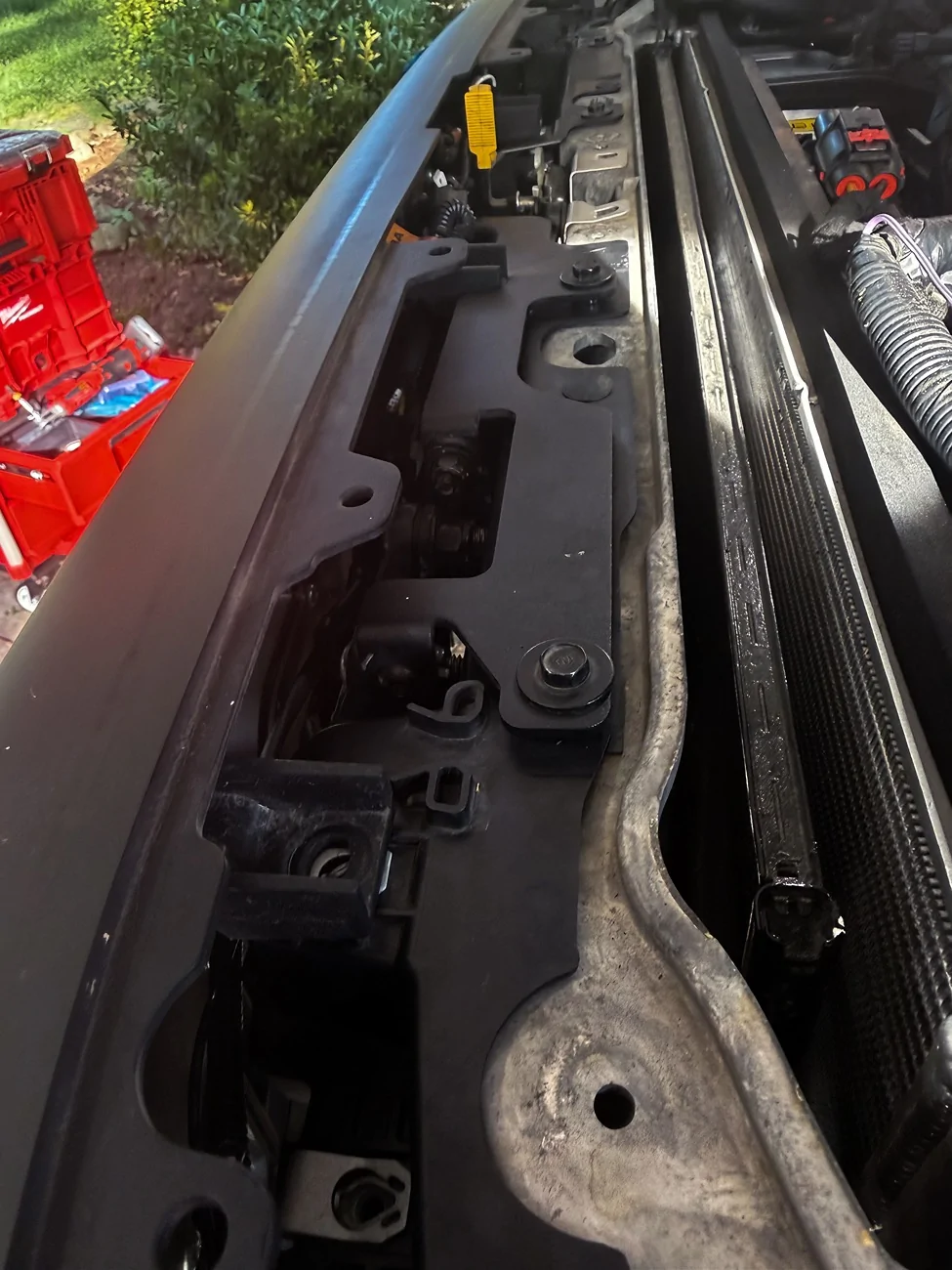

Alright: between work and heavy thunderstorms, I’ve made only a little progress. It seems that the ADD Adaptive Cruise Control bracket with spacers to lift it up slightly, and a lower bolt either removed or a low profile head put in backwards, you might have enough clearance.
Will update as I put things back together, but some quick pics:
Ford Bronco CVF High Mount Intercooler install and testing IMG_6189
Ford Bronco CVF High Mount Intercooler install and testing IMG_6191
Ford Bronco CVF High Mount Intercooler install and testing IMG_6194

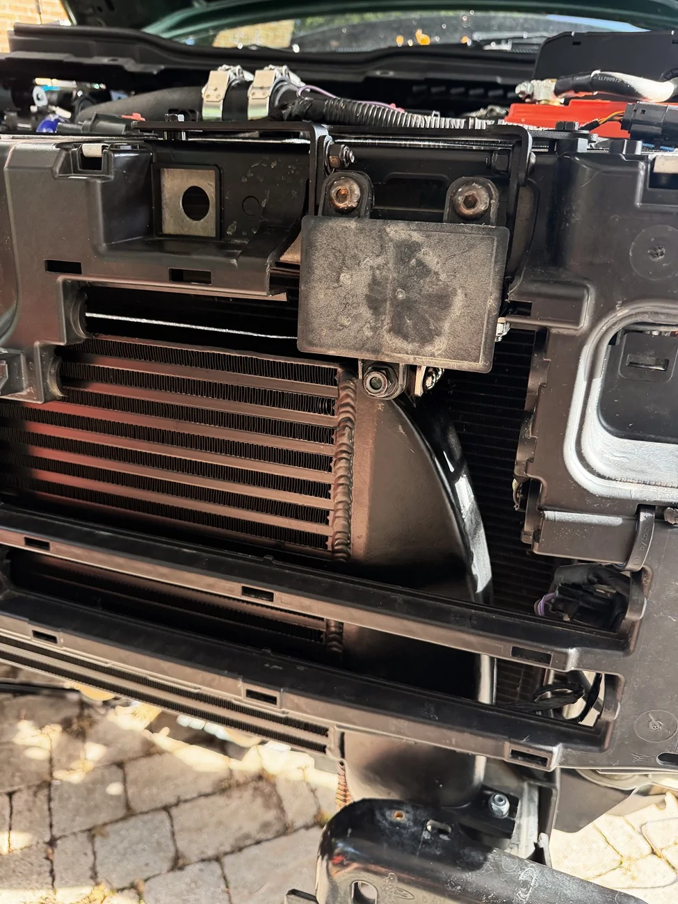

Shroud hole problem solved — thanks for the tip @Ducati1098!
