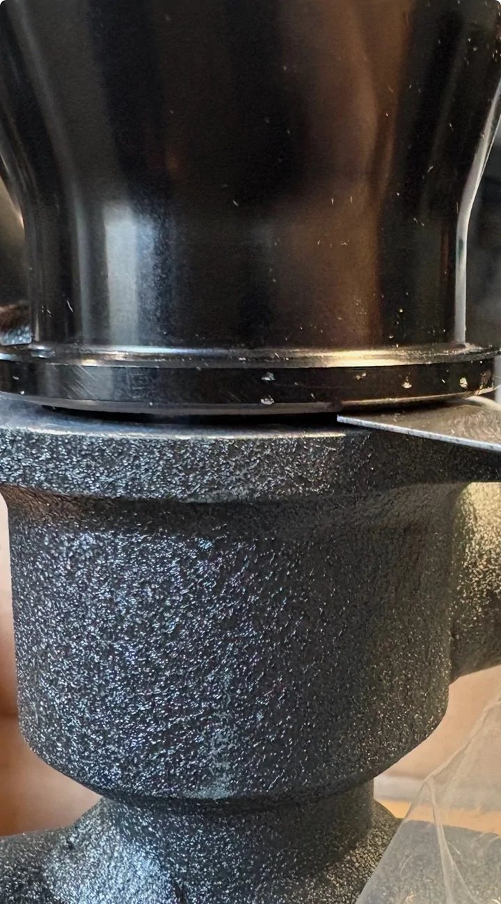

Sorry about a late response on this. But if you have a 2.3 set of CVF charge pipes and try to install a fixed (BOV ) like TurboSmart it will not seat in the pipe correctly. If you are using the OE BOV that is a plunger type BOV so while it does work I can tell you that it stays partially open at all times. I ordered pipes from AFE as well and the same thing. Now AFE said they knew about the issue and made a special pipe for me where they milled the port down an extra 1.1 mm. If you have a 2.7 set of pipes I am not sure if they have the same issues. But if you google TurboSmart BOV won’t fit CVF charge pipes you will see multiple times this has happened. I attached a picture to show the gap where the TurboSmart BOV bottoms out and can’t be tightened down anymore. Also TurboSmart knows about this issue as well and tried everything to help but they couldn’t make up for the incorrect milling issue.
CVF has a fix coming next month. Email them to get a replacement hot side pipe. I have a TS BOV on my CVF charge pipes, but hard to use a machine washer as a spacer.
