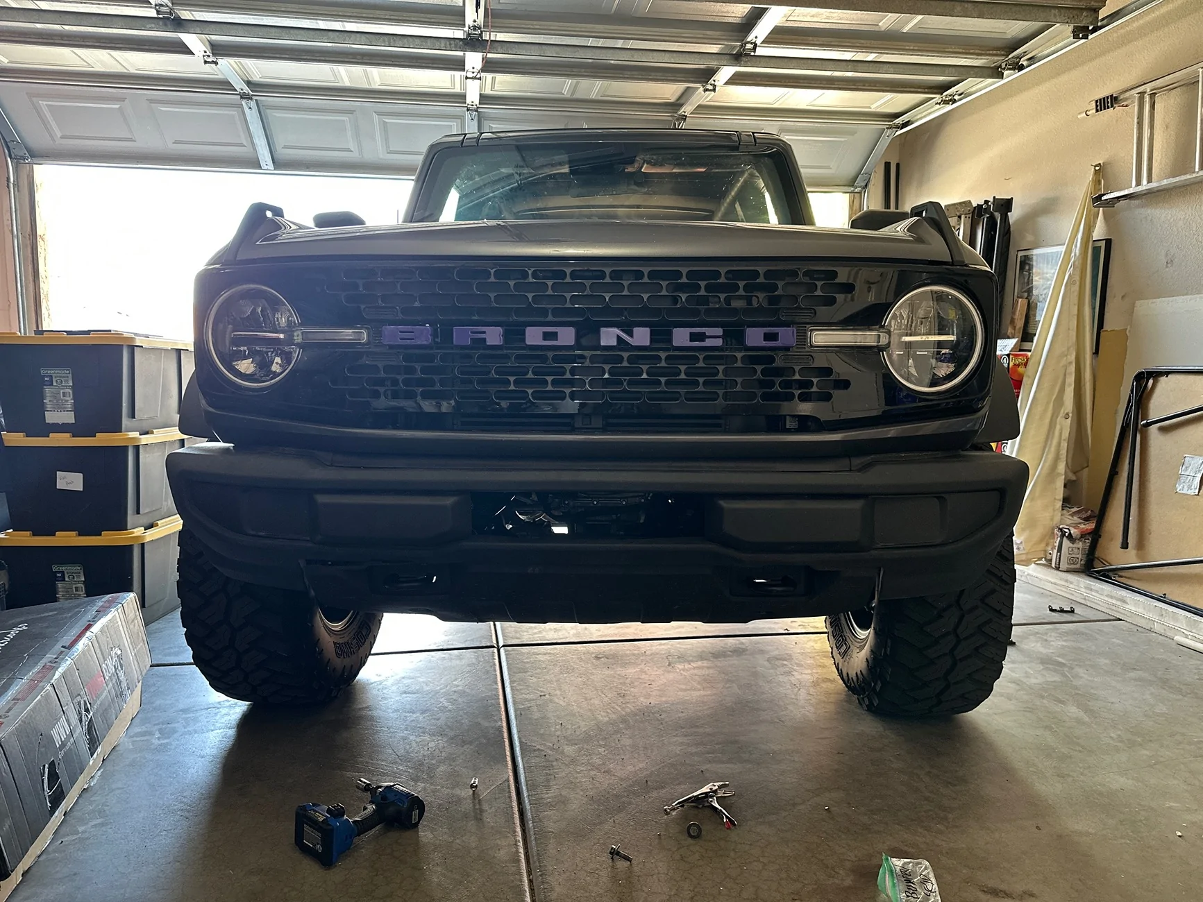

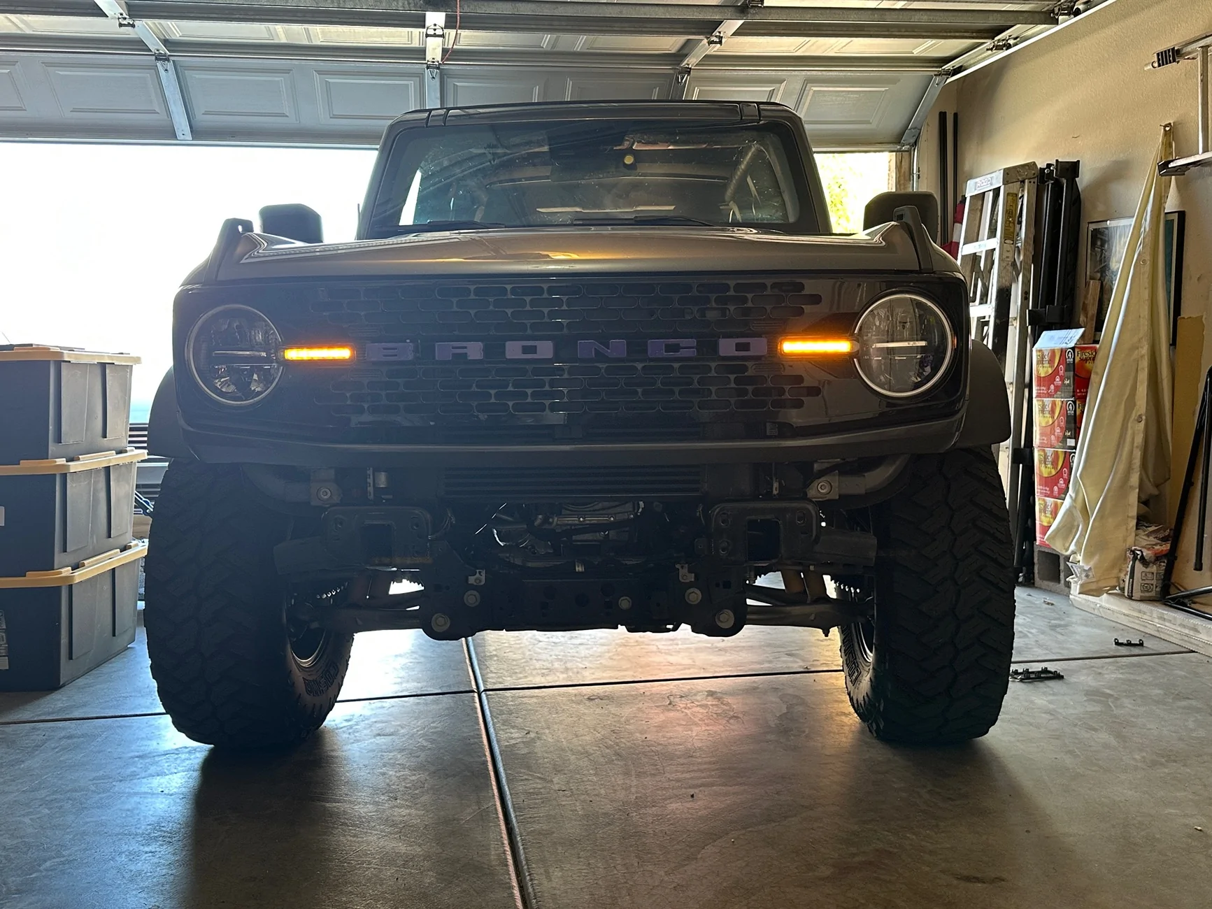

@GreyZ I cannot thank you enough for the write up instructions on this, I used it religiously to throw it on the last two days. I too have plans to run a low profile winch/prerunner style front bumper and a high mount intercooler was a necessity. So much more room for activities. Do you have any updates as far a your winch setup goes? Pic of pre and post bumper install.
