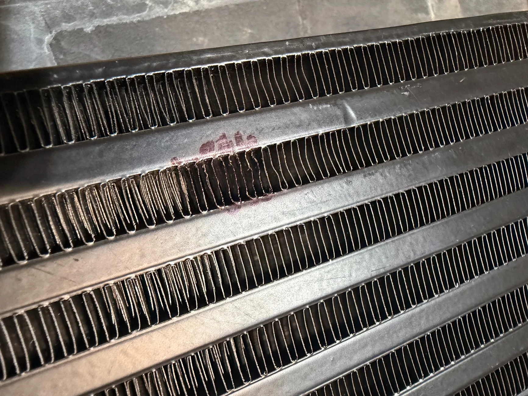

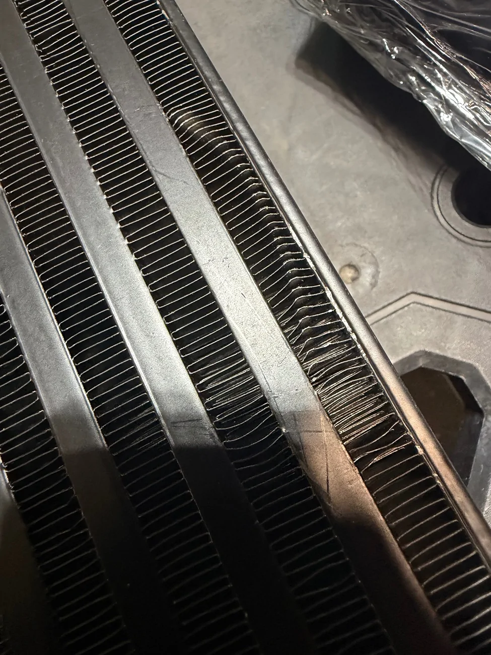

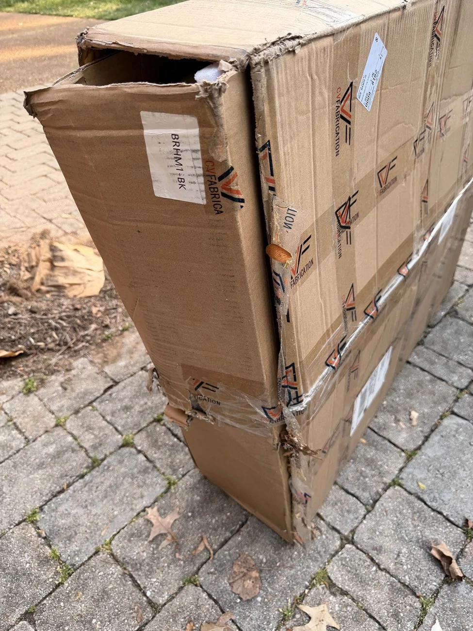

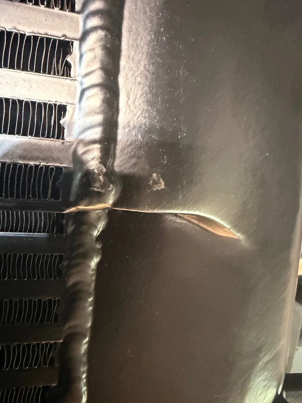

Well. It arrived on Saturday. I physically obtained it from the driver on the UPS truck and he and I were both dismayed at the condition of the box. Or what was left of it. Talk about a range of emotions.
Ford Bronco CVF High Mount Intercooler install and testing IMG_5775
Ford Bronco CVF High Mount Intercooler install and testing IMG_5772
Ford Bronco CVF High Mount Intercooler install and testing IMG_5774
Ford Bronco CVF High Mount Intercooler install and testing IMG_5778

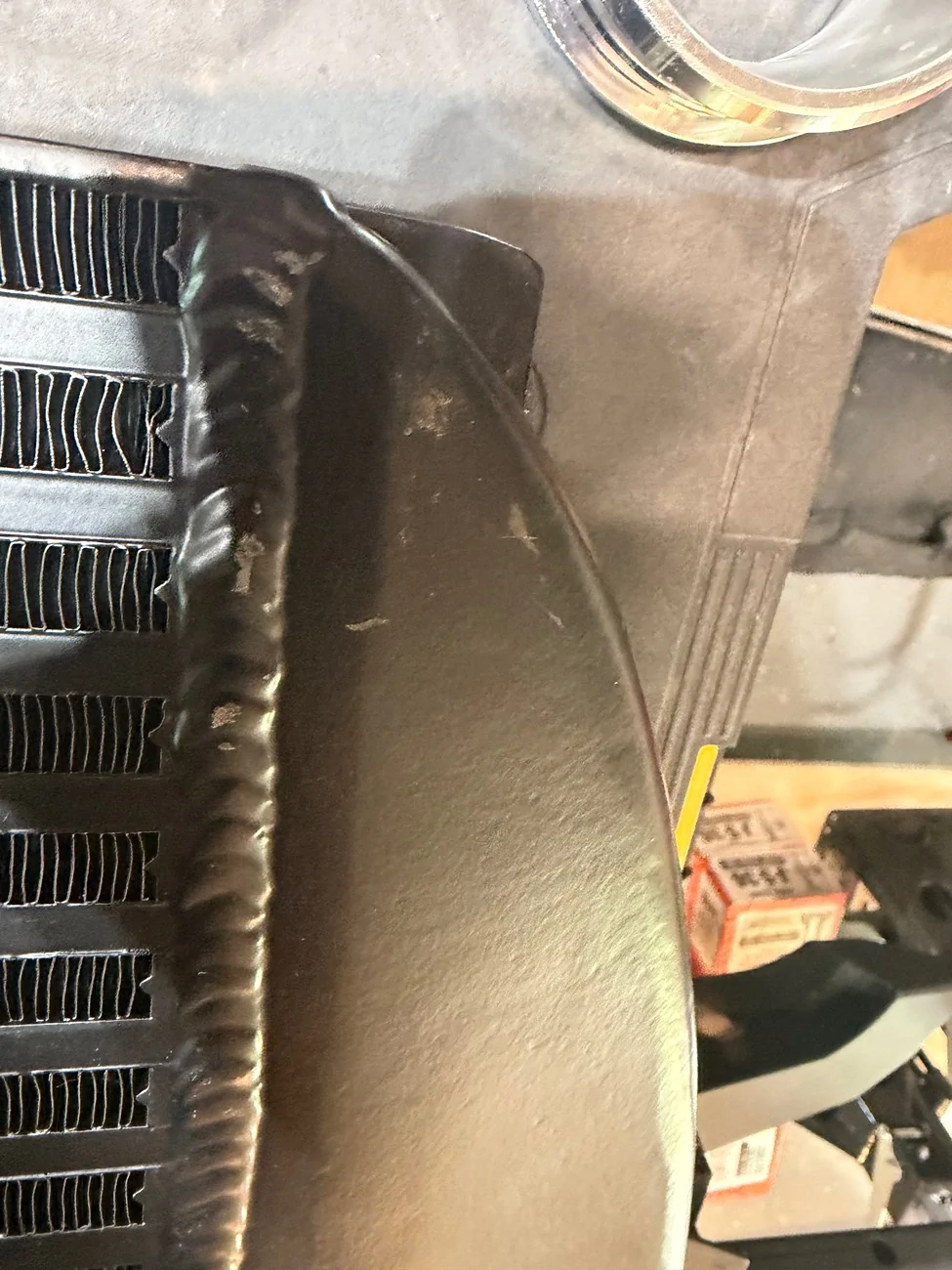

Generally, it is in good condition, with a few scuffs at the lower front face of a side tank and a few fins that are bent over. All in all, it’s nothing I’m worried too much about, going for function here.

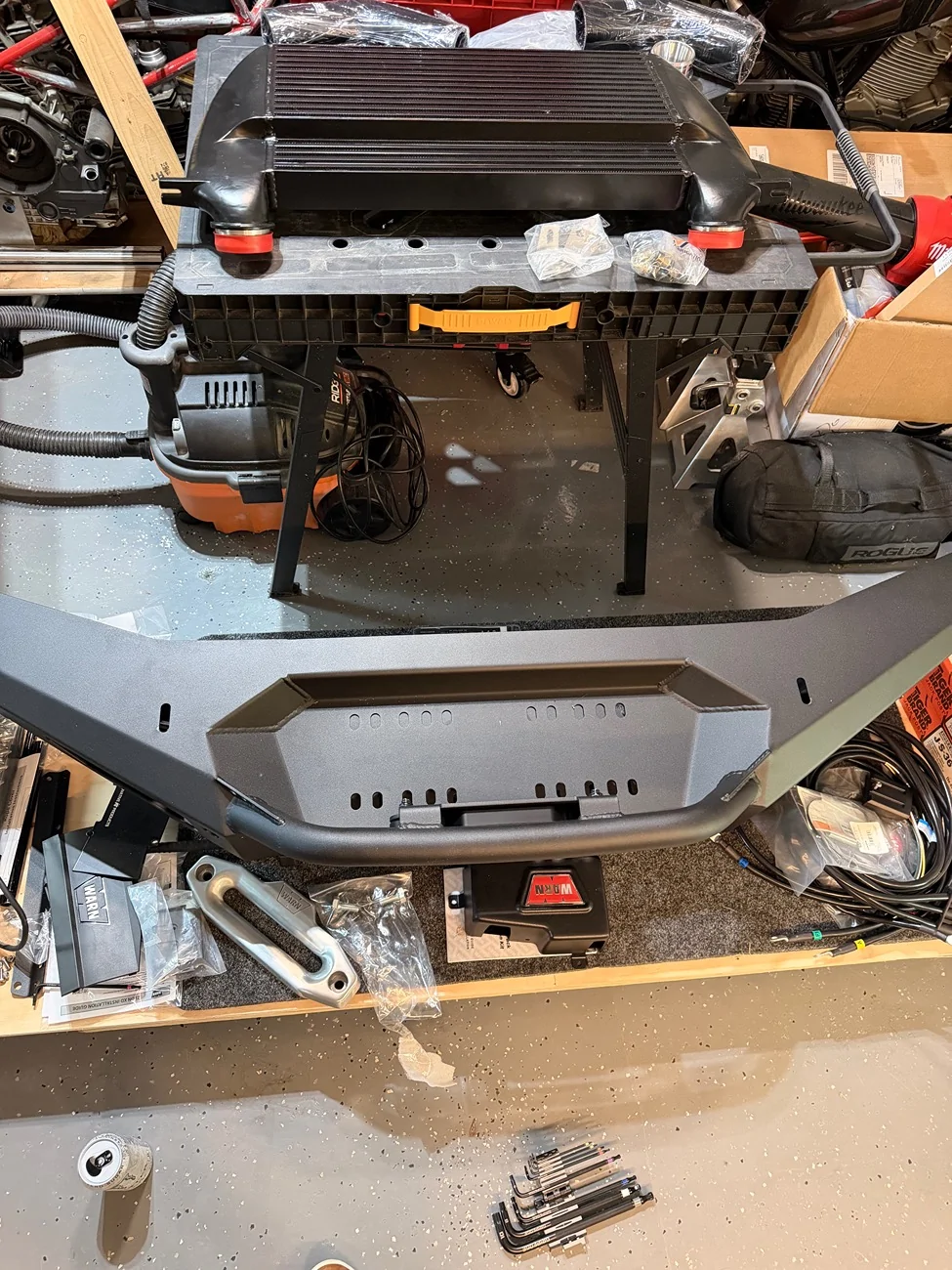

Son of a gun is heavy to be sure and enormous.
My goal, motivated by switching bumper for a winch setup, was to stick with all CVF parts (charge pipes, intercooler, downpipes) instead of ponying up for a switch to replace the charge pipes and intercooler with mishimoto parts or trying to figure out cobbling together what I have with Wagner Tuning bits. And the CVF appears to boast the largest volume / surface area, so I can plan for the larger turbos.
At this point, i am mentally prepared for a multi-day or week+ tear down for test fitting where I’ll have to order something I don’t expect to make things work.
Generally, it is in ā€˜fine’ condition, with a few scuffs at the lower front face of a side tank and a few fins that are bent over. But some of it appears to be pre-packing for shipment, like sharpie to cover up a blemish:

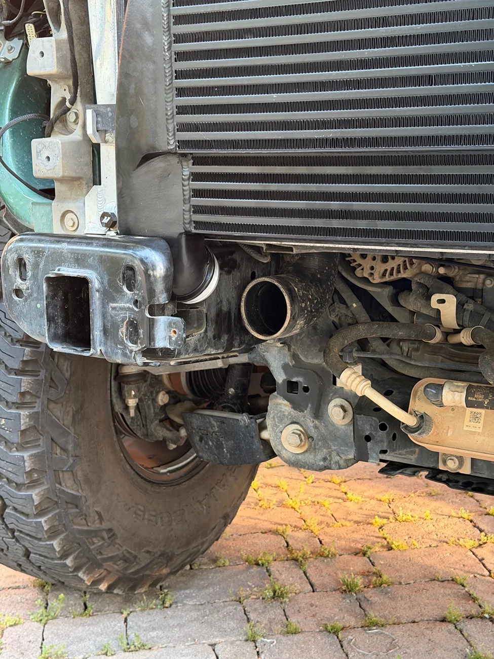

Part way done. I ended up with two driver side upper L-brackets, so I’ve reached out to CVF for a passenger side bracket since the brackets are mirrored one side to the other. So, pending figuring out couplers below, that’s my impediment to reassembly.
it’s a REAL tight fit with the inner ADD inner horn reinforcement, but I think it will work without contact.
for the Cvf charge pipes, I will need an aluminum or steel joiner to connect the downpipes 90° silicone, and I’ve got some double hump silicone bellows on the way, plus the 45° silicone couplers listed above here, and a pair of 30° couplers just to figure out what works the best. Sprung for all the options and expedited shipping to get this thing back on the road.

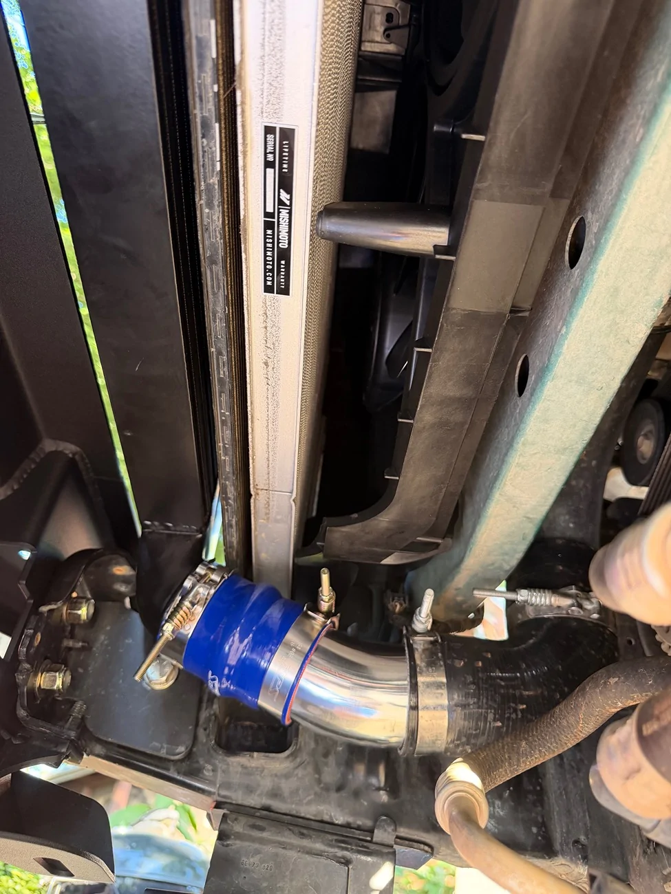

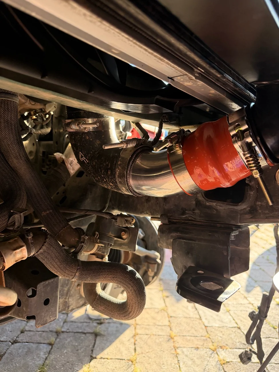

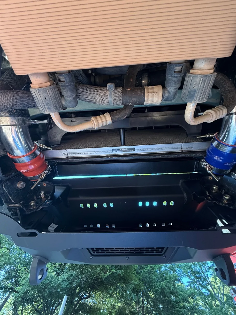

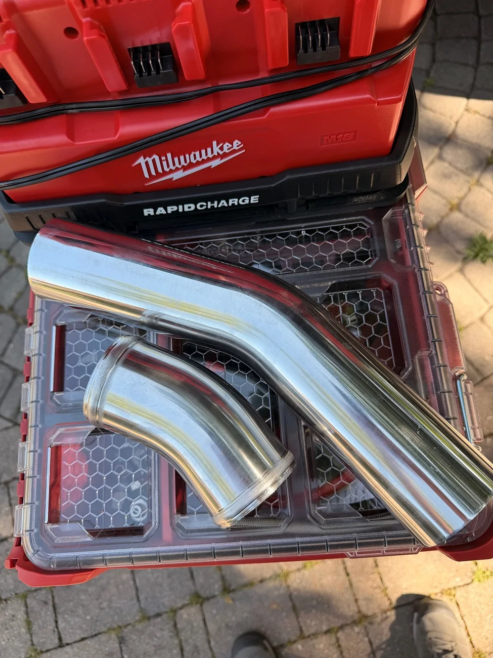

I made some progress. I tried a variety of couplers and joinery pipes before settling on this. Couple of notes when using CVF Charge Pipes - parts and tools required:
Parts:
Tools:
  • Pipe/Tube cutter that goes up to ~3ā€ - doesn’t have to be fancy - this QWork from Amazon arrived overnight and I could finish the job this morning.
  • Pipe/Tube bead roller to put the coupler/clamp retention bead on the aluminum pipes - got this X Autohaux one.
I mount the silicone couplings to the intercooler, adjusted CVF 90° couplers up the charge pipe slightly to align best with new setup, held up aluminum pipes to mark length to remove, cut the pipes, added the retention bead, deburred the edges, and got all shavings out, and installed.

Whats your plan for closing that huge gap in the fan shroud to radiator?
Gluestick
Josh
Mar 23, 2023
678
760
Nashville
instagram.com
Explorer ST, Bronco Badsquatch
Duct tape n bubblegum
Gluestick
Josh
Mar 23, 2023
678
760
Nashville
instagram.com
Also note that’s the Bronco raptor fan installed as well, since I have a bunch of stuff taken apart, might as well fool with it at the same time
