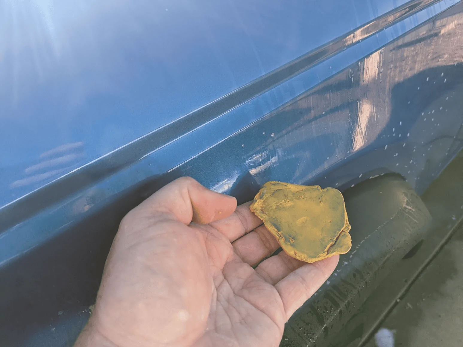

here's a new one to add for you. Went to give the new truck a once-over and good waxing now that I've had it for a week. I expected to find rail dust and the like. I did not expect to find overspray from the paint booth:
That right there is Velocity Blue paint, coming right off into the claybar. appears to be on *top* of the clearcoat, so no big deal. But damn, never seen this on a brand spanking new car before.
Is that a paint curing issue? I know nothing about auto paint.

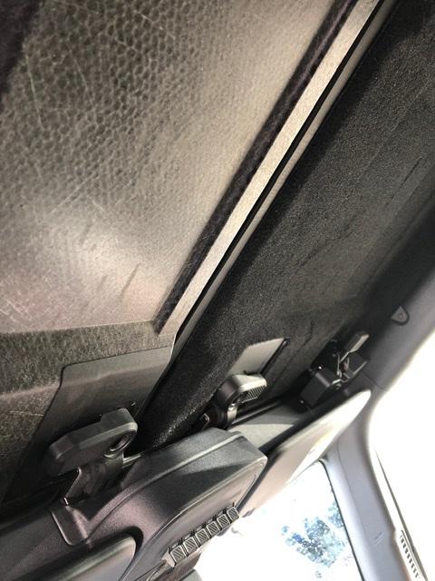

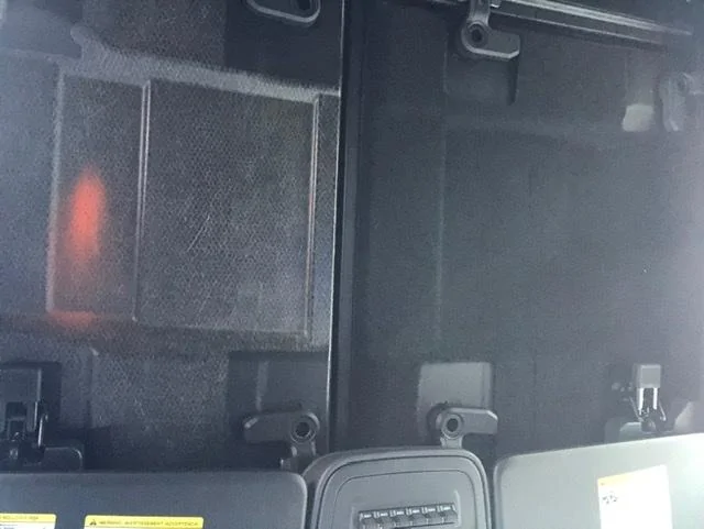

One to add re: hard tops. Make sure all the parts of the soundproofing are attached to all the panels. When I picked up mine a month ago, the drivers side roof panel did not have any sound insulation. The insulation was present on the passenger side panel and the cab.
And I’m case you’re wondering, the dealer says it could take months to get in the replacement insulation panel.
Probably more indicative that they're running the bodies through the paint booth too close to one another

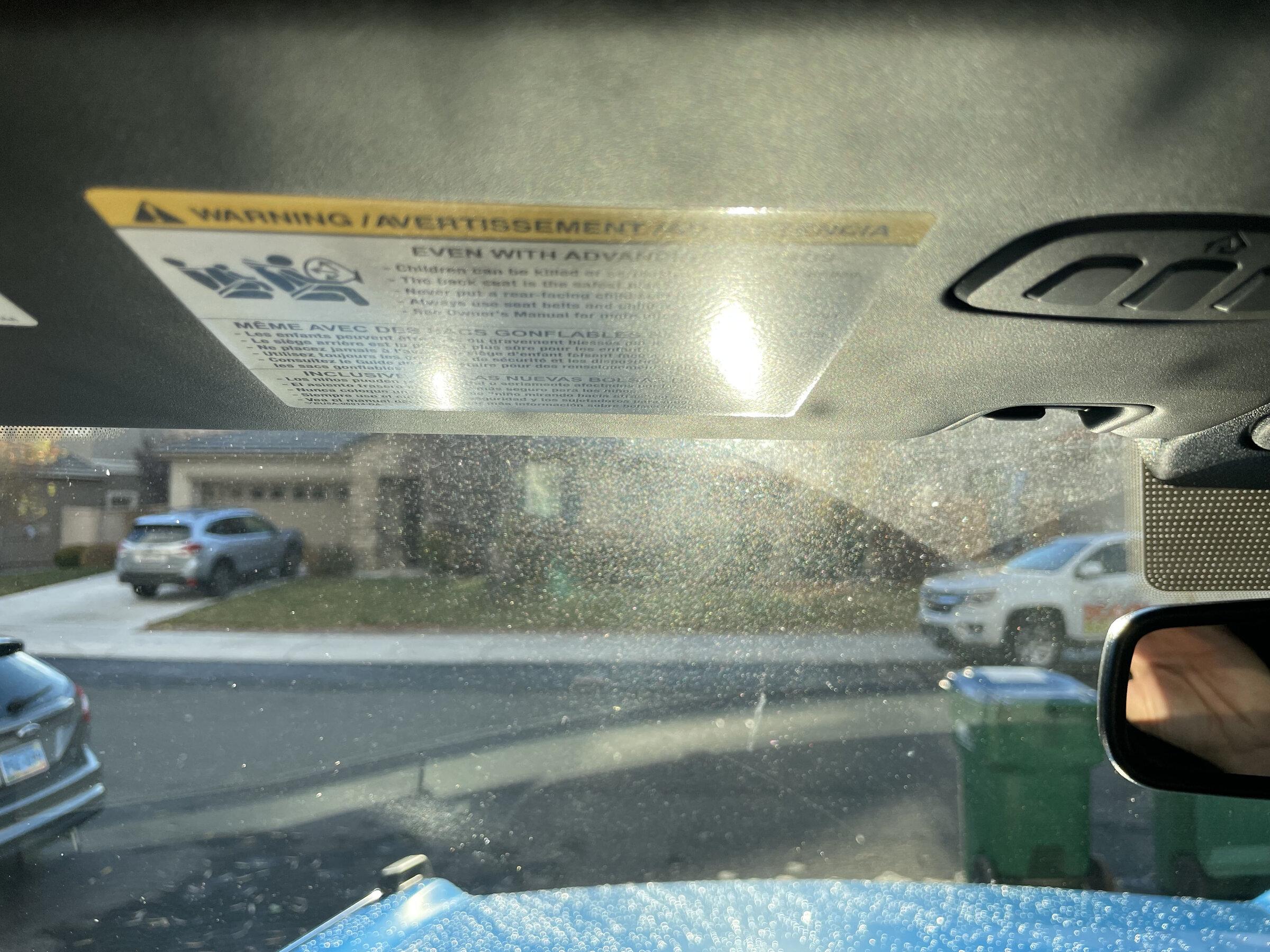

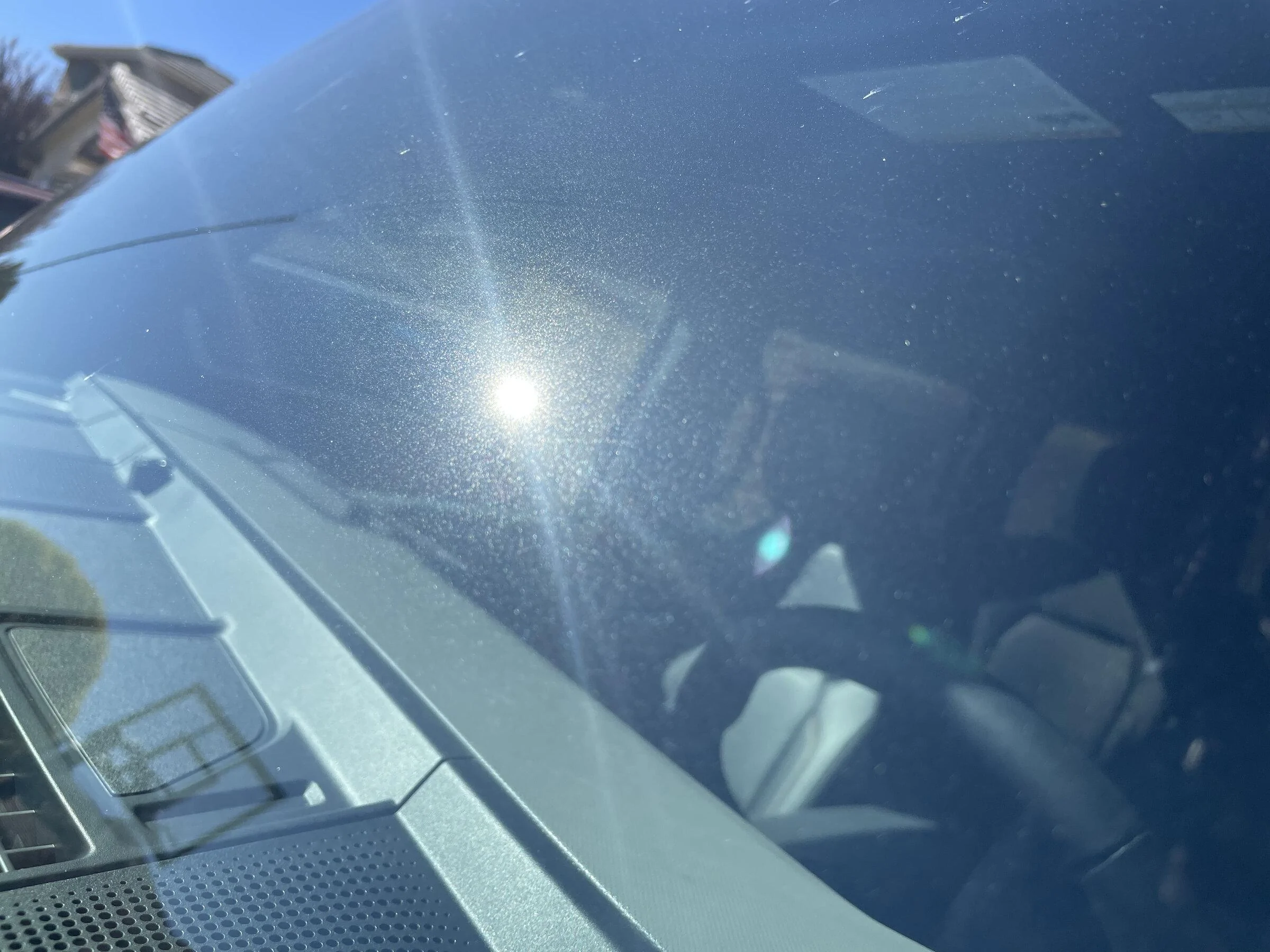

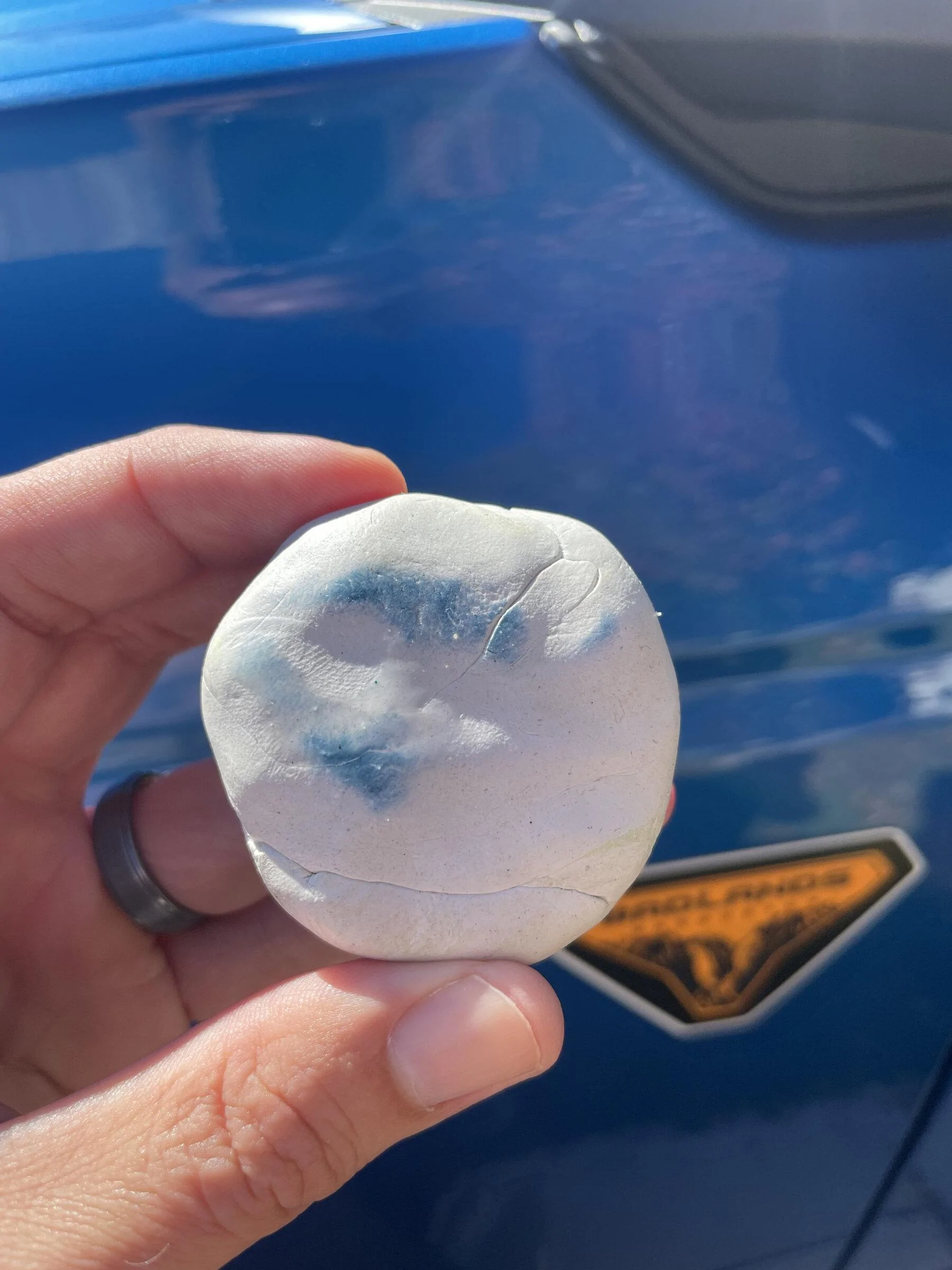

It's definitely factory overspray after the vehicle has been cleared. Our Velocity Blue Bronco had it as well all over the hood, front fenders, part of the doors and even the windshield! It's almost impossible to see, but on ours you could feel it. The paint in the effected areas was super rough to the touch as was the windshield. Our dealer paid to have the entire vehicle professionally paint corrected. Paint is baby smooth now. I'll post videos/pics later when I get a chance of what we documented and sent to the dealer.

Here are some pics and video of the factory overspray that we discovered on our Bronco, after having taken delivery. Without the perfect lighting, it's very difficult to see by just looking at the paint, but you can definitely feel it and hear it. Volume required when watching the video so you can hear the difference when I rub my finger across the paint.
Factory Paint Overspray - Windshield Exterior
Ford Bronco DELIVERY CHECKLIST  (OCD Version) for Expectant Bronco Owners badlands_windshield_exterior
Factory Paint Overspray - Windshield From Inside
Ford Bronco DELIVERY CHECKLIST  (OCD Version) for Expectant Bronco Owners badlands_windshield_interior
Factory Paint Overspray - Clay Bar
Ford Bronco DELIVERY CHECKLIST  (OCD Version) for Expectant Bronco Owners badlands_claybar
