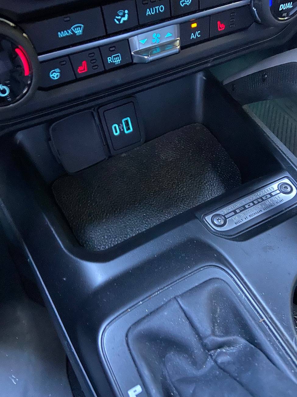

I dislike the wireless charging pad - it heats up the phone, doesn't really charge, and essentially precludes storing anything in the little space that may heat up from induction.
Rather than pull a fuse, I just cut a rubber mat of sufficient thickness that eliminates the coupling to engage charging. About 1/8 inch is sufficient, but I used two pads just to be safe. Others have proposed this, but I have not seen a thread on it, so I thought I'd post one.
I pulled the tray out and traced a pad template to cut an insert that fits into the tray. Then I reinserted the tray and placed the insert within the tray. The end result is this:
Ford Bronco Disabling the wireless charging pad with insulator Pad 0

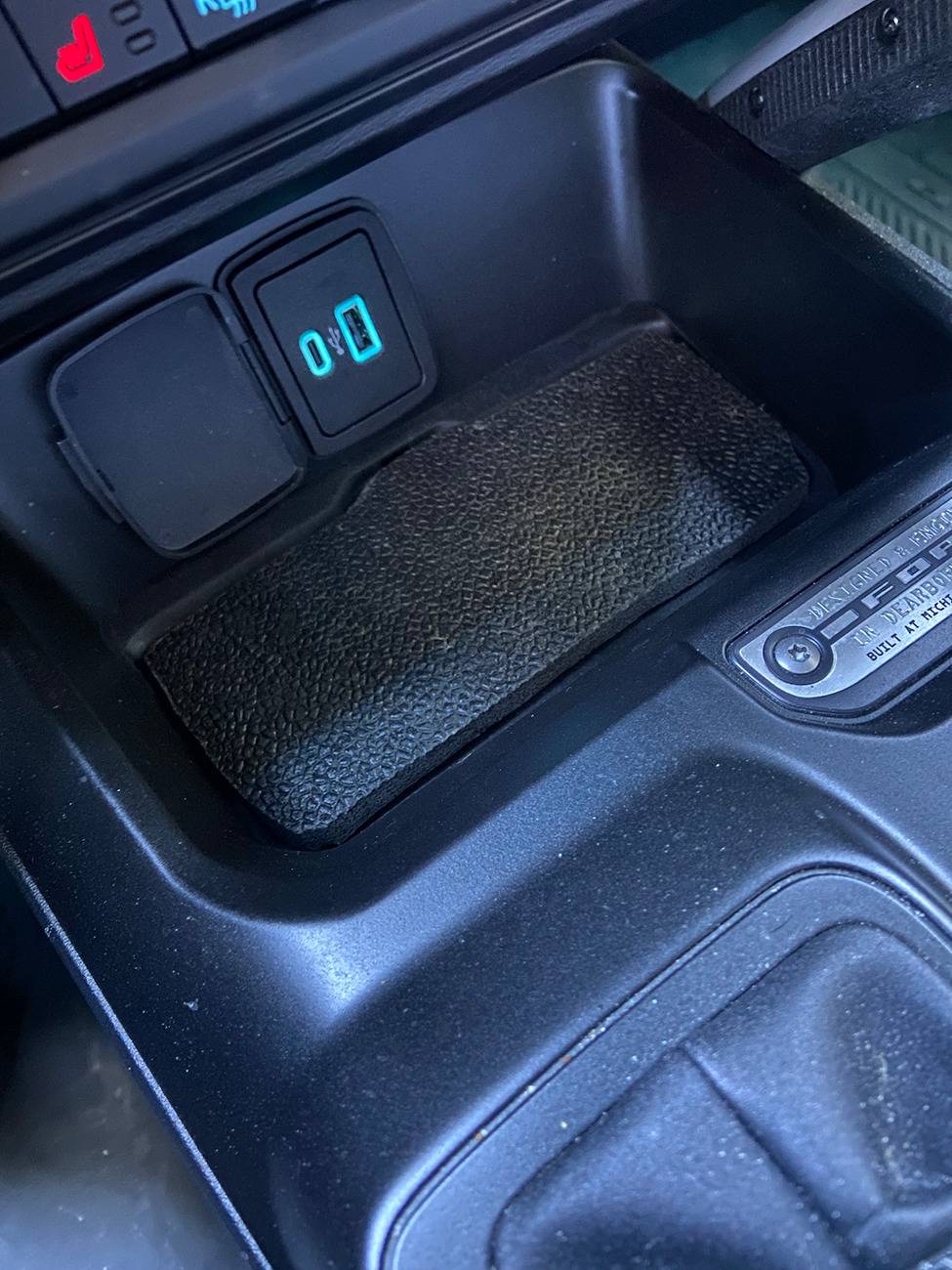

Inserted, it looks like this (it is actually difficult to see; I have some lighting for the image capture).
Ford Bronco Disabling the wireless charging pad with insulator Pad 1

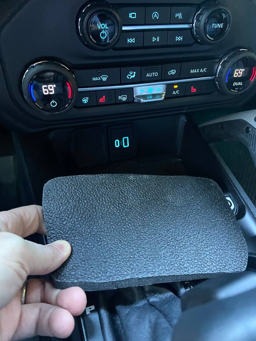

One is sufficient, but to be safe, I made an extra pad to place atop the insert. The extra pad is larger, and essentially is the size of the tray itself (see below). This is a simple way to passively disable the charger without pulling fuses or any disassembling the console (apart from pulling out the tray insert for making the template, and the tray pops out and back in easily).
Ford Bronco Disabling the wireless charging pad with insulator Pad 2

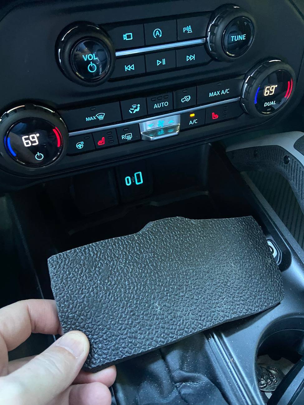

Final set up:
Ford Bronco Disabling the wireless charging pad with insulator Pad 3

Turns out only one piece of rubber is sufficient. Drove around and "tested" the single piece.
