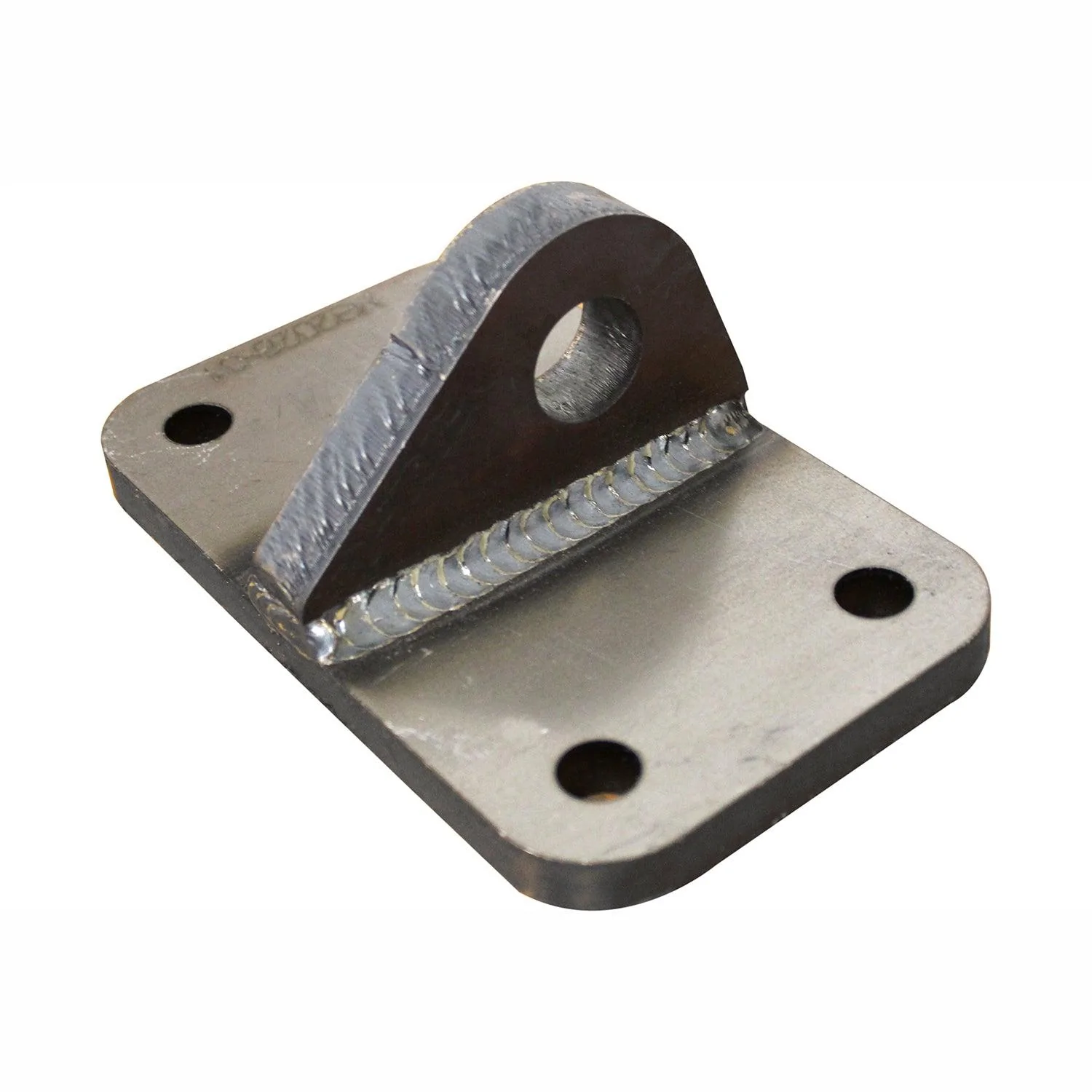

You will cut the soft shackles on the sharp edges of the Shackle pin holes, buy the hard ones.
D-ring shackle mount for the sharpe hole edge detail example only.
He is correct if the recovery points have sharp edges like the above then get the D shackles. But take a look before you buy. a lot of manufacturers of off-road equipment are starting to design recovery gear with soft shackles in mind so you will see a lot more rounded edges on recovery points etc.

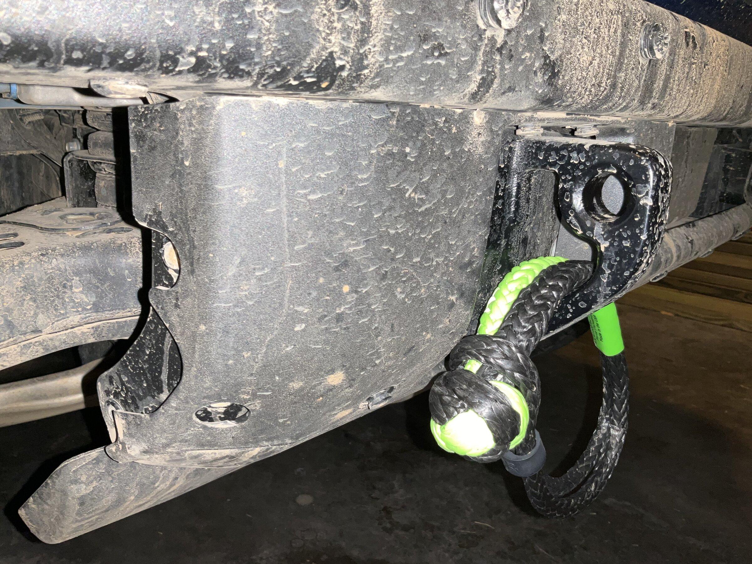

I just found a good shot, looks like the champhered the edges.
Ford Bronco Do I need hard shackles with this set-up? 1628620902724

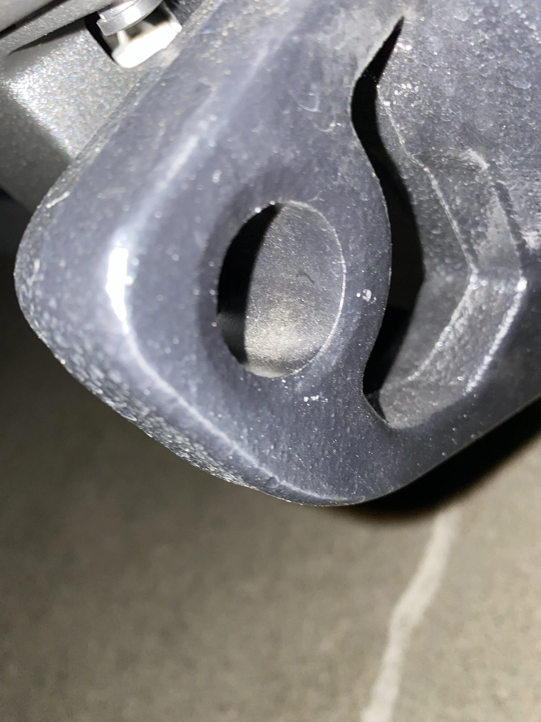

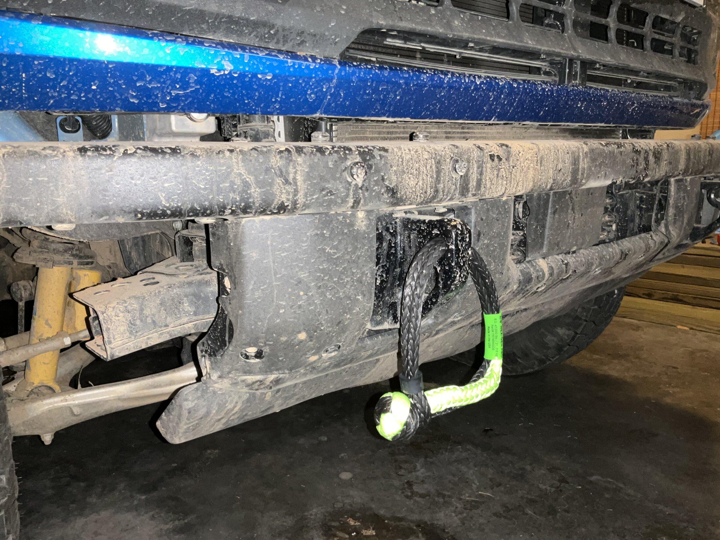

I just went out to look at the recovery points and they do seem somewhat sharp. I suppose I'll use the soft shackles for the rear bumper recovery points and pick up the SITH or the Gear America shackles for the front. Thanks everyone....Happy New Year's Eve!
Ford Bronco Do I need hard shackles with this set-up? IMG_8820
Ford Bronco Do I need hard shackles with this set-up? 4255221D-59F6-4A1E-A6B1-EB32F55278C2
I would assume that opening behind the shackle pin hole is designed to be used with a soft shackle. Doesn’t that opening go all the way through? If so that has to be what it is for.
U725Bronco
U725Bronco
285
389
NorCal
It does go through and I didn't even think of it, but see the post above. Thanks!
