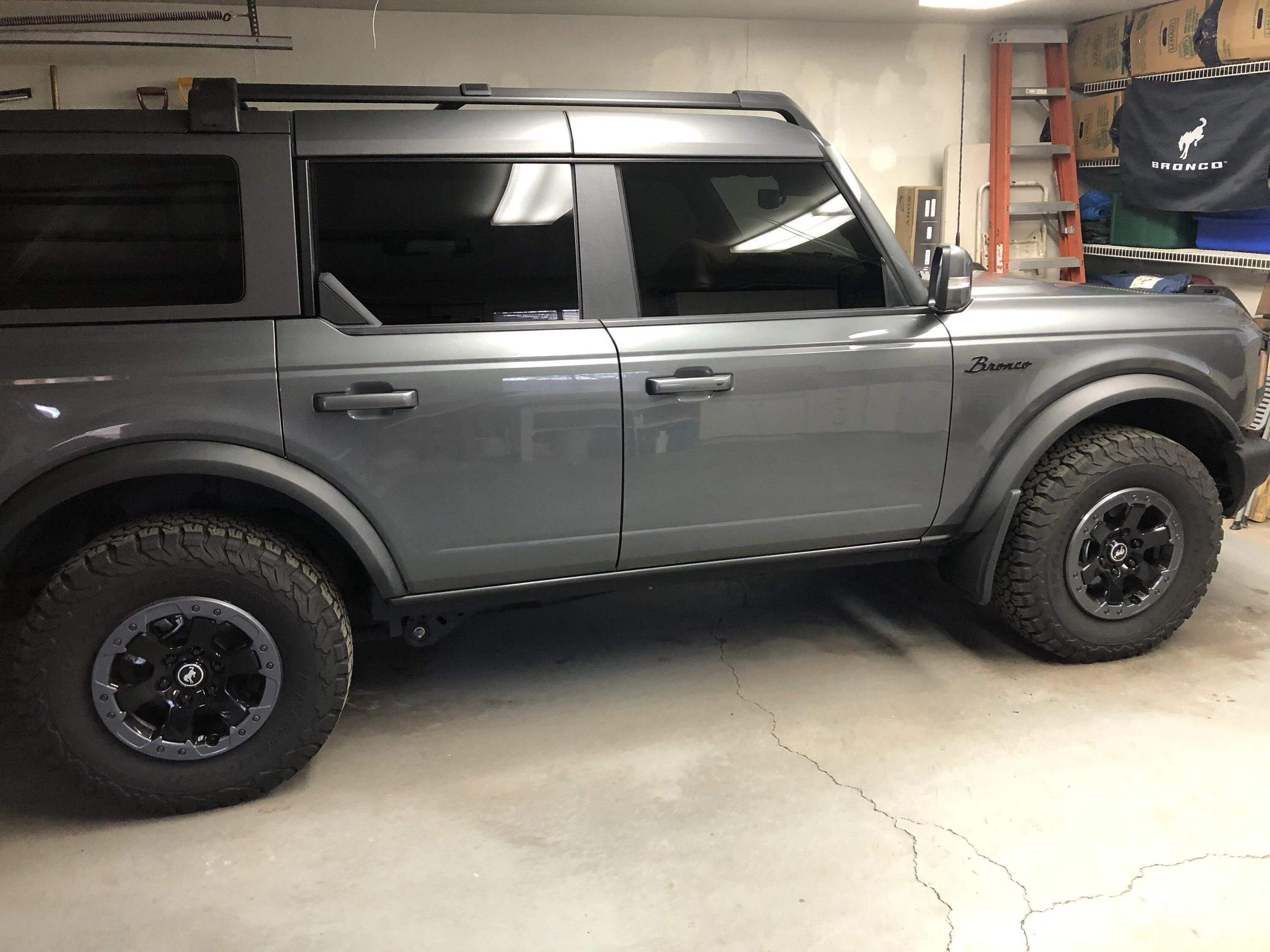

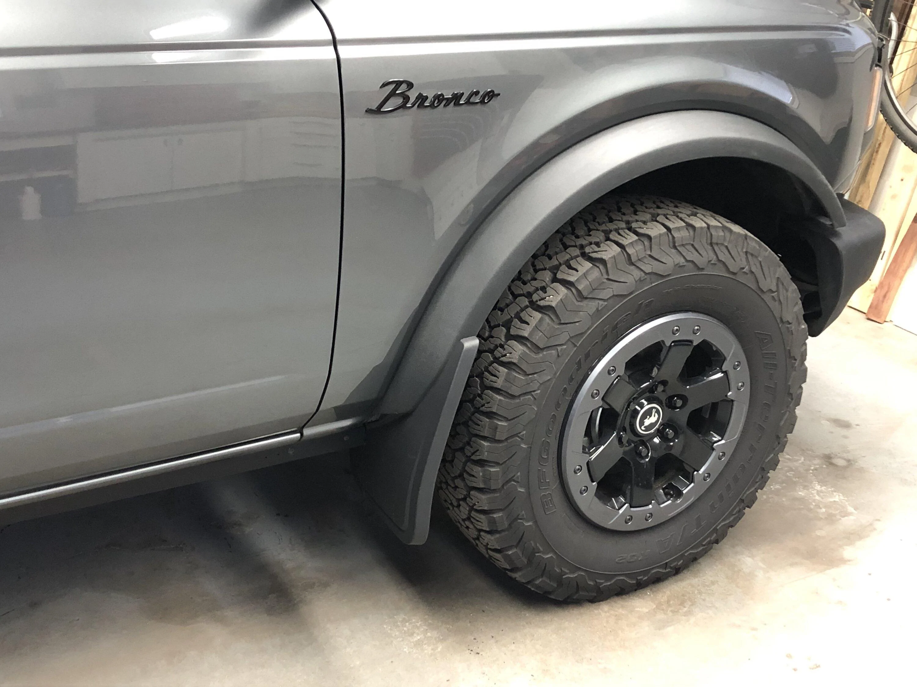

I installed the Form OEM mudflaps on the front of my non-sas OBX w/o running boards yesterday. They do ask you to drill two 1/4" holes in flares as part of install. Then use plastic grommet to attach. I ended up only doing one hole, down low where it would be hard to see if I remove. I honestly think you could install without any holes or grommets- it is very solid with all other fasters and clips. I like the end result - no regrets. Less paint chips and mud splash. PS. holes are drilled in flares, not body or metal.

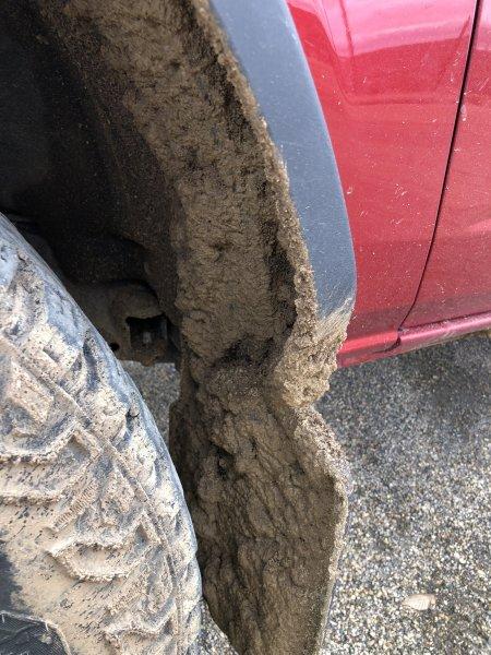

The front flaps have a huge gap allowing anything and everything to pass through the gap between the flare and the flap. regardless of price, the weather tech flaps do no do the job up front.
You're basing that on how they look to you rather than how they work in real life, right?
Here's a shot of my front mudflap after going through a bunch of mud. I don't see any mud on the side of my Bronco that got through the gap.
Another shot showing the "gap" on clean flaps, right after I installed them, for comparison.
Well Scott R Nelson, I agree your experience with them looks better than others. they absolutely did what I'd want to them to do. I have also seen (was looking for the posts) folks who used the Weather tech flaps and had a different outcome. I am glad they work for you. I do believe they will have a gap in protection and for that reason I am not going to go with them. Between the varying degree of satisfaction and the fact that I dont care for the they way they look I am still searching. But I thank you for your input, I am amazed they did as well as they did for you.
