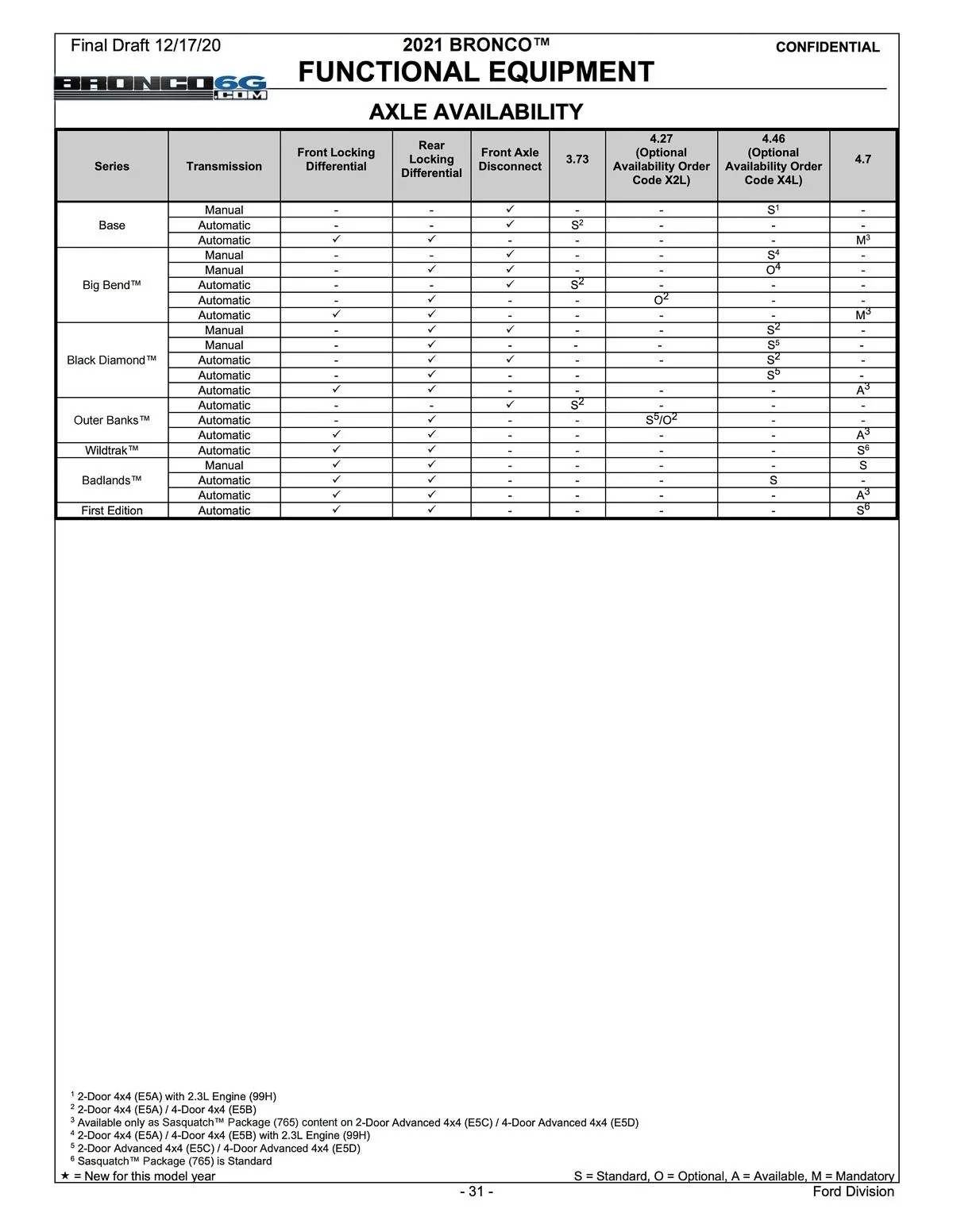

Some Broncos have a FAD—front-axle disconnect. All Broncos with open differentials have a FAD
All except one. 4.27 doesn’t have a FAD
4.46 can also come with or without it. I have no idea what determines if it gets it or not though.
Final drive ratioFeature codes (SDR codes)Axle codesFuel economy codes (SDRType of axle/differential
3.73EGAJBEGKADC7AAFOpen style front differential - M190 STD - aluminum carrier and tube assembly with FAD, 7.5” ring gear
4.27EGAMEOpen style front differential - M190 STD - aluminum carrier and tube assembly without FAD, 7.5” ring gear
4.46EGADROpen style front differential - M190 STD - aluminum carrier and tube assembly with and without FAD, 7.5” ring gear
4.46
4.70
EGADR
EGAA6
EGKAHCElectronic locking front differential - M210 - Black cast iron carrier and aluminum tube assembly without FAD, 8.26” ring gear
QUOTE
Advanced 4x4=no FAD
