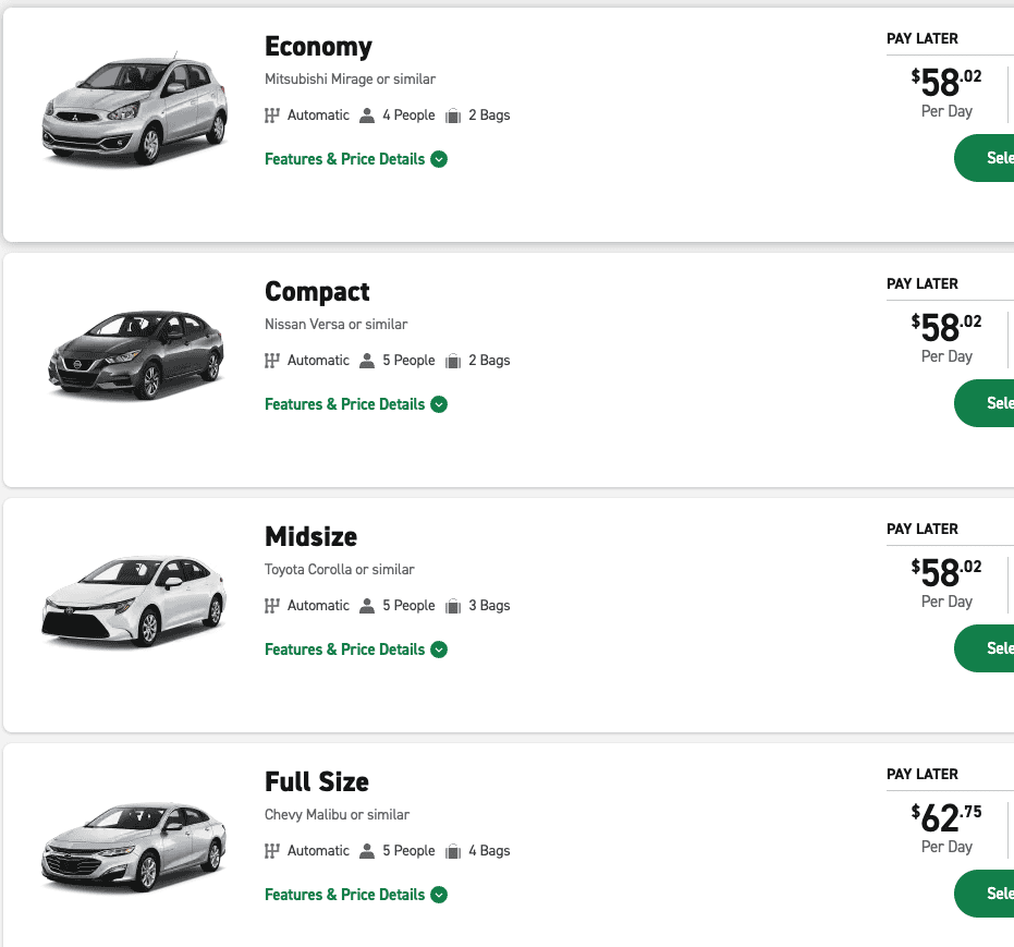

What's the problem with 12AM? Oh know they still have a Y2K problem!! I'm going to completely disable auto updates. That said you should be able to get a rental car for $45 almost anywhere. You must be going for the lux models.
Ford Bronco Failed software update, unable to start vehicle! Screenshot 2023-02-24 at 12.23.22 PM
These are the lowest currently and I checked 4 companies but thanks for your input. Without my discount code they are 70+... In the end, its not the end of the world but I should not have to pay any money out of my pocket for this.
I don't think rentals are particularly high in my area, but car rentals start at $50 if you swing a good deal on the cheapest one they have.

Not that this is OP's job to do as I believe the dealer should be able to pay the next cheapest rate if they $40/day is too low but calling the rental facility, explaining the situation to the manager, a lower rate could be offered. I am a service advisor and we have pre-negotiated rates at an Enterprise. Should the customer choose to upgrade, then they are responsible for the difference. The courtesy rental is not an equal car to owners but something to keep them mobile. Same should be across the board for manufacturers.

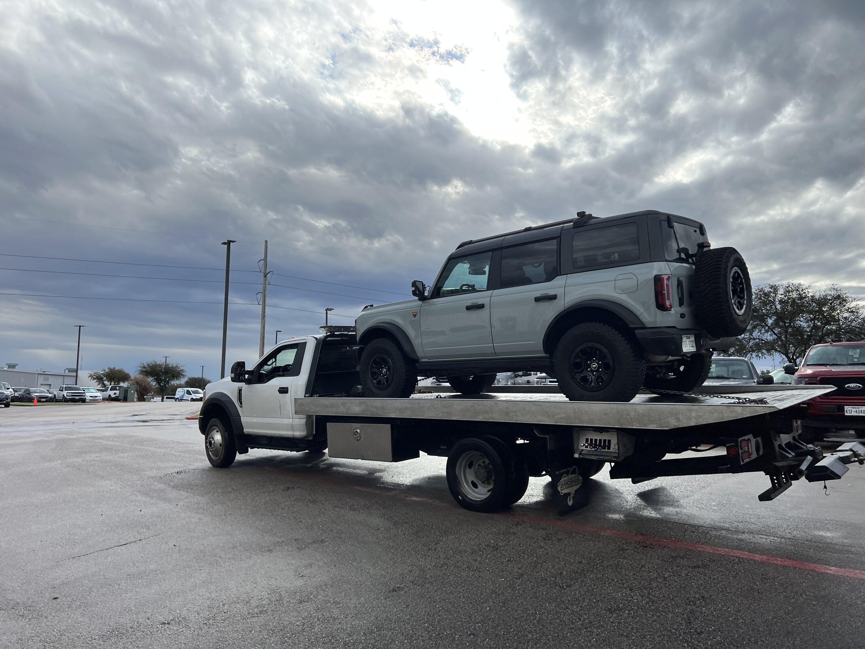

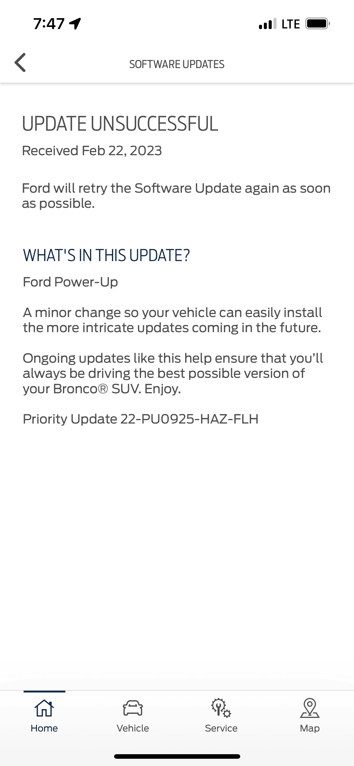

I woke up this morning to a ford pass notification that a software update failed and would try again at another date.

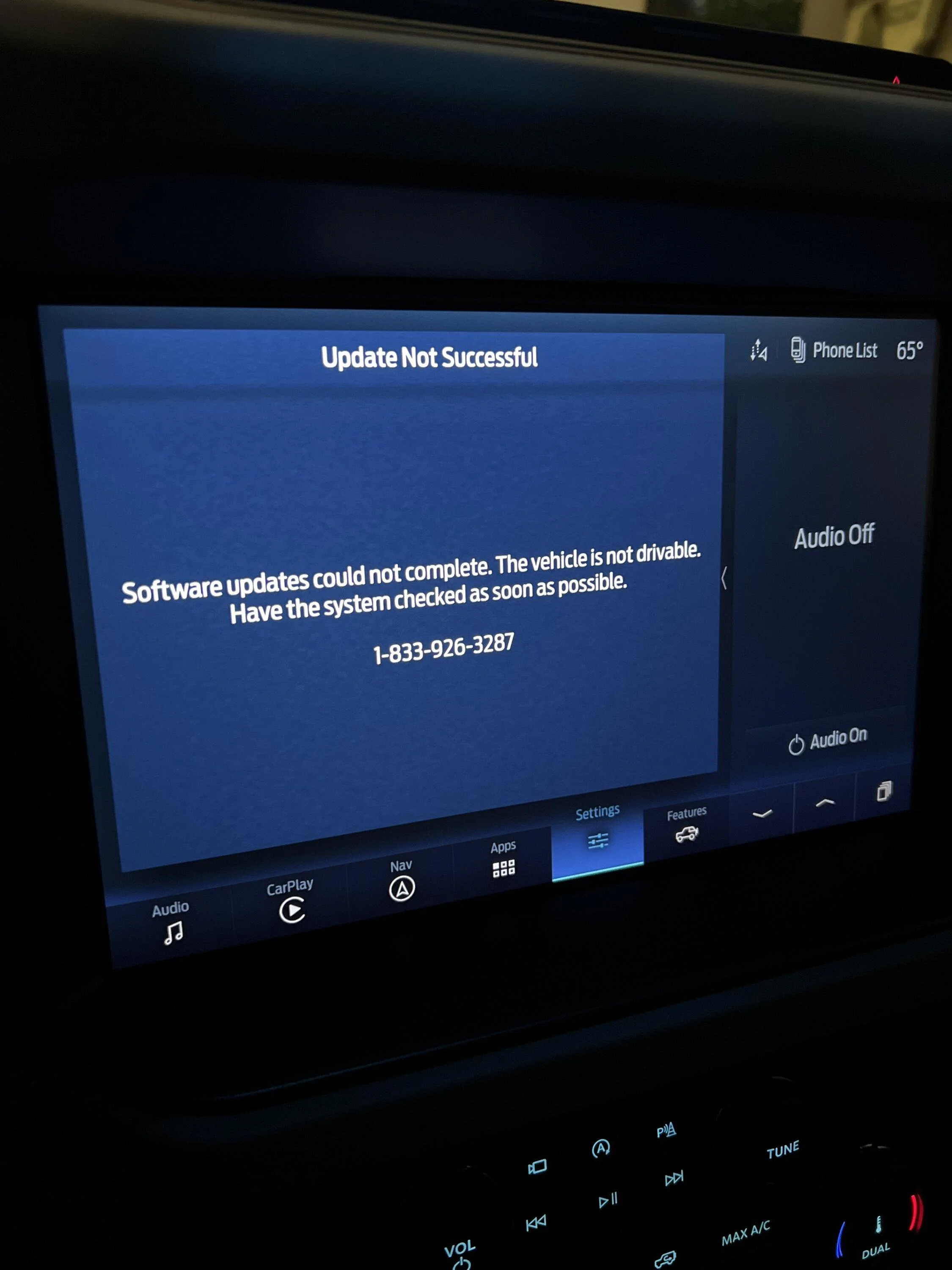

When I went to take my daughter to school the accessory mode would turn on but it will not start. The main screen now displays that the software update failed and is not driveable!
any ideas! The ford service techs still haven’t called me back
UPDATE: 8am the Ford customer service department is trying to get Ford roadside assistance is going to tow it to a dealer.
Update: 1030am towed to dealer and was told it may be next week before they can get to it. Ford said they will only reimburse me up to $45 per day for a rental even though the lowest rental price I can find is over $70 per day.
Update: 11am Ford In Vehicle Technology customer service rep recommendations to avoid this in the future, "A "Brick" could happen if the update is scheduled at or around 12am, you also need to have parking brake on with lights completely off and not in the auto setting. We recommend 1am for the update time. "
update2/23 10am:Update: dealer said the sync specialist can’t even get power to the vehicle so they are now having to troubleshoot that. I have no idea what that means. I got an app update that the vehicle is no longer connected to my account shortly beforehand.
Update: 2/25: they said they reset the computer and it works again. Doesn't seem to have the most recent update yet.
