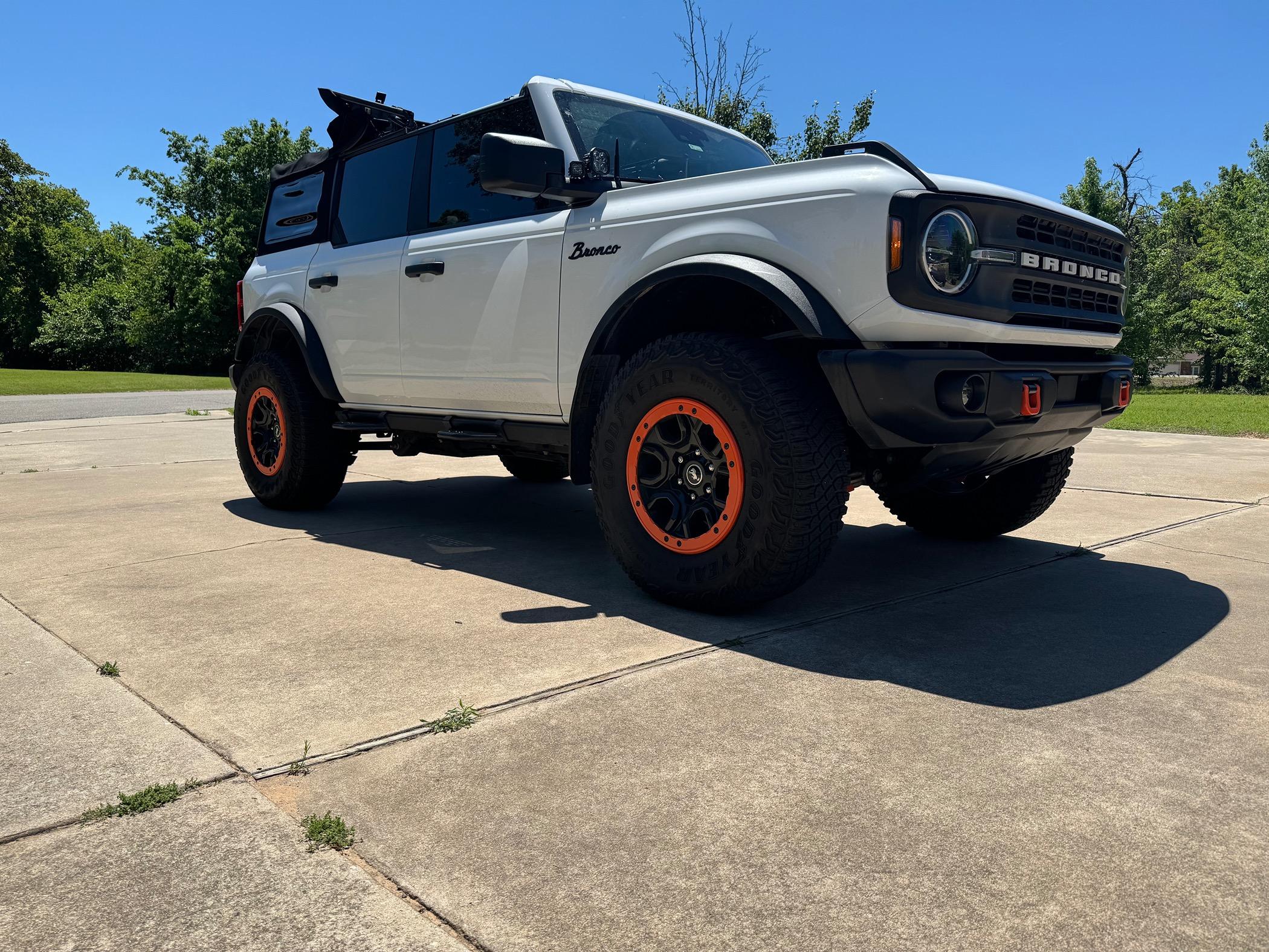

Have you looked into doing Bilsteins? I did the 5100’s on mine. Much better ride, lift I wanted, and bought Sasquatch take offs plus mine is a Black Diamond so essentially all I am missing to be the same as a Sasquatch is the front locker.
