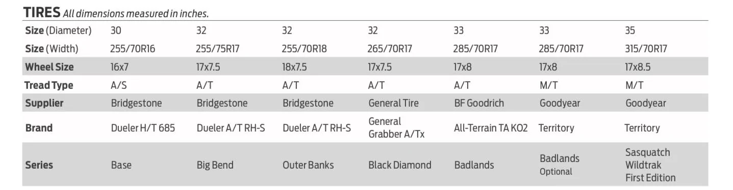

From tech specs the 35s are 17x8.5.
curious about offset and lug pattern so we can get our own “squatch” wheels aftermarket with a modest lift, and the wider fender flares
I'm not sure about the wider fender flares looking better or being better on the trail. I‘m thinking that 35s with the narrower flares may a) look better by making it more aggressive/appear wider and b) actually won’t get dinged as much on the trail as the tire will hit the obstacle first. So I’m definitely consider running the smaller flares - but have to have 35s.
