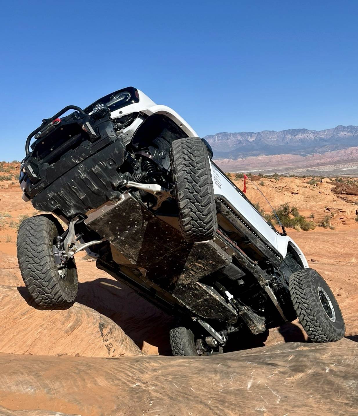

As a side note, I saw Next Venture is using your photo in their email blasts for Broncos... :clap:
I need to somehow convince them to do frame mounted sliders
