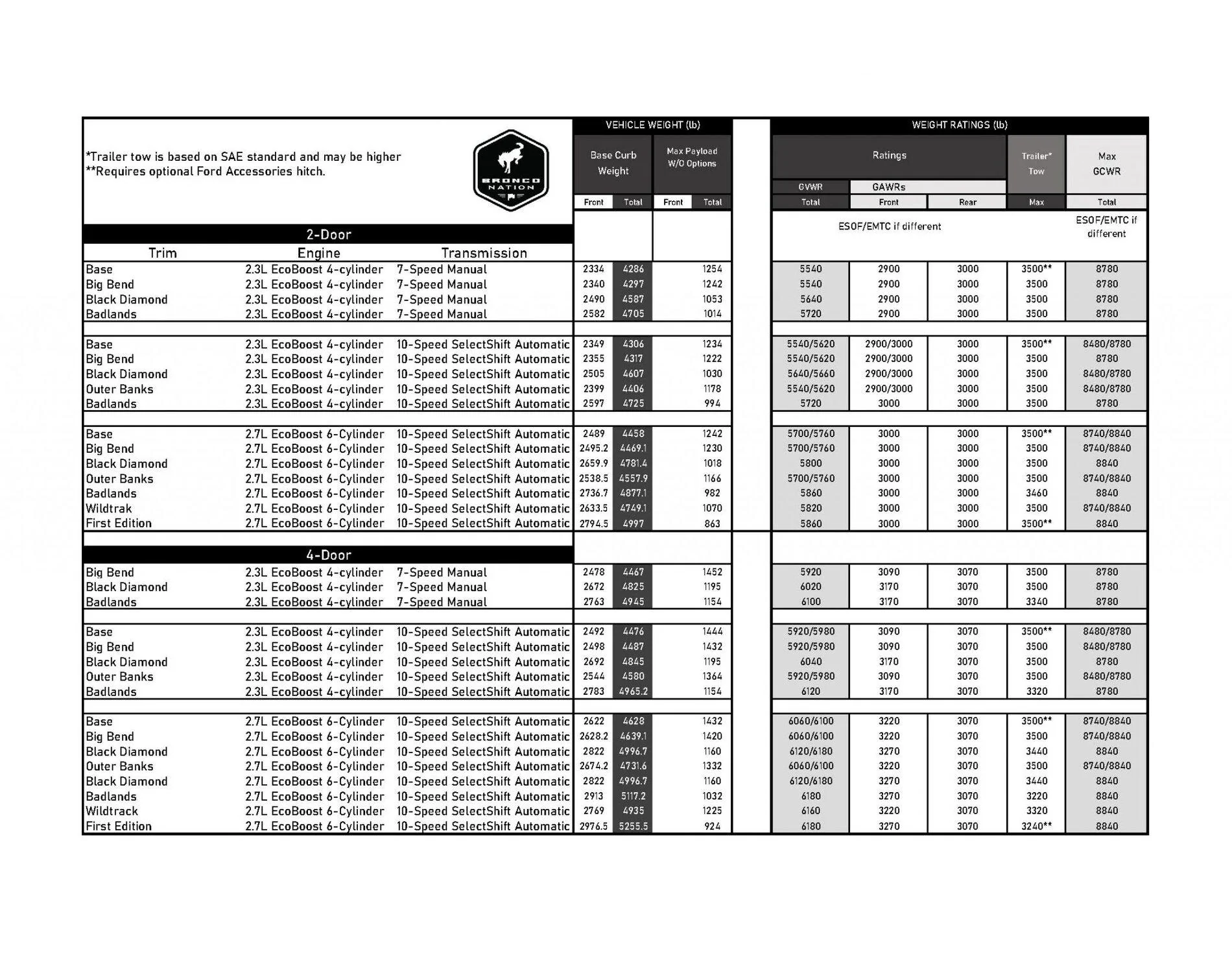

Ford Bronco First Edition Tow Package Screenshot_20210126-093100_Instagram

The 4 door FE still has 3440 towing capacity. Its just that you can't load a ton in the vehicle AND max out the trailer.
There are going to be a lot of people with Broncos that added a bunch of factory options surprised when they see their GVWR sticker when it comes to towing.
The 4 door FE is only marginally less capable than any other bronco at towing. Basically just enough so they didn't want to put the hitch as a factory option.

gross weight was too much apparently, between the standard hard top, bull bar, sasquatch, sound deadening headliner, it tipped it over the top apparently.
yes, that raises some pretty good questions, but it is what it is. If you want a tow package, buy the badlands, which can equip all the same things, plus the tow package. (originally you could not get the sound deadening with the tow package and 2.7L on the badlands, but now you can, go figure)
An FE without any options has about 924lbs remaining between curb weight and GVWR, so plenty of room for a tow package and 350lbs of hitch weight. GVWR should not be a factor. If it is though, I'd really like to see them give an actually good explanation why.
