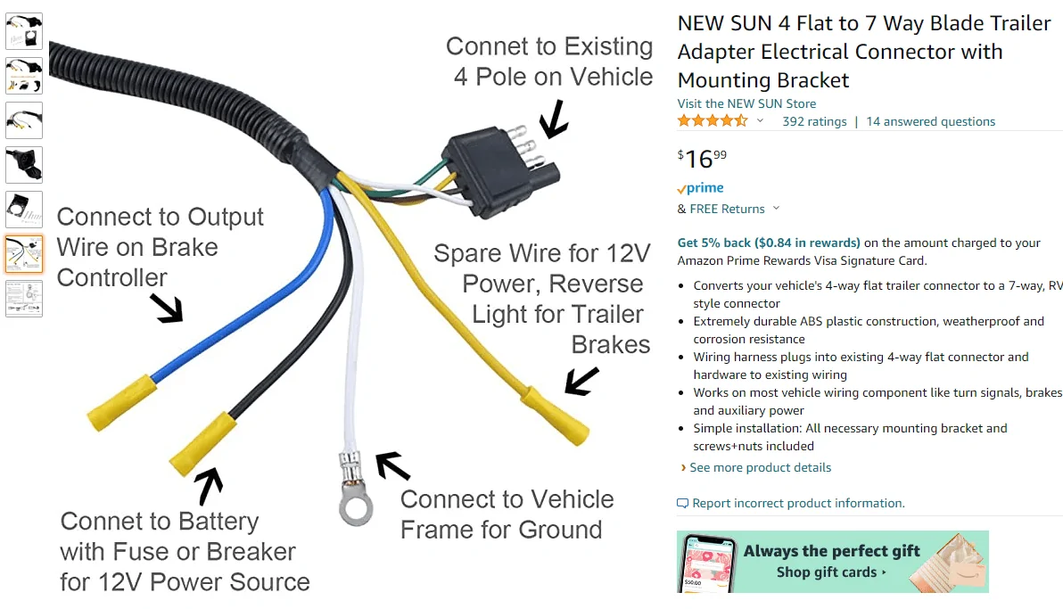

Well, I'm in NC...I did NOT know this was required......? I guess if that's accurate I was shirking the law this spring when I (stupidly) towed TWO pallets of sod with my FJ on a trailer with no brake control. (that was like 5000 pounds)
I didn't know either.....
and for the guy above asking if he needs the 7-pin, I am in the same boat and trying to simply rent a small trailer. I think 90% of them has a 7-pin connector and I looked for 3-4 hours last night. If you can find one now that doesn't that's great but having only a 4 pin is going to limit your selection in the future. I think I am going to go out and pickup something like this locally. I will not have a brake controller but I can add it later.
https://www.amazon.com/dp/B07CZFQRZ...=plJW8&ref_=sbx_be_s_sparkle_mcd_asin_0_title
Ford Bronco Tow Package? 1642866877725
NIce....another Charlotte guy....there's a lot of us...are you in the Carolina Club ? You already have your Bronco? Being an NC lawyer I should probably check this e-brake law, ha
