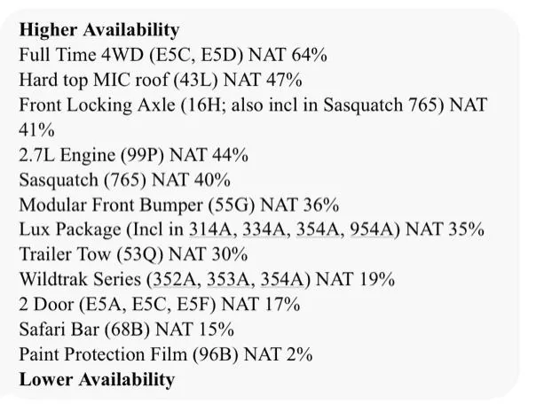

I’ve been a 7/14 res holder and have been bounced to a 22. Last Saturday my dealer called and said if you remove tow you’ll get your date quicker. Went in same day to do paperwork and remove tow package, got my build date Thursday. He doesn’t think it’s coincidence and neither do I. I don’t know why you need trailer brakes on a 3500# rated vehicle so I’ll opt for aftermarket 4 pin and be just fine. There is a shortage of chips for the 7 pin connector which is constraining the tow package. My advice, drop the tow.
Tow, 2 door, wild tram and PPF are constrained now.
Same here. Dropped the Tow…..and got picked up 1 week later!

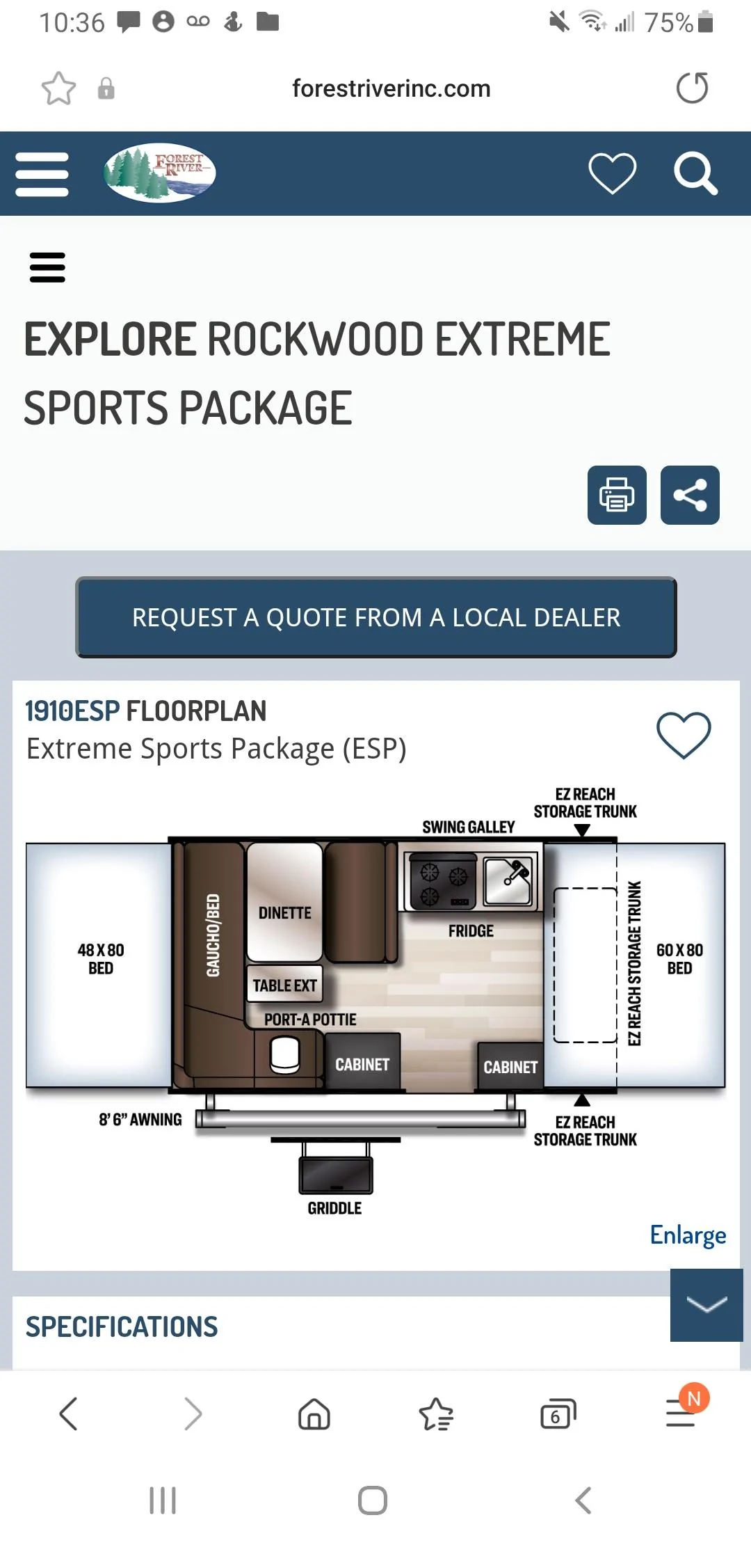

I have been contemplating dropping the tow package but...My ultimate plans for the tow package is to tow this popup camper. Its under 3000lbs. But from your post it sounds like it is recommended that I will need the 7 pin vs the 4 pin setup, right?
Most of Forest River campers come with electric brakes so they can make them 50-state compatible.
That doesn't necessarily mean you need the tow package or a brake controller though. Depends on what states you intend on traveling through and where you intend on camping. If you aren't going too far off the beaten path, then you don't need trailer brakes. If you intend on hitting the public lands out west and are on traveling on back-country roads that aren't maintained by the Forest Service or BLM, then yeah... it'll be helpful.

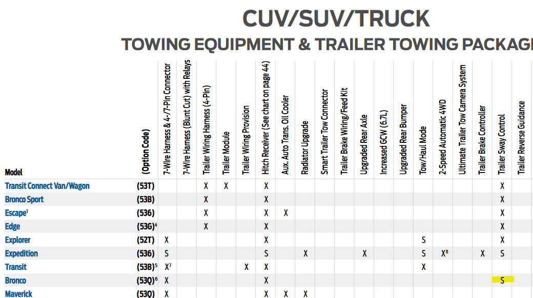

You only get trailer sway control with the tow package. If your planning to pull a small camper or something else with high walls you should consider this as well as the need for a 7 pin.
Seems to be some confusion around that, and admittedly I don't know the actual answer. I know on the Ranger you did not need the tow package to get trailer sway control, but I don't know if that's true for the Bronco.
I would be awesome if someone with a MY2022 who DOESN'T have the tow package could confirm that for us.
According to Ford's order guide the sway control is part of the Base safety package.
It's also listed as a standard option on Ford's 2022 towing guide:
No, there is zero confusion about it. It’s not there unless you have the factory tow package. Show me a Bronco without the tow package that has the towing menu. Its not there. The forscan guys haven’t found a way to enable it because the self sense module isn’t there to enable towing features, disable proximity sensors, modify BLIS, etc.
