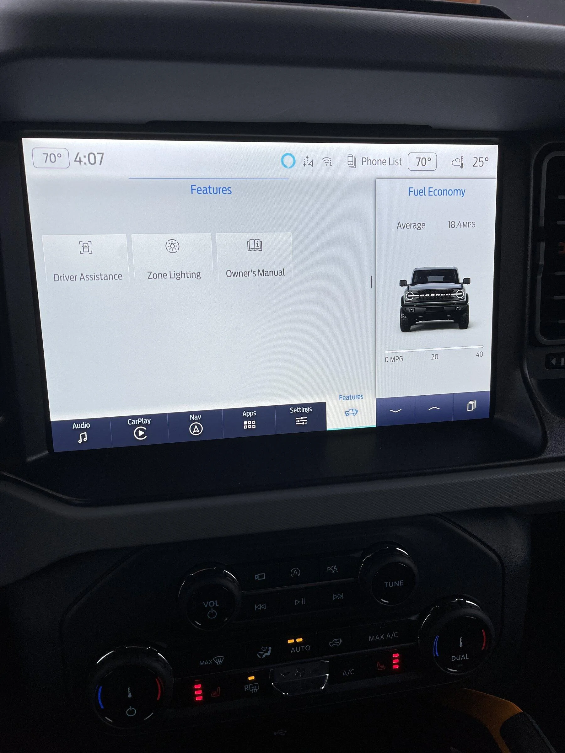

No, there is zero confusion about it. It’s not there unless you have the factory tow package. Show me a Bronco without the tow package that has the towing menu. Its not there. The forscan guys haven’t found a way to enable it because the self sense module isn’t there to enable towing features, disable proximity sensors, modify BLIS, etc.

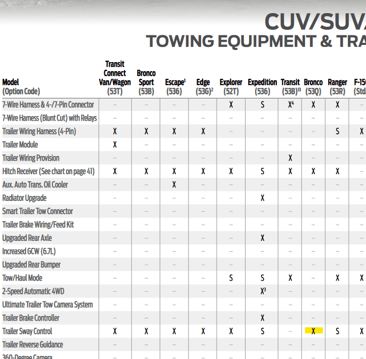

Is that true for 2022 as well??
On the 2021 tow guide the trailer sway control is listed as an optional upgrade and not a standard feature. But for 2022 it is listed as a standard feature.
Yup, confirmed for 2022 as well. No trailer sway control without the tow package.
I wouldn't be so sure about that, just because the lack of the towing package doesn't give you an option to turn it on or off does not mean that it's not there, on F150's it's default is on all the time whether you have a trailer hooked up or not (though you do have an option to turn it off). Until someone actually confirms it there is not "zero confusion". Even if it doesn't have it the stability control is going to pretty much do the same thing as sway control (it already has the sensors because stability control needs them).

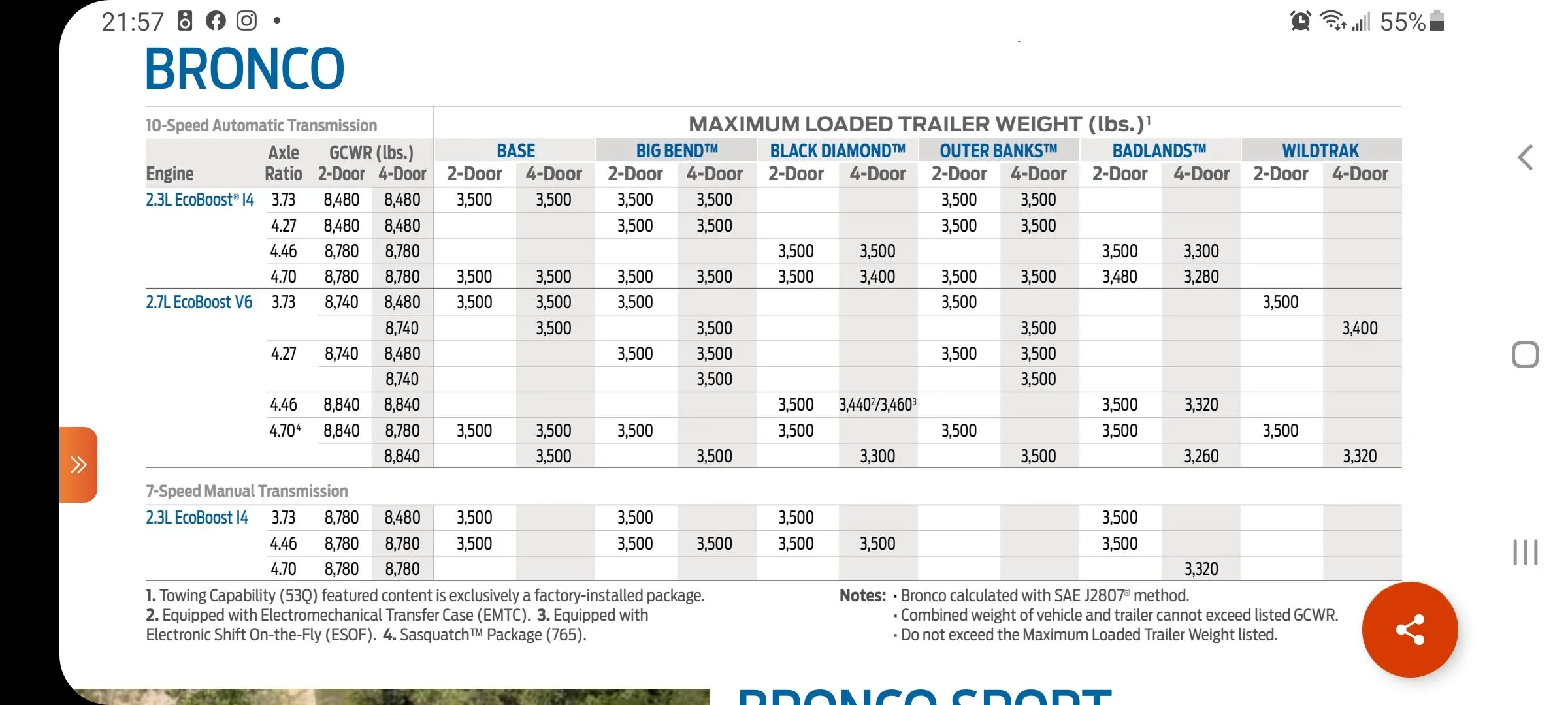

Keep in mind that the current version (Nov 29) of the guide on the US site (there's nothing for FOC yet) has some errors for the Bronco, so that could be one as well. See if you can pick out the issues in the table below:
Oh wow, I didn't even read that table before.
I could understand missing an option here and there, or having a typo in a few spots. But they got multiple configurations that aren't even build-able on this spreadsheet. At some point they should let the community proof-read their documentation before they publish it.
I have not been able to play around with a Bronco with the tow package, but is that menu there with no trailer attached? I was curious if the Trailer Module would sense the trailer and activate that menu. I have been able to program a TRM into a Bronco without the factory towing package using Forscan, but will most likely need to activate something in several other modules to get it all to work. I do know that simply adding the TRM into the network does not activate this menu.
Correct, Trailer sway will not activate without sensing a trailer connected.
Thank for that confirmation! Saves me from turning on a bunch of stuff in the APIM, hoping to find the menu. Lol. I will try connecting a trailer once the wiring portion is done and see if I get the menu.
