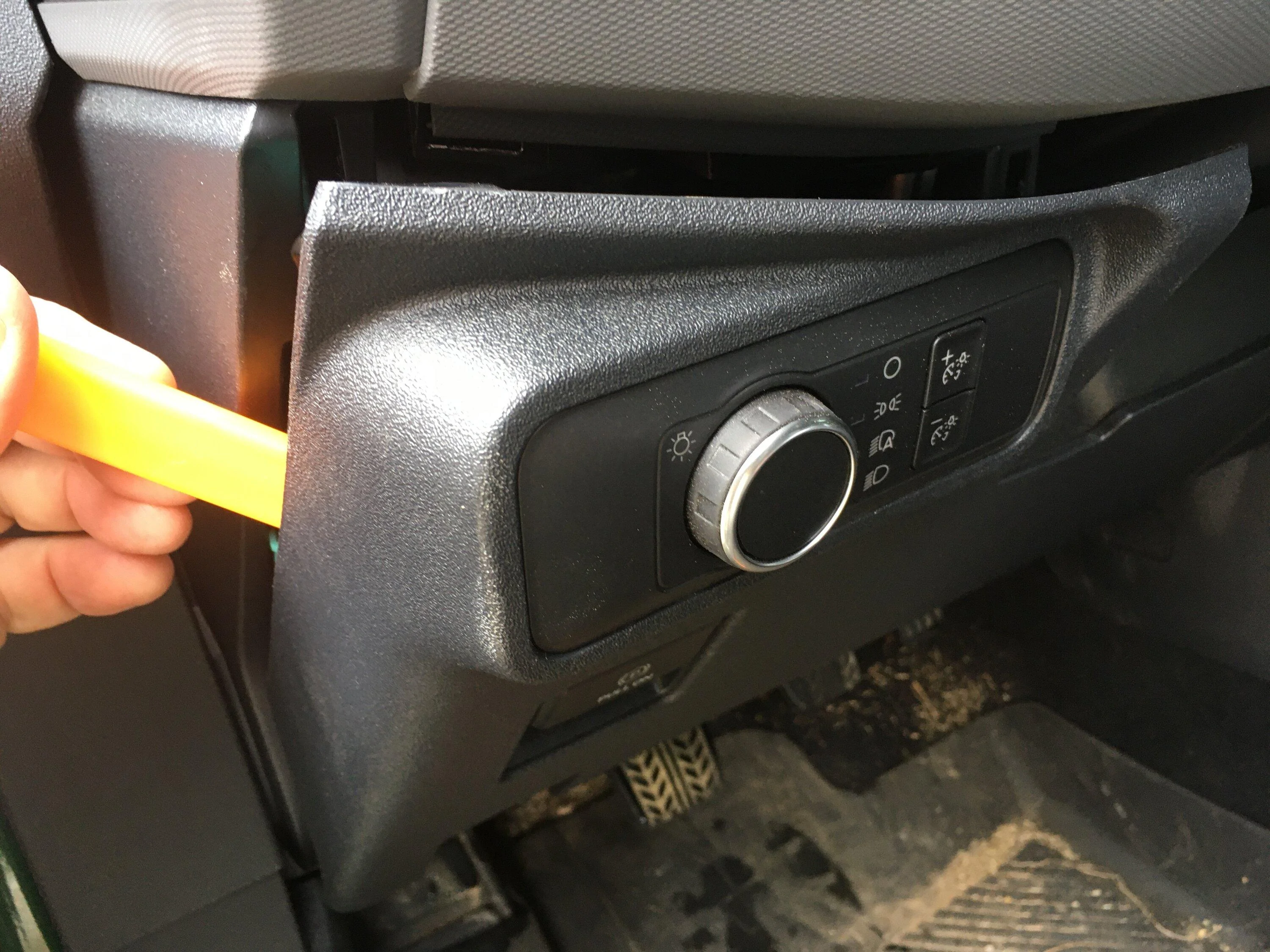

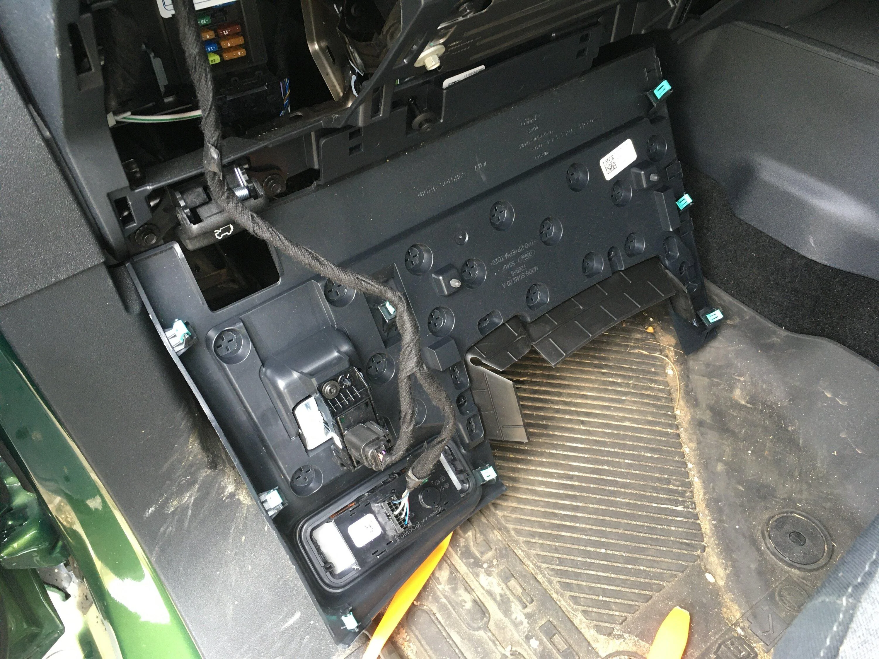

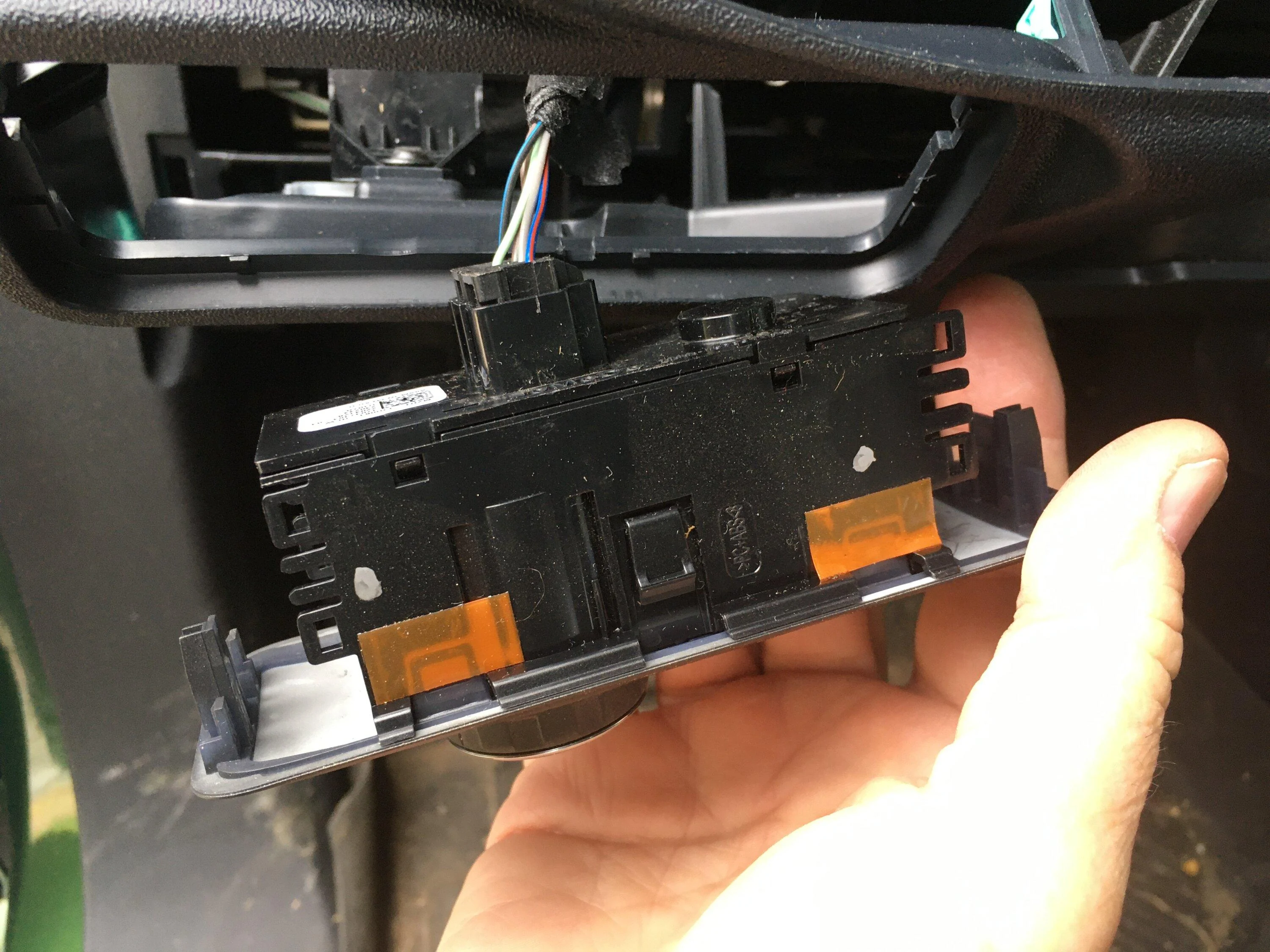

My replacement switch finally arrived after a long back order wait. The order was Ford part number M2DZ-11654-GC.
I performed the swap myself and it was really easy. I used a couple of flat plastic trim tools to pry off the upper left portion of the panel first. Next, I pulled the rest of the top of the panel off. It hinges at the bottom. The switch pops off easily and the connector is also easy to remove. After connecting and installing the new part simply lift trim panel into place and push to engage clips. Done.
A road test showed no uncommanded light mode changes (other than the ”normal?” default to auto after start). Now I have to see if my wife or daughter occasionally tell me “your Bronco lights are on!”. Usually after I have my jammies on and it’s raining.
