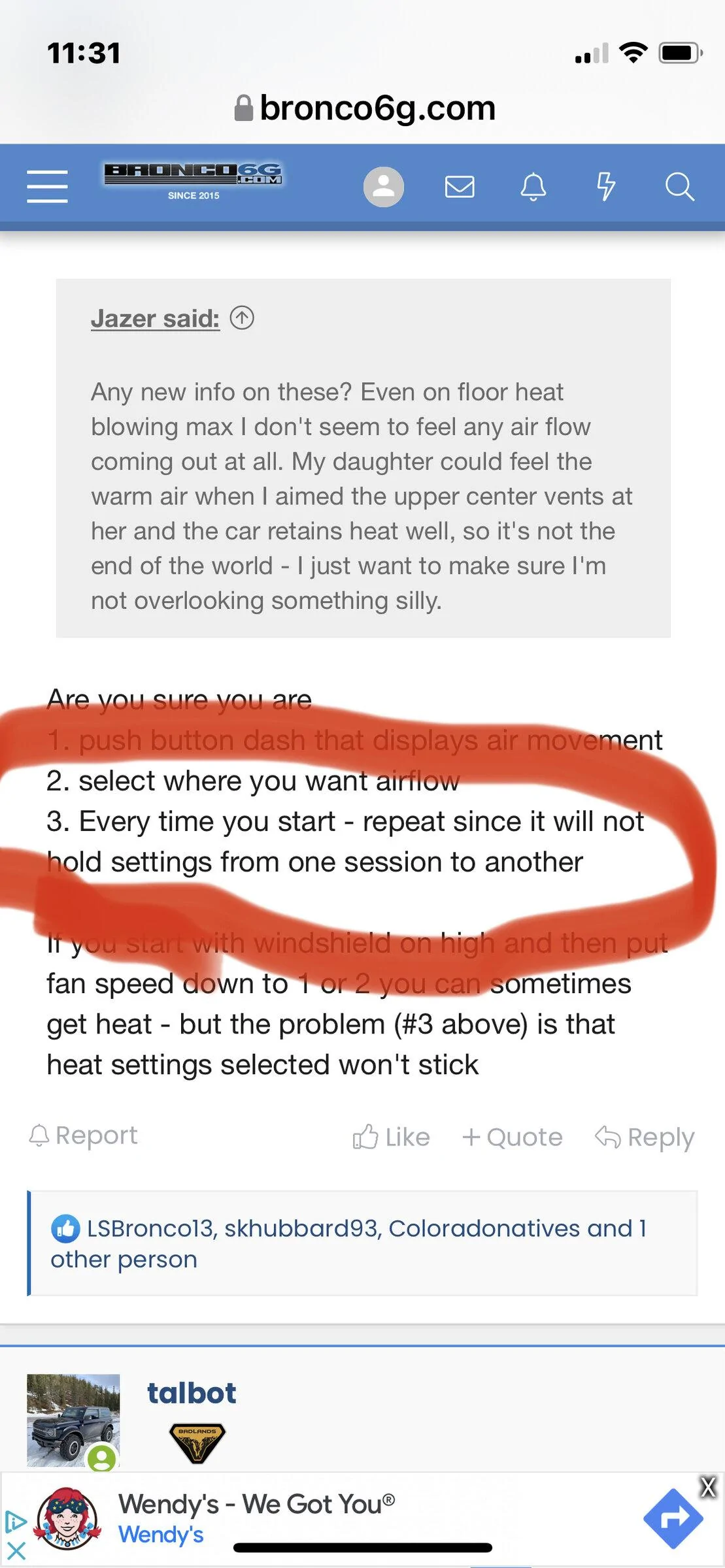

This makes no sense but I have noticed it too. Why the heck wouldn’t it remember where I set it?
