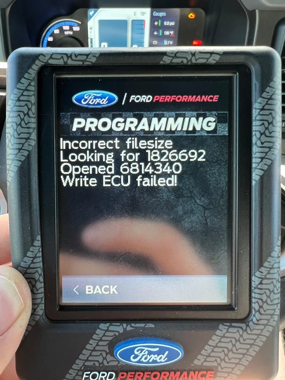

After successfully doing rack upgrade and program with the procal with a week of tech supports help back and forth and an updated file, I’m getting an incorrect filesize error when trying to load the performance tune to the bronco. Tech support has responded to 1 or 2 emails I sent this week but nothing the past few days. Anyone else deal with this “incorrect filesize” error?

Have you tried deleting it and redownloading?

I’ve tried everything including changing most of the changes I had made on forscan back and forth deleting the tune file off the procal etc
