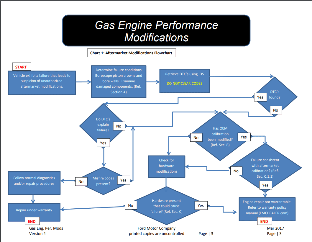

Are you saying this by experience ? Just saying " Hey Believe me" and not backing it up, is kind of moot...
Good friend is an Authorized Tech. Here's a GSB
Ford Bronco Forscan unlocks all GOAT modes with any Bronco model trim! How-to DIY instructions 1637084340108
This does not exist to benefit the buyer.
Will it result 100% in a warranty denial? No, but it will 100% in a fight for it.
Everyone has differing levels of desire to deal with the hassle. They will check, and they will see its been changed and they will argue over it.
Is Ford logging the drive mode you are in all the time as well? How does Ford prove that the component broke while you were in an "unauthorized" mode, as opposed to one of the ones allowed for your model. There is a lot more complexity to these systems than you may appreciate. Per D2hanover:
This mod isnt programming sport mode into "the ECU" (really there are so many modules controlling so many different functions). It is better thought of as turning on the menu item in the Dashboard User Interface. This allows you to ask the car to go into sport mode. Similar to how if you view the source of a web page you can tell your web browser to show you "invisible" elements. You didn't hack anything. You had it display something that was already there.
It seems like for Ford the burden of proving that your modification caused the issue would be extremely high given that this exists on many other trims in the same lineup. Would changing the screen background cause a warranty denial? Changing the colors of the UI?
No it's not logged constantly, but when an error is thrown (which more than likely would if something broke) it will be. Sport will have a different mapping for various control systems, which your vehicle would otherwise not have enabled.
No changing other stuff will not void your warranty, it has nothing to do with drive components.
If you guys think Ford will take no issue with this and approve warranty claims with 0 issue, you have not dealt with them before.
I encourage everyone have the most fun with their vehicle they can possibly have. I'm just trying to let everyone know this is not a risk free change. You run a very real risk of a big hassle for some modes. If you're okay with that, great enjoy!

Show me when and where this modification changes PCM and ECM settings.
The PCM controls the drive modes... Which you have to change to get the modes not available to you. Sport mode has a different ECU map than Normal.
The log files will show you enabled it and if you get a code, it will log the mode you were in at the time.
hozer
Dec 18, 2020
481
1,263
Calgary
Suburban
The PCM does not control the drive modes. The ABS controls the drive modes. Also the tune doesn’t change there is no “extra power” in SDM’s just increased/decreased pedal input translation, steering firmness or softness and shift point adjustments. No calibrations are made or altered ever.
I am a calibrations engineer at Ford. Please stop assuming that because your friend is a tech you can answer these questions.
Then you'll have no problem handling with your dealer, others may not be as lucky.
