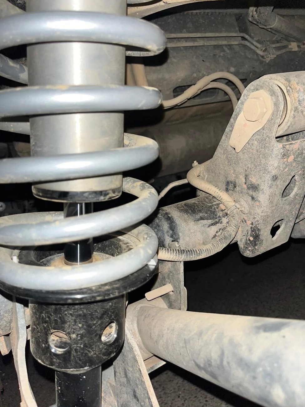

Have 1 inch of travel between rod end of cylinder body and bump stop.
sounds about right on the stock springs. I maxed out the preload on the new 250lb Eibachs and have closer to 2ā€ travel to bumps (unloaded & topless).

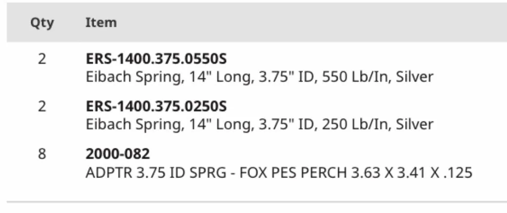

I have Eibach springs / Fox coils in my 2Door. Sounds like they’re the same as discussed above. Before the suspension swap my Bronco weighted 5440 lbs with a full tank.
These are the PN’s for the springs in my shocks - purchased from Accutune. I highly recommend working with Accutune.
Appreciate the visual 2pump. I have been thinking they made the body of the Cyl too long or the spring is too long.

@TwoPumpChump The list of springs above were purchased from us, so let us know if you have questions about which rates to go with. The spring rates you need will vary depending on how much weight you have on your Bronco.

The Eibach spring PN#s I posted above were recommended to me by Accutune based on my trucks weight plus my plans to install the TOR HD tailgate & tire carrier plus camping gear. TBD on the camping gear load performance but so far this suspension is šŸ‘
