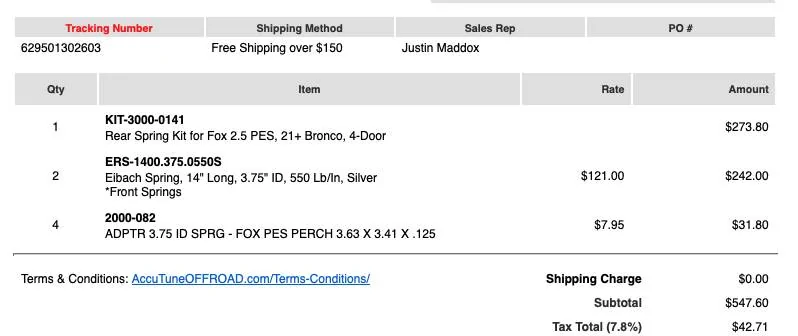

If anyone has questions I highly recommend working with Accutune. My case was atypical and I only ordered springs and adaptors from Accutune.
if I did it again I would have just purchased everything from Accutune,
Including their custom tune.
I've been working with Accutune this last week and I'm hoping what they recommend isn't too stiff and will get my height and ride sorted out. They have been good and responsive to work with.(y)

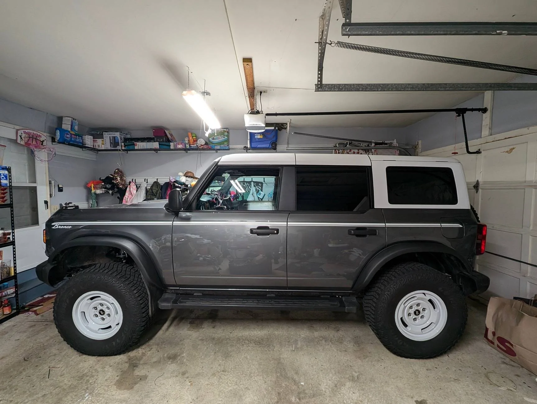

Have the same problem
Ford Bronco Fox 2.5 DSC Heavy Spring Advice PXL_20241004_144004293
Spoke to fox about it over email, they believed the rear had the wrong preload set and that I should add more preload.
Picked up a set of spring compressors at harbor freight and even though doing this made me quite nervous, it was rather easy. I didn't remove the wheels and raise up the rear enough to fit the clamps then tighten by hand, lowered the rear a bit, tighten clamps again by hand, until I felt I had enough compression. Then raised the rear up again until spring came loose.
After loosening the set screw enough I was able to spin the preload by hand. I did this until it was nearly maxed out.
This is the result

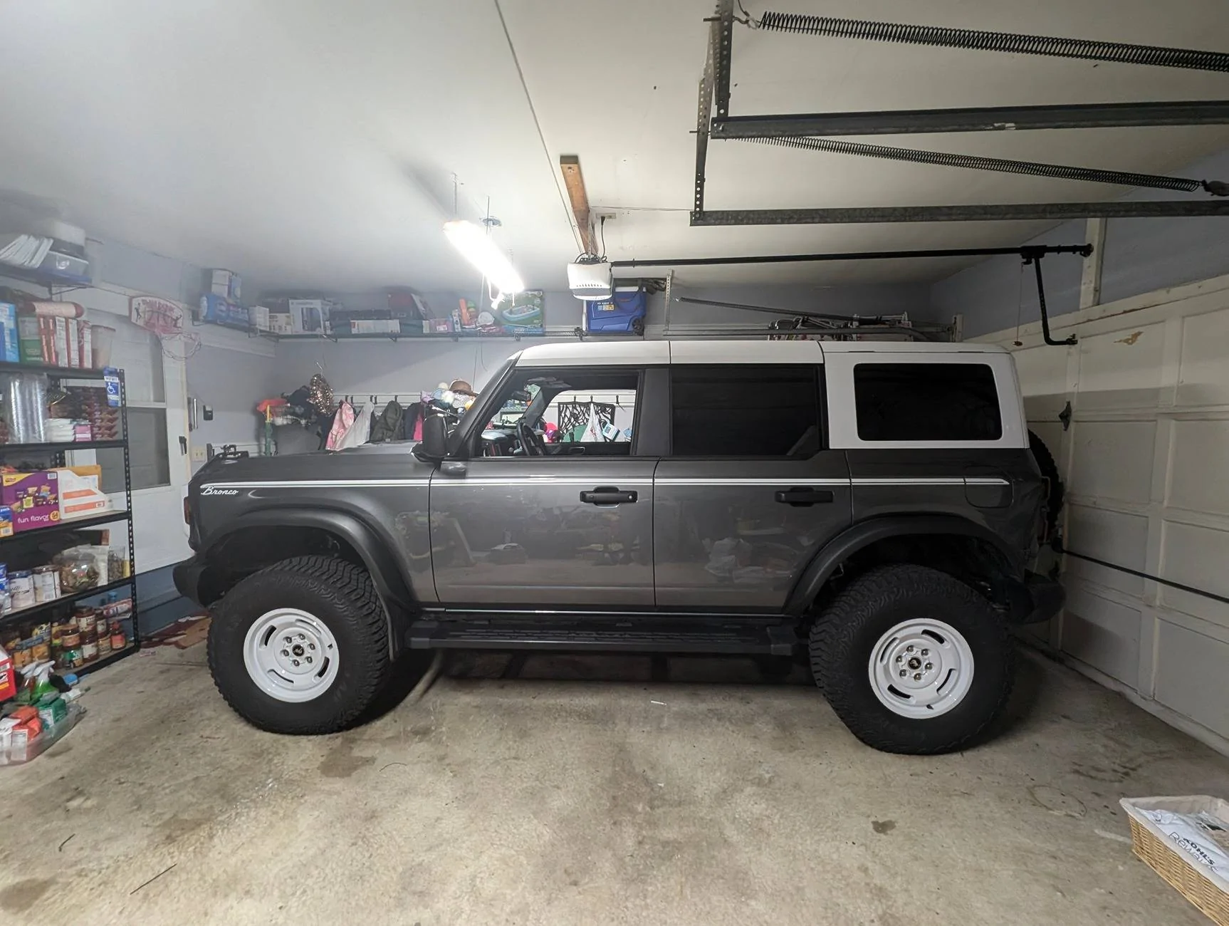

Ford Bronco Fox 2.5 DSC Heavy Spring Advice PXL_20241007_021620399
only about 1/4in difference now (best I can do being a newb)
I also want to mention that Fox told me that there was no upgraded spring available nor "any planned to my knowledge" (their words)
Satisfied for now, but any concerns running max preload on the rears?

This Accutune set up worked perfect for me.

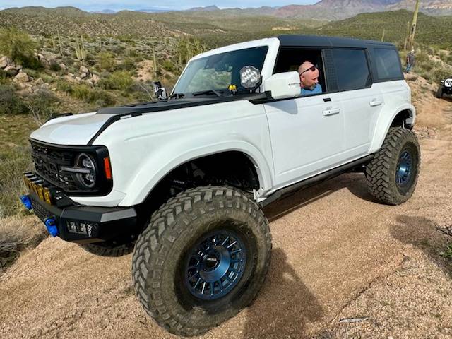

did you have to adjust the preload?
Pre-load is adjusted but I do not have it cranked down. It rides much better with higher spring rates because it's not cranked. I do have the high speed adjustment turned up because I do not use sway bars, I have Antirocks front and rear. My Fox shocks were VERY soft from the factory, Accutune got me dialed in.

If you call Accutune and let them know what you have and what you are adding, they will get you the correct springs. It's not a one-size-fits-all situation; it depends on your weight in the front and rear. It's worth a free call to them; they are the experts. My rig rides excellent on the street and off-road, I could not be happier for how little I spent with them.
