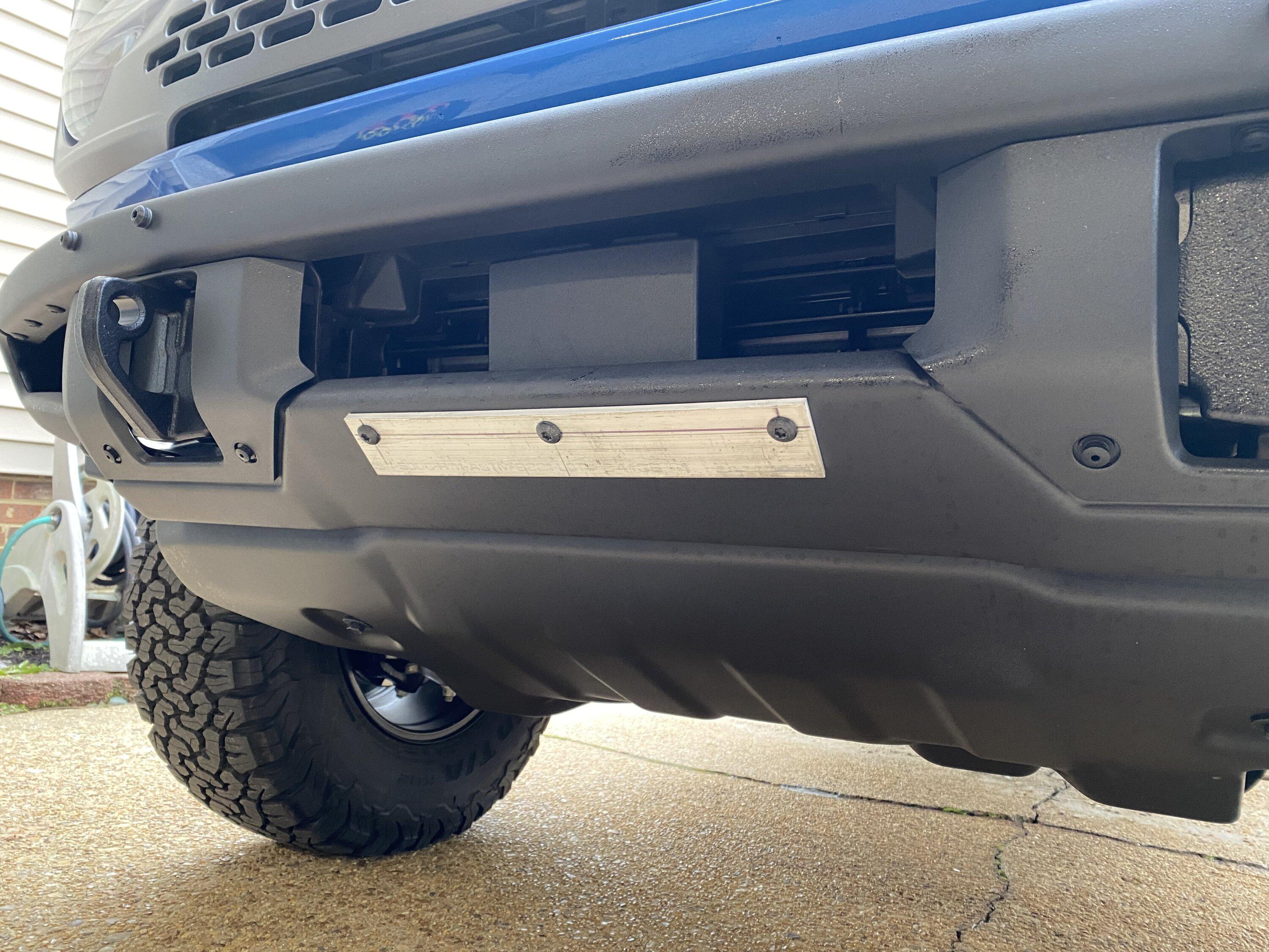

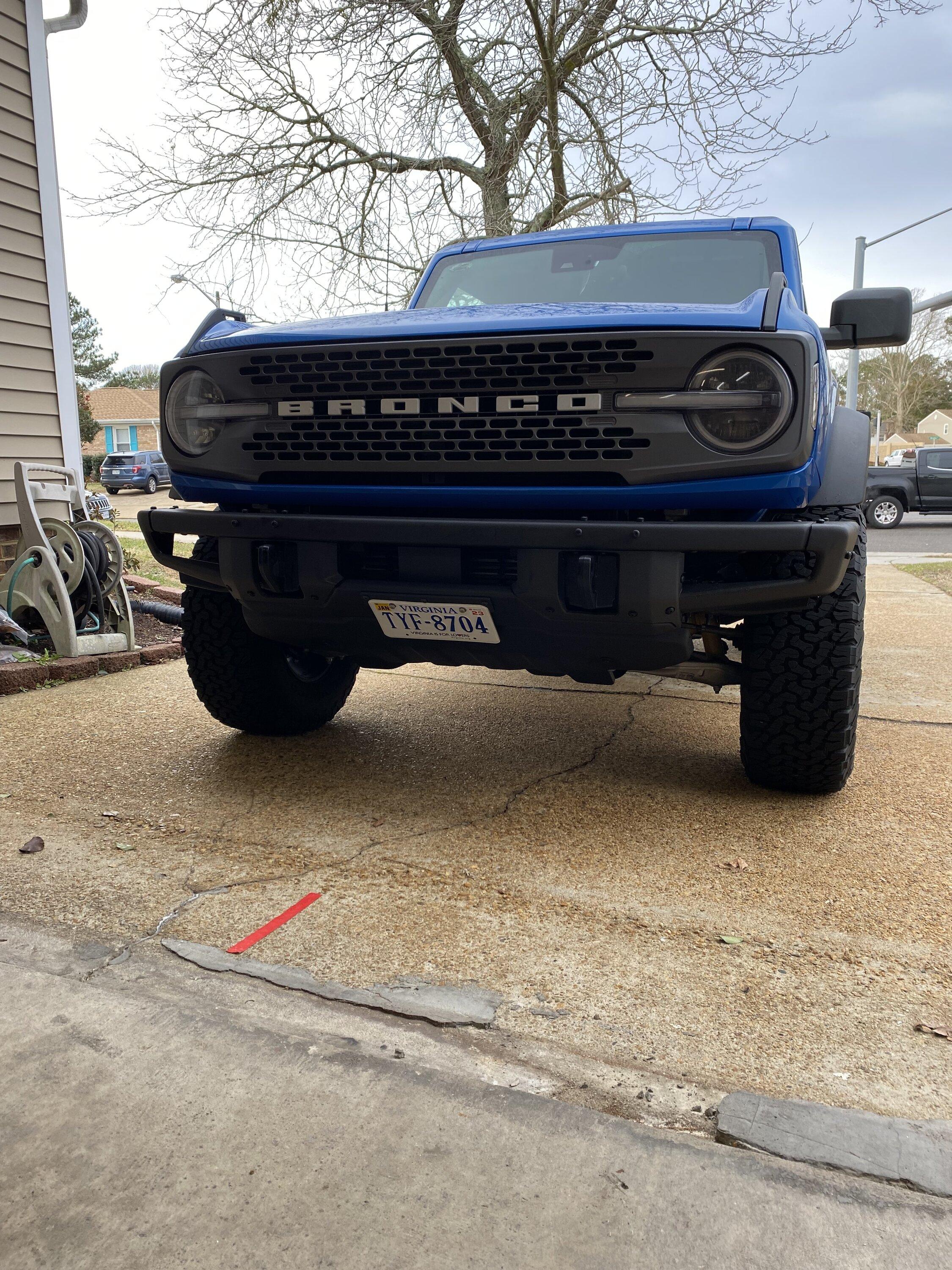

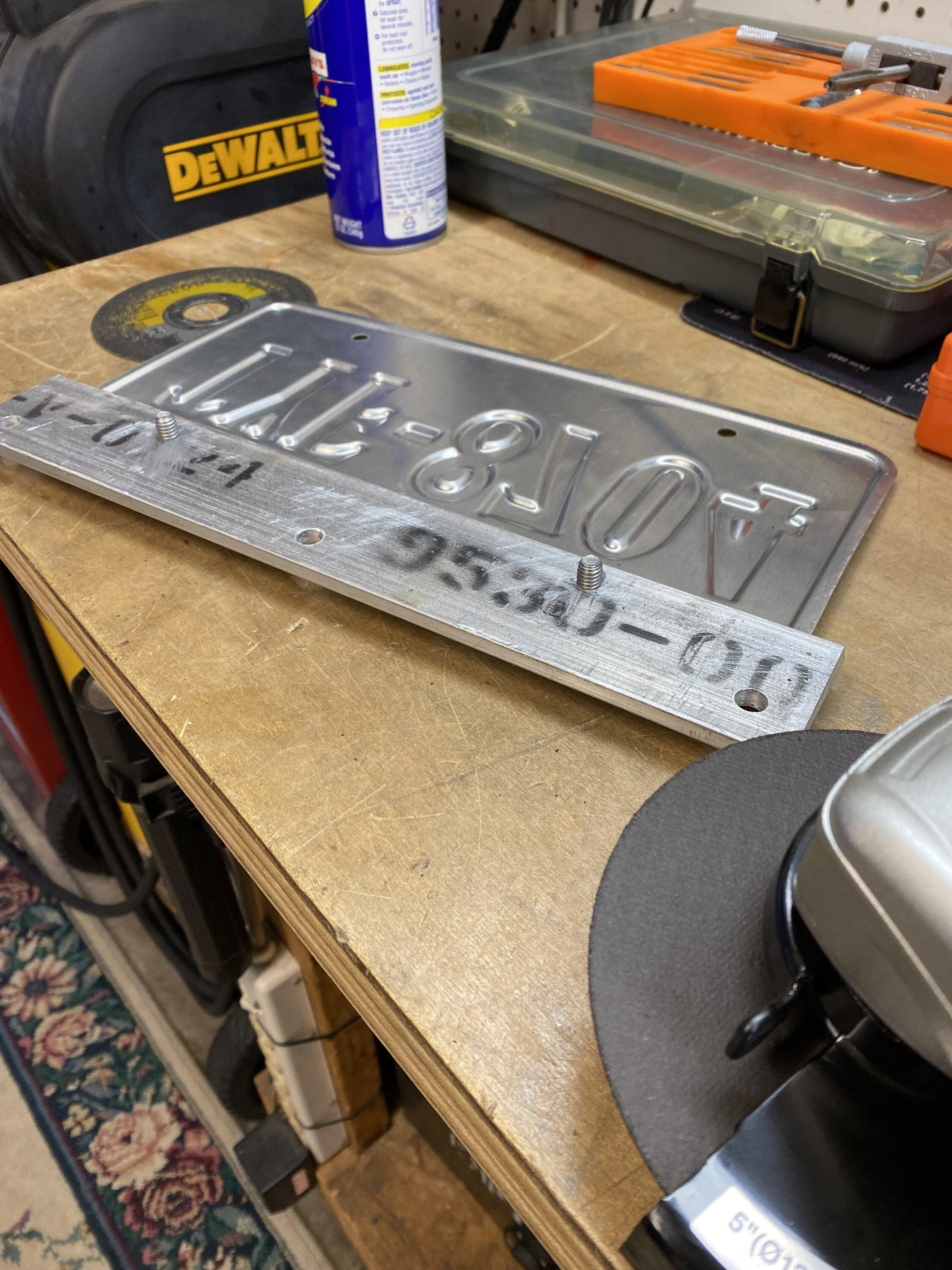

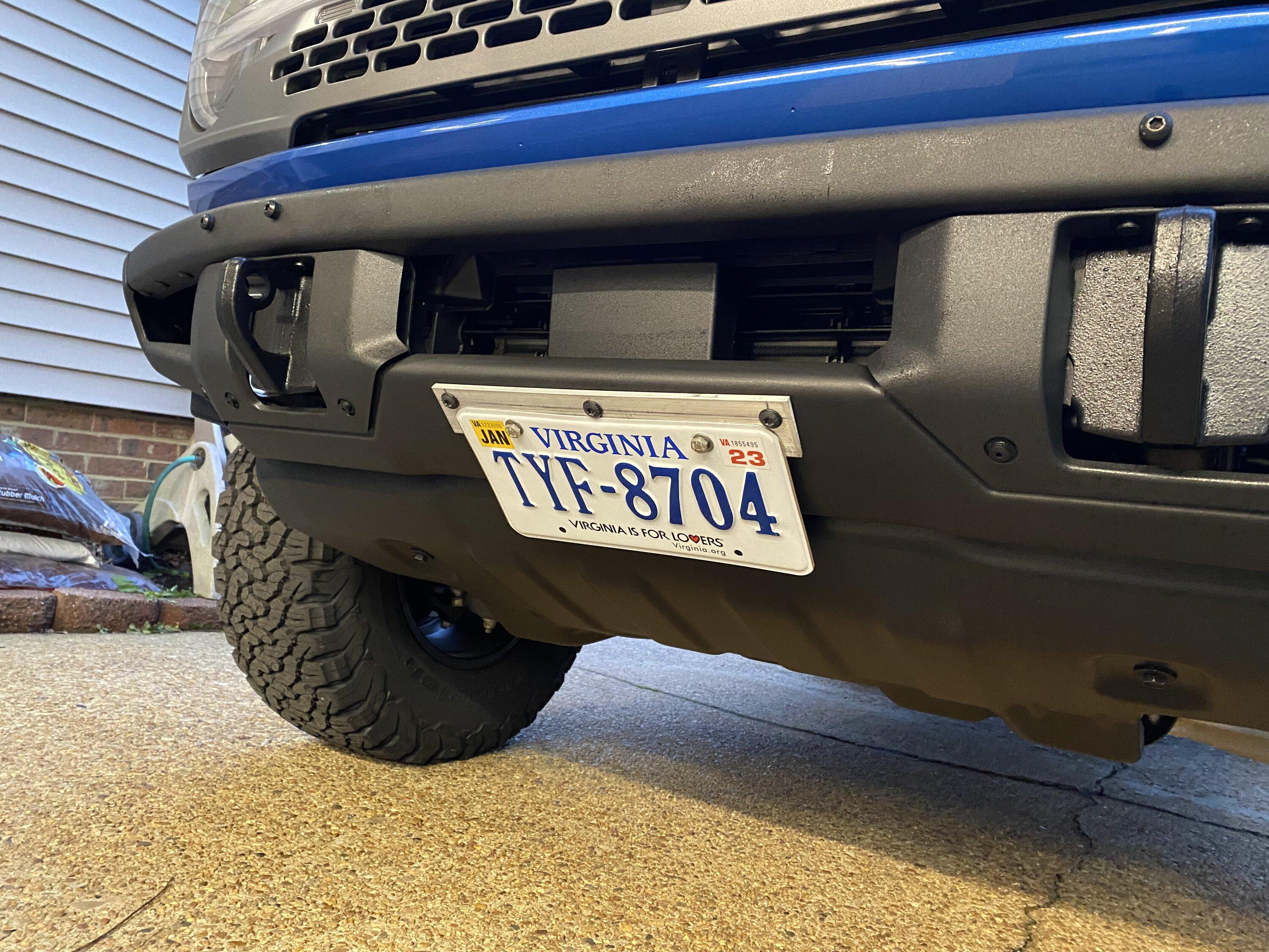

Made my own out of a piece of AL. Drilled 3 holes for mounting to the bumper and two threaded holes for mounting the plate, some black paint and it disappears. Used the existing fasteners for the bumper, super easy.

Looks like that is tucked out of the way from being knocked off. Great Job

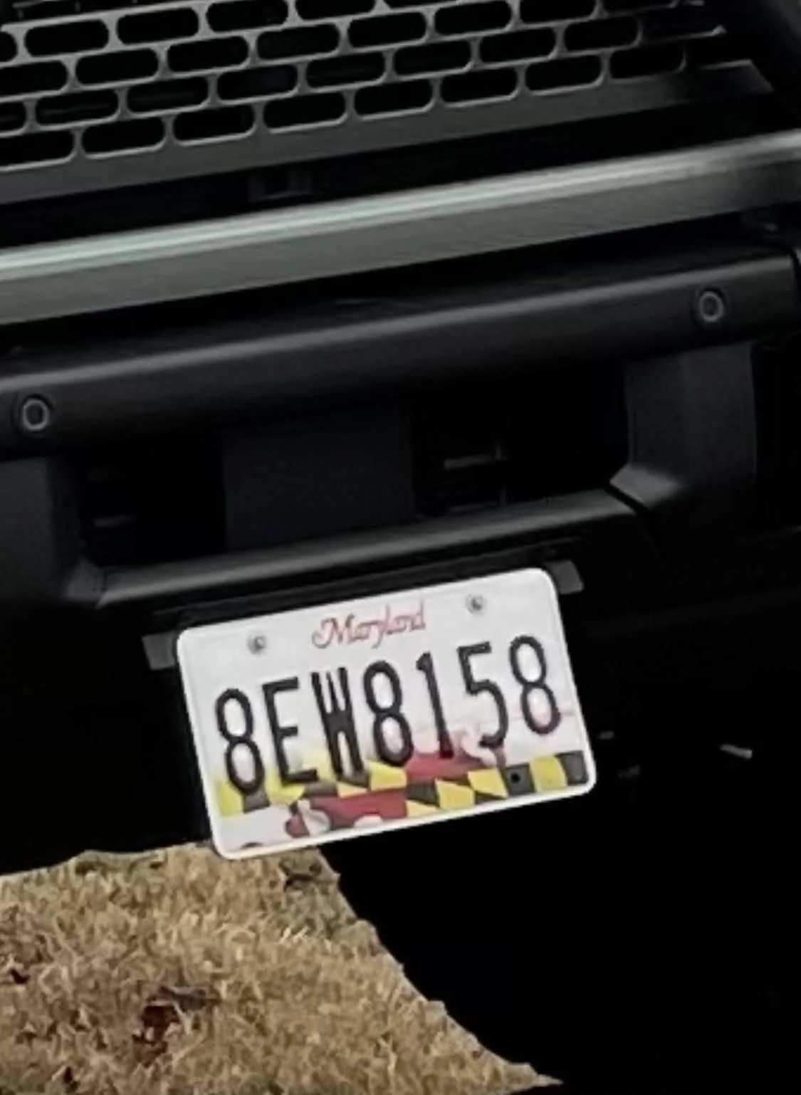

Took a piece of cheap angle aluminum, drilled a couple of holes, painted it black and mounted it. No reason to spend $50 on one.
Best pic I can get for now.

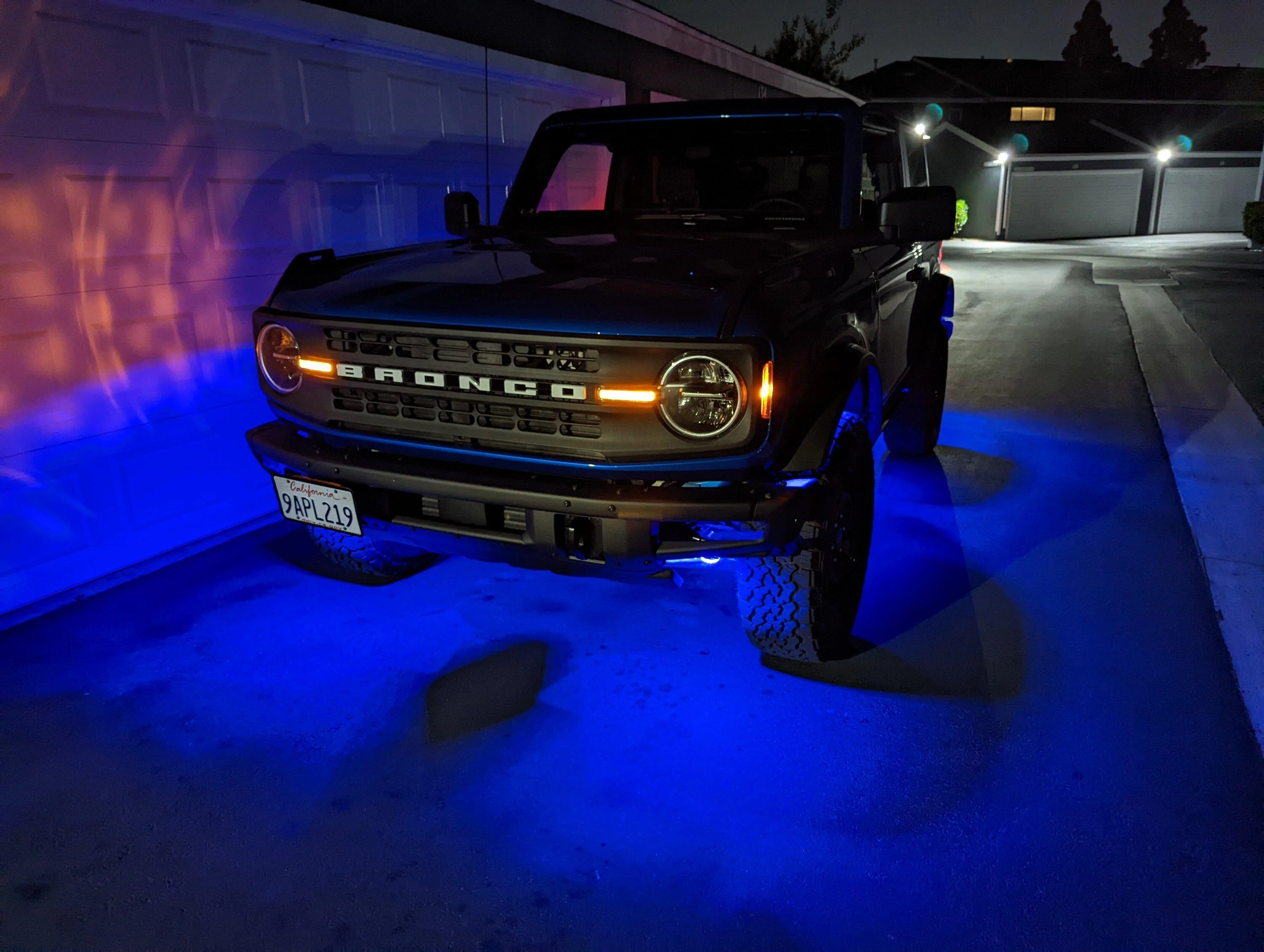

I've got the KR Off-road bracket and recommend it.
Uses factory bolts (in the HD Modular bumper), sits below the ACC and intercooler, and the bolts are still exposed so it can be quickly removed on the trail of needed.
