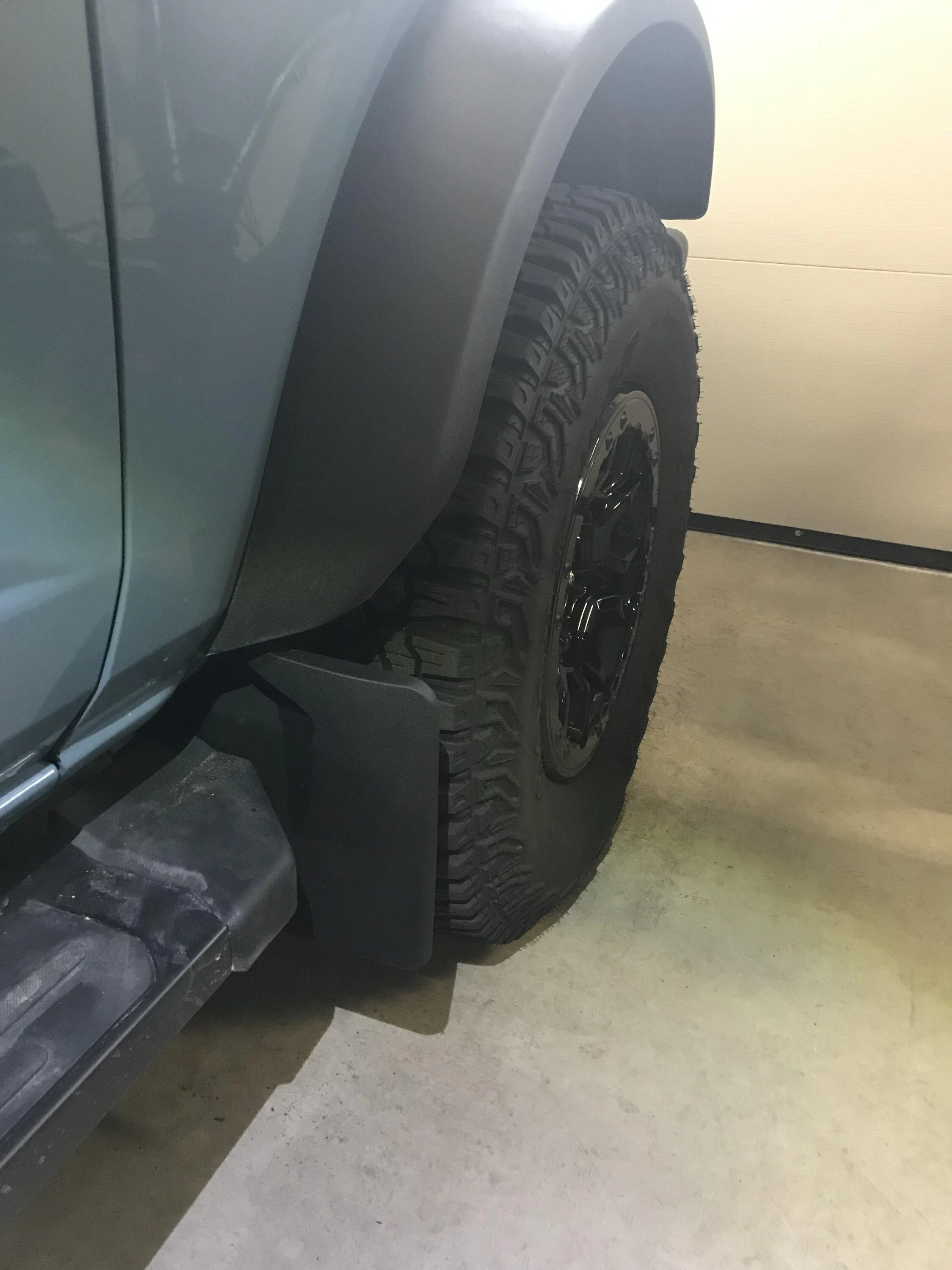

Roger that. I’ve been smashing my head on the wall trying to figure this out. Read some people where flipping the brackets too. 🤔.
1 last question, Did you tap the drilled holes or made the space for the U-Nut?
This is what I did. Like others just moved the running boards back, and out a little. Not to hard.
Great video! I drilled 9mm holes and inserted rivet nuts to reposition my side steps. Unfortunately, I had to move them back 2-plus inches due to clear the rectangular slots. I also wanted to move them out, but I didn't! Its a joke that Ford didn't realize that the side steps were too much under the body, which only allows only your heel, and barely, when exiting the Bronco!

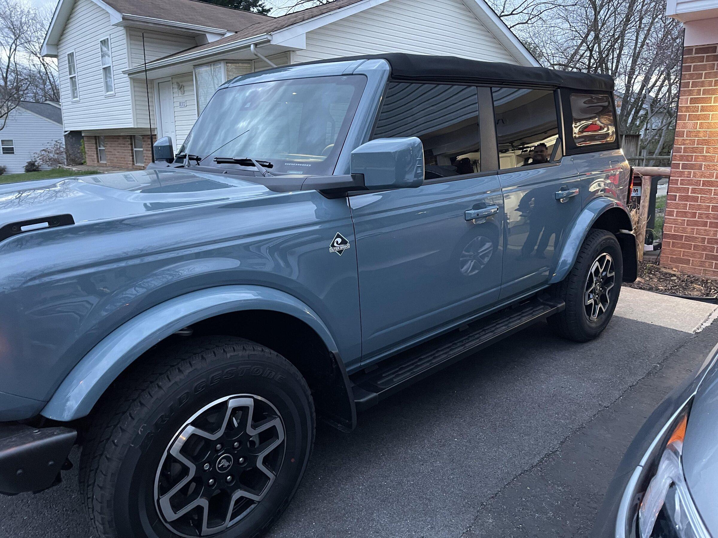

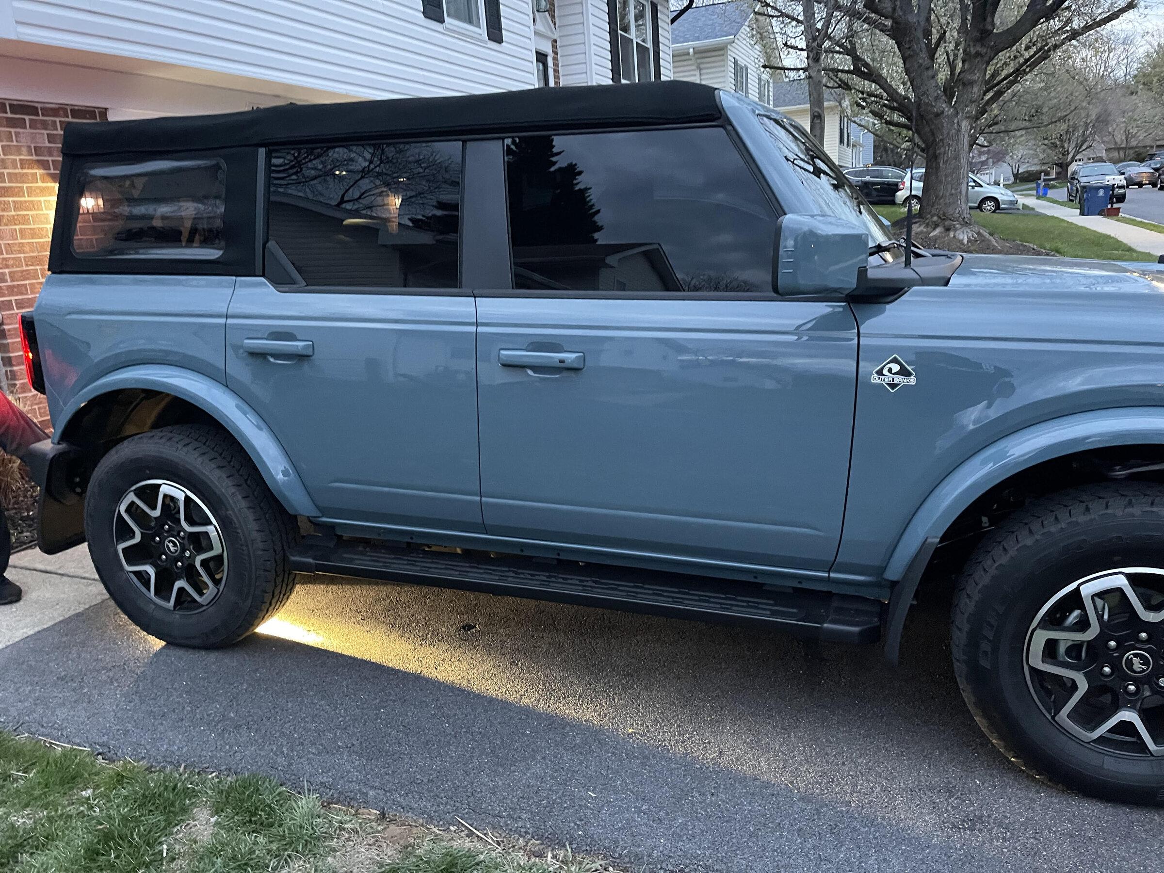

I have to say, I'm not hating it without the side steps.
I removed the side steps to have the installers put the mudflaps on. I will work on putting them back on....eventually...

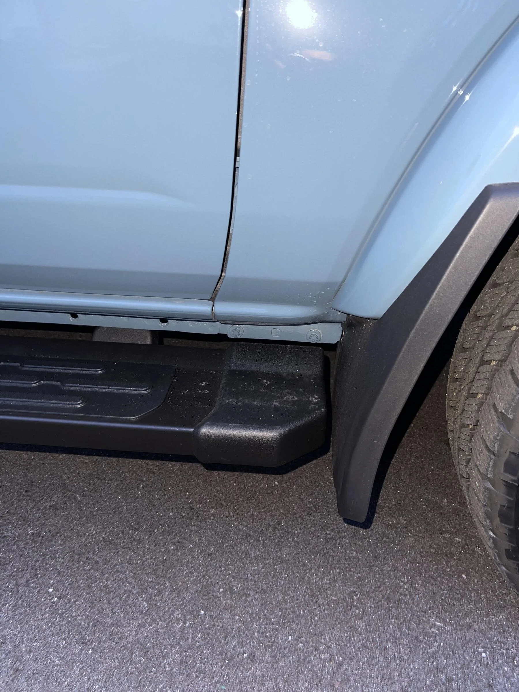

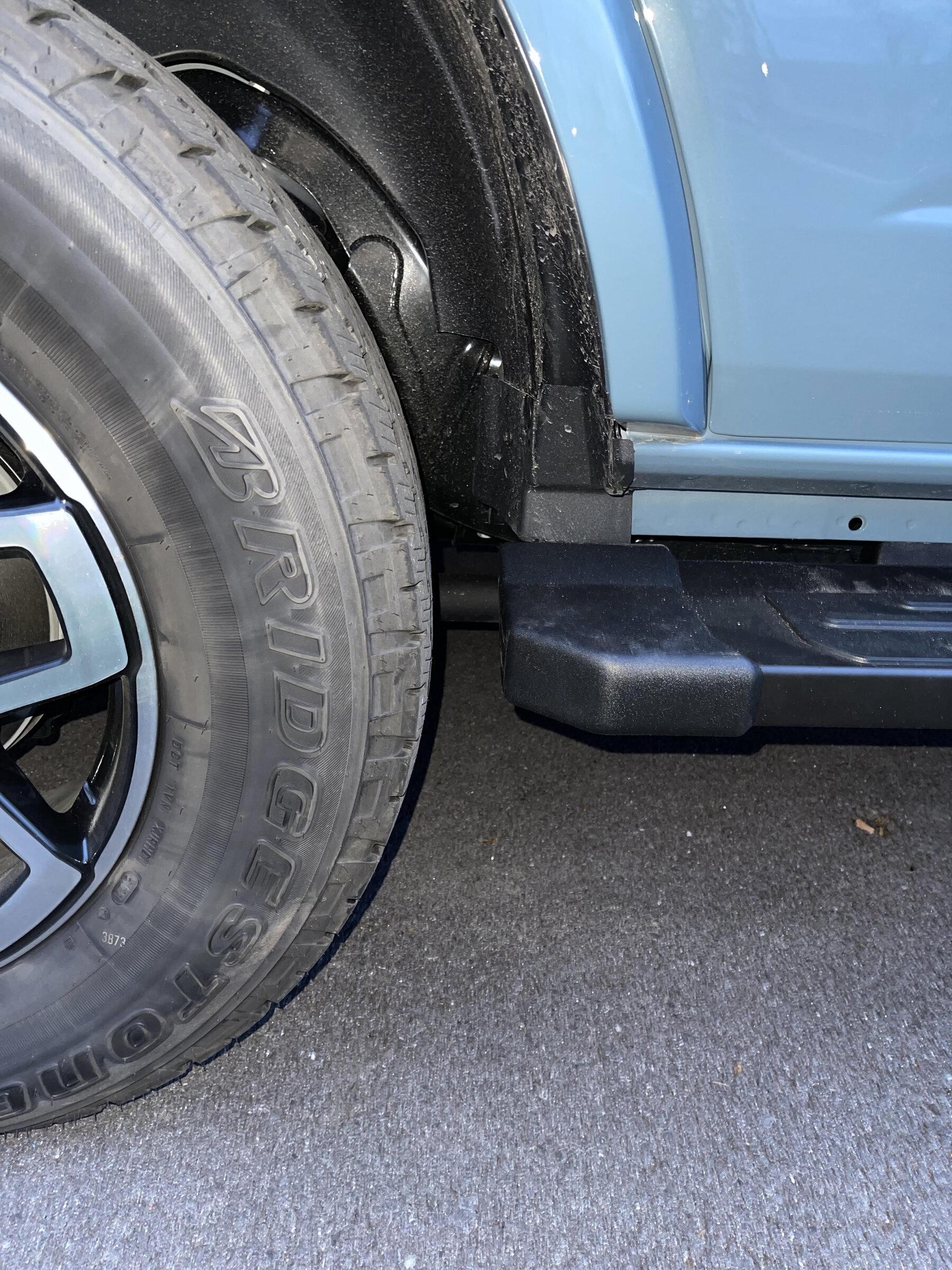

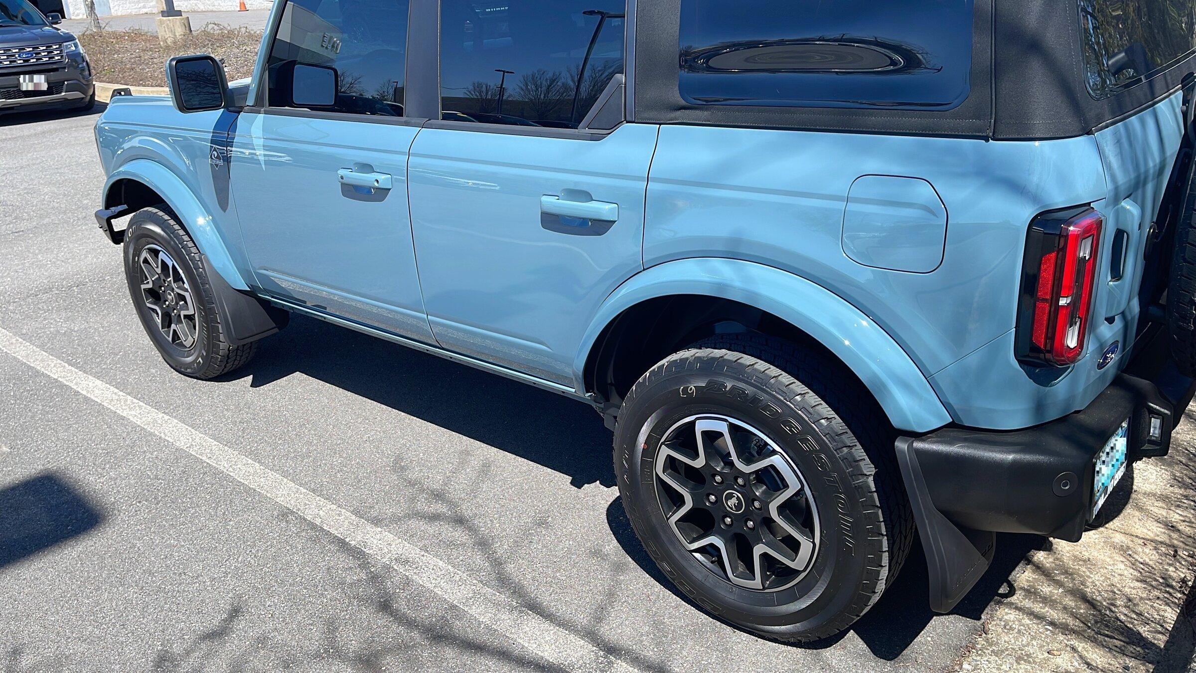

Finally! OBX w/ Ford mudguards with OEM running boards.
Reading in the threads, I was able to figure out the ol' switcharoo, move the brackets around, and drill some holes. (FYI, step drill bits are crazy useful for this project IMO.)
I feel much better using the original u-nuts in the running board instead of tapping threads into the aluminum boards, very thin metal in reality.
I don't know that I would recommend doing this w/ Sasq pkg, simply b/c of the distance in the rear that is left between the board and tire.
First slight mod and I'm very happy with it.
Thanks for reading!
-Rich
