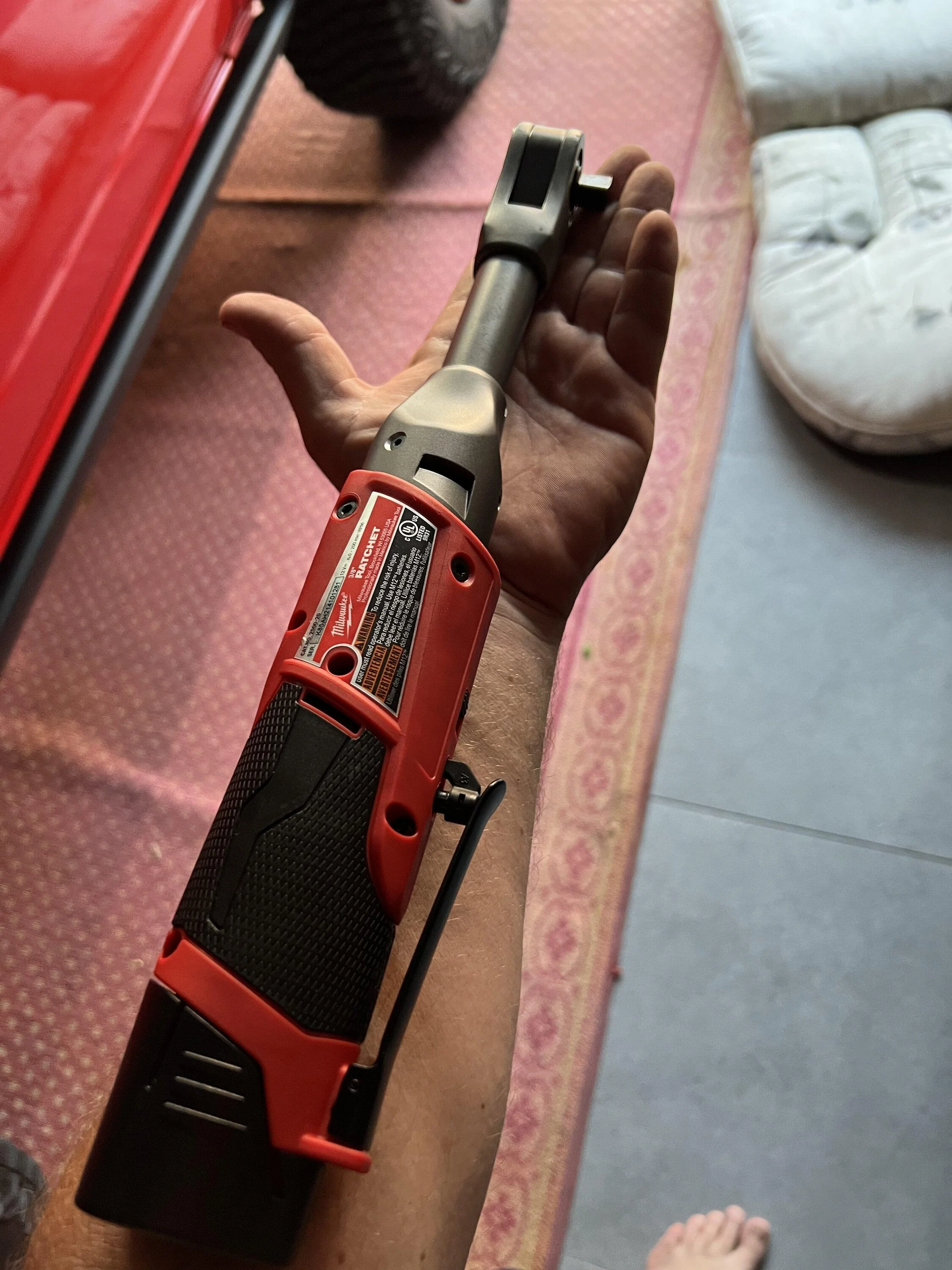

A good battery 90 ratchet can make life easier too. I grabbed a Milwaukee extended 90. Covers pretty much every star bolt on the truck. Panels, bumpers, doors, top, and some others. Very handy to have In the truck. Most ratchets are 3/8 and the bronco tools are 1/4 so make sure you grab a 1/4 to 3/8 adapter or a set of 3/8 sockets if you do invest in one. Can be used as a breaker bar on the stars too if the ratchet won’t power them out. I keep that and a spare battery in the tool compartment. If going for a trip I’ll toss the battery charger in with it, can charge them while you drive if needed.

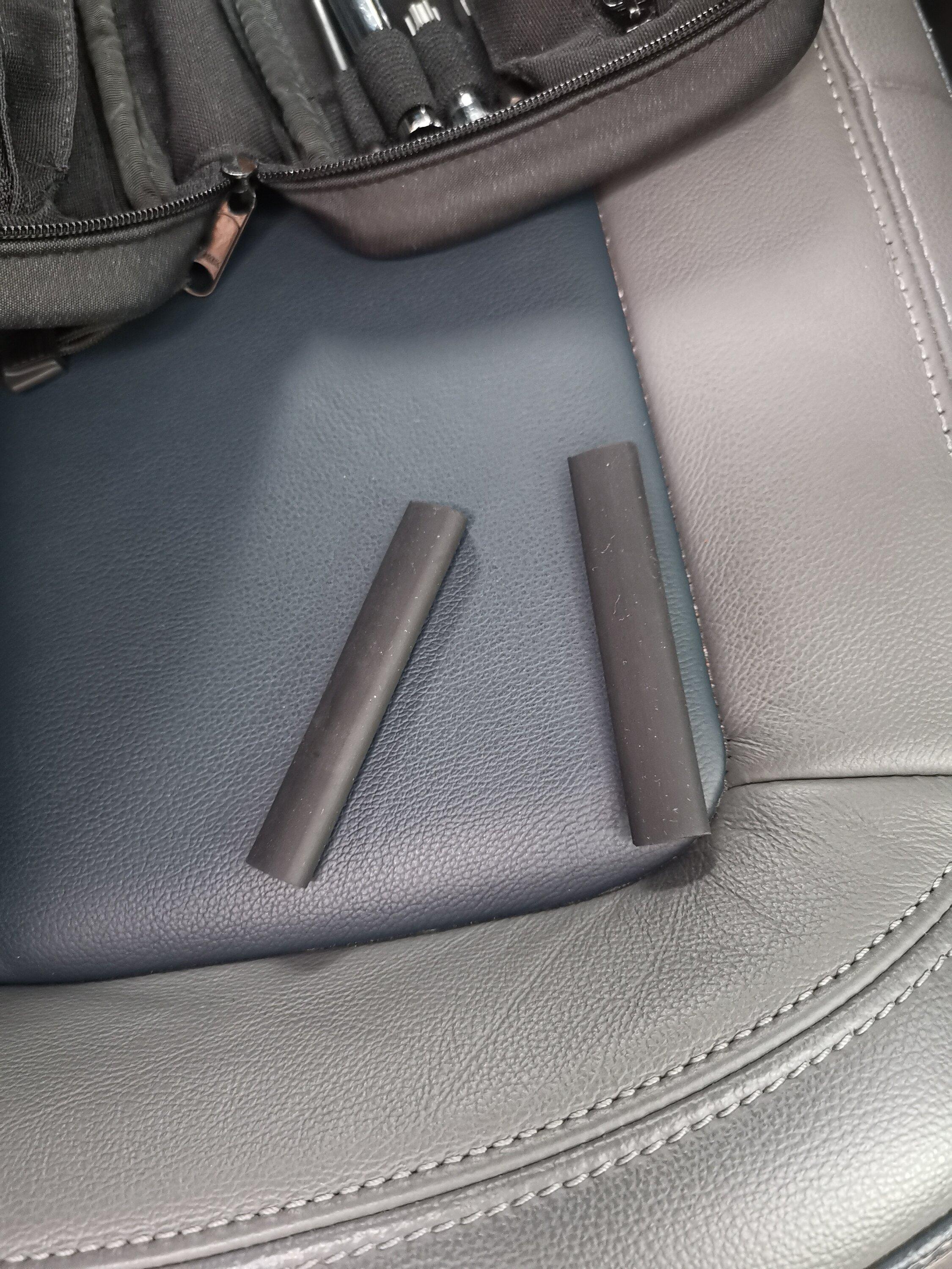

In the tool bag there are two small rubber bumpers that you put on the door to keep it from banging metal together.
I'll go snap some pics for ya right now.

Here are the bumpers.

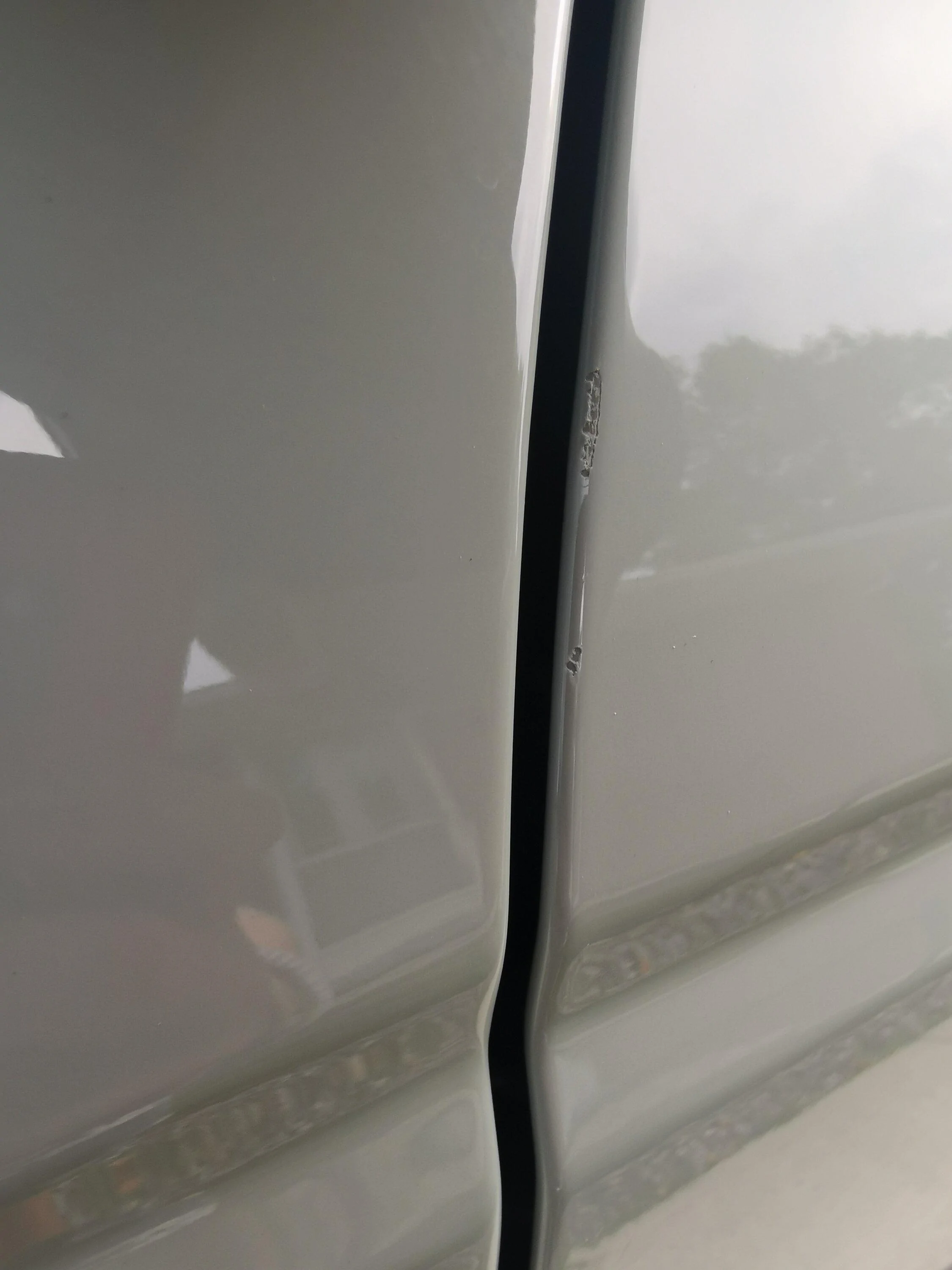

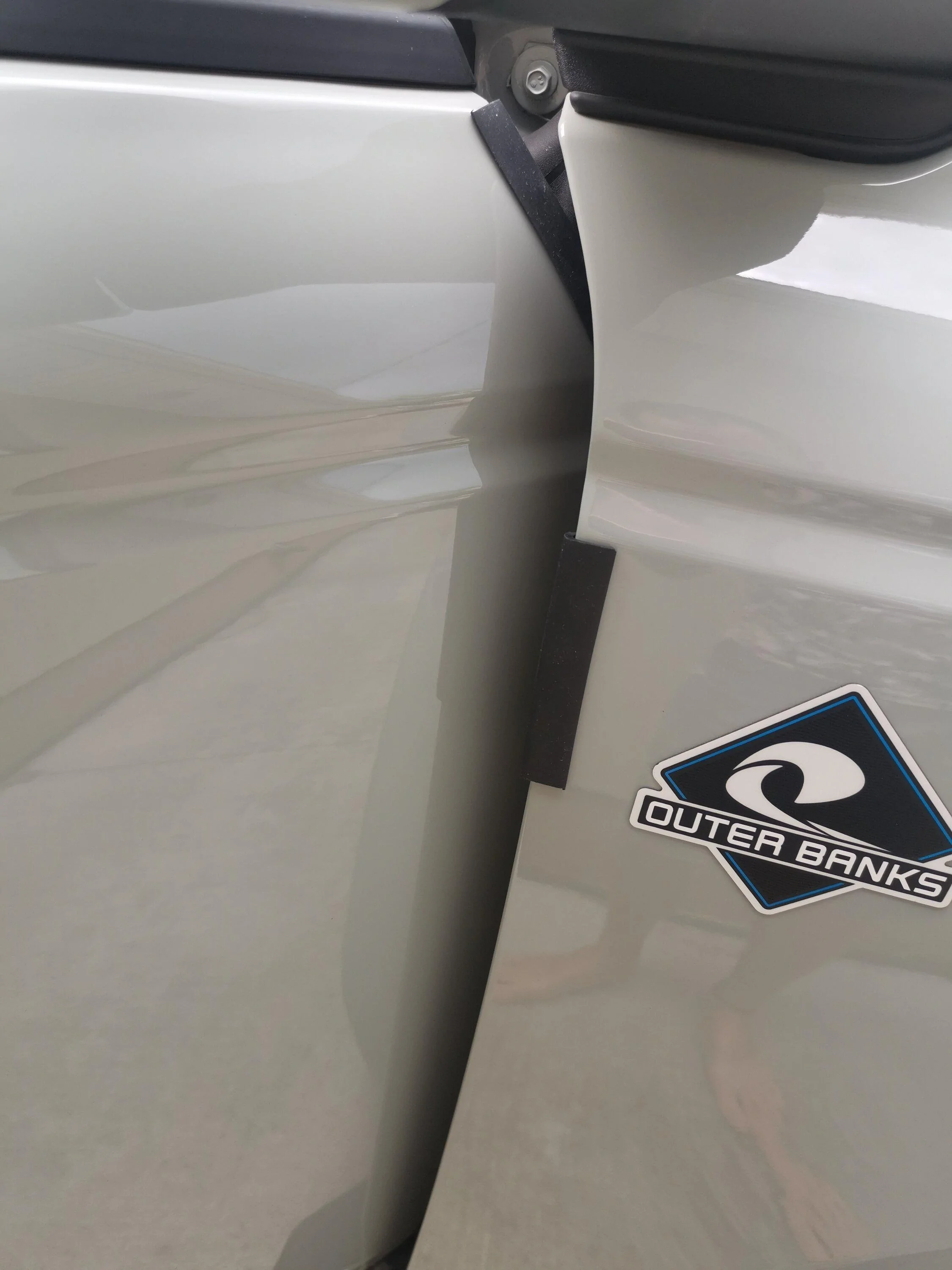

Add them to these spots. I found out the hard way where to place them. Not crazy but definitely hurt my soul when it happened.
The example is on the passenger door. The scratches are on the driver side door.
