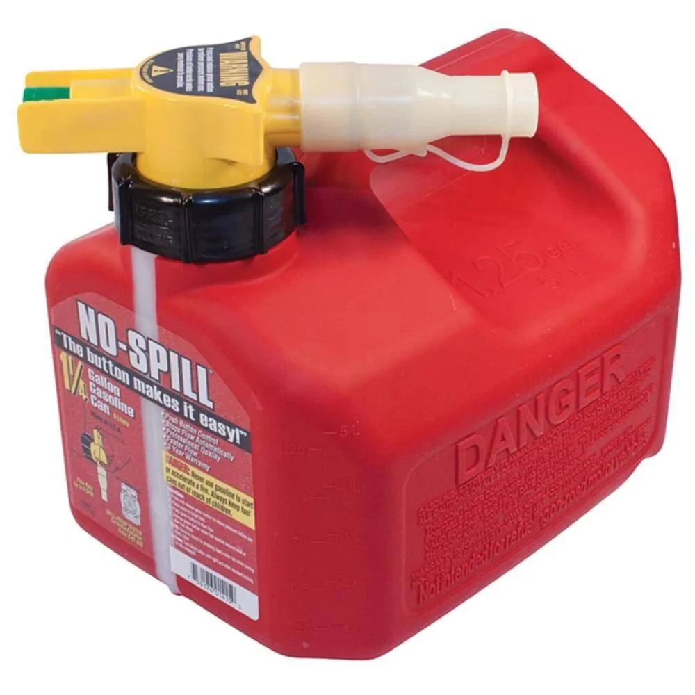

Yeah, sometimes I get OCD and try to fill it up way high, especially when I'm anticipating long mileage before refilling or I got some super discount on the gas. Gas prices have come down a little, but they're still a lot higher than when I bought my Bronco. But under normal conditions, no trouble.
A little off thread, but be careful with gas cans. Make sure they have thin spouts and can reach a few inches into the fueling pipe, and be especially careful with gimmicky "safety" mechanisms. The "No Spill" gas can is especially frustrating: the spout doesn't reach into the gas pipe, and the very resistant spring mechanism is really tough to engage when you're holding the can.
Ford Bronco Fuel fill up mishaps (Overflow) 1726446867112-c7
I ended up spilling a lot on the pavement--so much for the "No Spill" spout (that's its name!) and I returned it to Home Depot.
I recommend using the funnel that came with the Bronco under the floor in the cargo area. It fits perfectly.
Should be back there with the jack.
