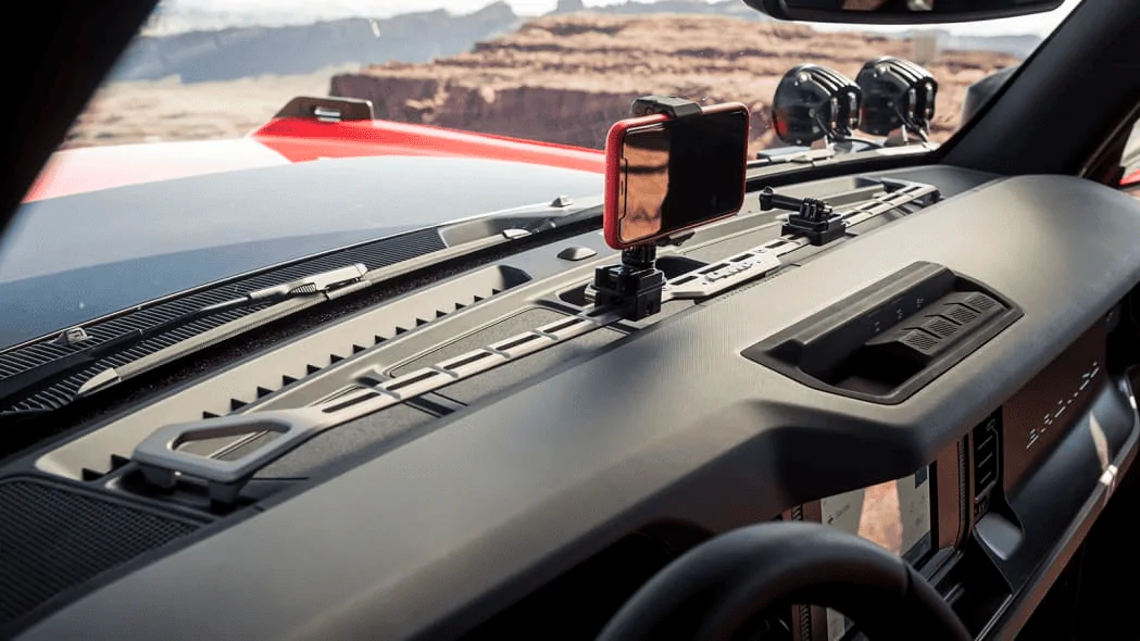

It’s just a threaded mount… on top of that 4WP will have a dash width picatinny rail available… you’ll be able to mount anything you want to either of those. The possibilities are endless. (Picatinny, threaded, Ram mount, etc etc etc)
On top of that Ford will sell you their own rebranded dashcam accessory that interfaces with the vehicle harness for power. Either in a single or dual camera setup. No word on where they think the rear camera is going to mount. (No integration with the 360 cameras though).
I thought originally Ford was offering that dash-width mounting rail as part of the Lux package?
edit: maybe it was just the USB in the dash? Woulda sworn it was the rail.
Just the power points on the dash.
The BYOD (bring your own device rail) is now a 4WP exclusive part. You can purchase it from them the second it becomes available, or from China via Amazon a few months after that.

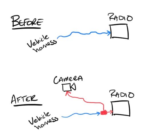

There’s a power harness for the camera that plugs inline with an existing harness on the vehicle to supply 12v.
No cigarette or USB cables to plug in.
Sorry, I’m a bit of a moron… Can you elaborate what this existing harness port is? Would it be under the hood or inside the cab? I hope they have an adaptor for 12V to this magic port, that way I can just my existing 12V dash camera :)

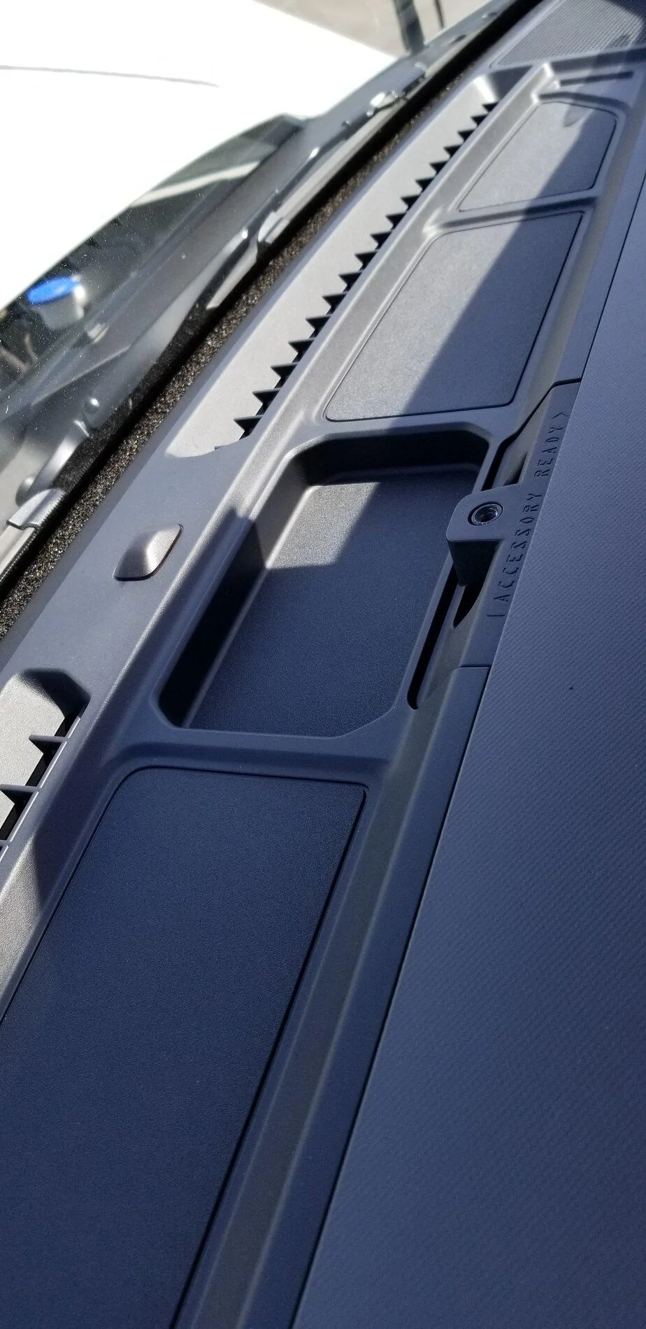

I really love that rail, but the lack of end mechanical attachments confuses me. Looks like they just have places for the end feet of the rail to rest, but not attach.
Seems like there would be a lot of device bounce the further from the center mount you get.
Like, there's a power harness that plugs into the back of the radio... so the dash cam comes with it's own harness, that plugs into the radio, and then the cable that did run into the radio now plugs into the camera harness.
Thanks for the details, and drawing - You likely felt like you were explaining this to a small child LOL.
Sounds pretty slick vs. Having some additional wires and stuff all over the place.
