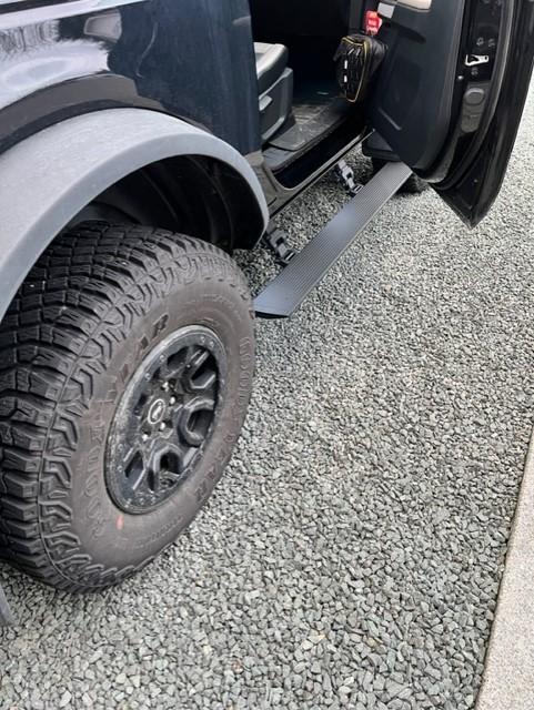

A LOT the factory steps are borderline useless.
These stick out about 6-8" and split the difference almost in half from the door sill to the ground.
Compare these photos to the new steps above, the muf flap is a good indicator.

two door version they fit great the instructions I had for the 2 door were often wrong LOL but
great fit looks great and very happy with the GoRhino Boards
I preferred the Magnets Over Hacking and chopping into the Bronco Harness very simple and no affect on OEM Harness or OBD Port, thats why I was set on Eboards

I really like how they tuck up nice and close to the body. They really look good on your Bronco.

Thanks they did a good job making them seem tough enough for me anyway
I don’t drive on a rock lol or need sliders

2 door badlands here and agree with other comments. Love how they look and that I didn't have to hack into the wiring harness. As others have said the instructions were for the four door and it took me a minute to figure some of the steps out. A few notes to help other two door owners.
1. The controller mounts to the rail behind the drivers rear motor. You need to mount it before you mount the drivers rear motor.
2. I had to take both the driver and passenger seats out completely in order to fish the passenger door wire under the carpet. It's a pain but totally worth it.
3. I have no idea how anyone else mounted the ground wire on the door sensor to the seat belt. So far as I could tell you'd need to remove the entire panelling to do that. Instead I was able to ground both sensors to the seat bolts when I re-installed them.
4. When tightening the four motors just hand tighten them at first. Once everything is done and you can deploy the steps you'll have a ton more room to get your wrench up in there and tighten them down.
With all of that said, they are fantastic. My wife loves them and it really makes it much easier to get in and out of the vehicle.
