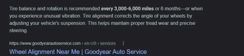

You'll find a thousand different answers on the proper frequency for alignment checks. I follow the somewhat older advice of getting alignment checked/corrected every wheel rotation, or about every 6K miles/6 months.
If I notice a wobble or the steering wheel pulling a bit, I'll go sooner.
Wow. The general public sure doesn't get an alignment every 6k!
