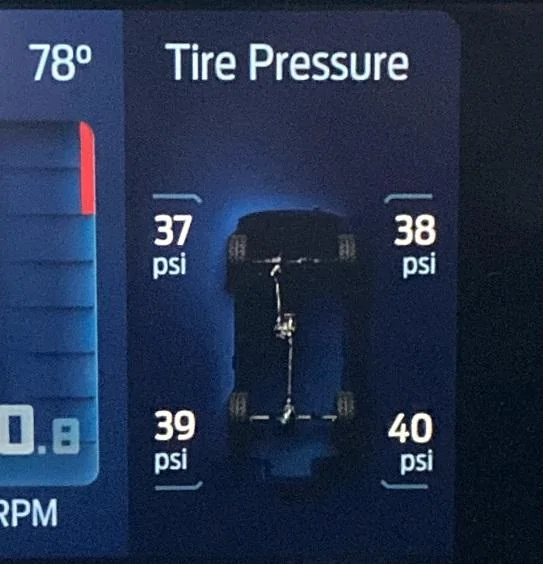

I swapped my wheels and tires for a completely different set. The new set had different OEM TPMS sensors from another Bronco. I can confirm that my bronco was able to recognize the new set of sensors, and knew which sensor was where, without doing any sort of reset. While installing the new set of wheels, I intentionally set each tire to a different pressure, using 37, 38, 39 and 40 psi based on my pressure gauge. I then took the bronco for the first drive, and within about 2 miles of driving, the display updated and properly showed all 4 tires at the right pressure at the right locations. Awesome.
So for those of you who swap to a different set, or when you rotate your tires, you won't have to worry about any sort of reset.
