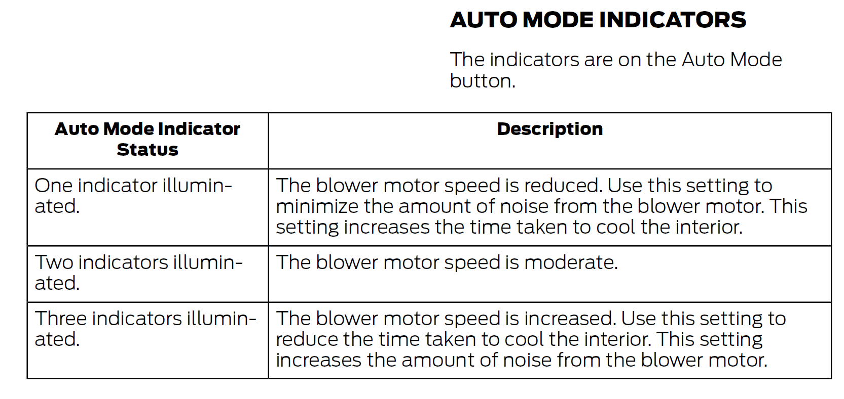

I did a search in manual in car. Didnt find anything. Except some generic messaging.
anyone know what the 3 lights designate?

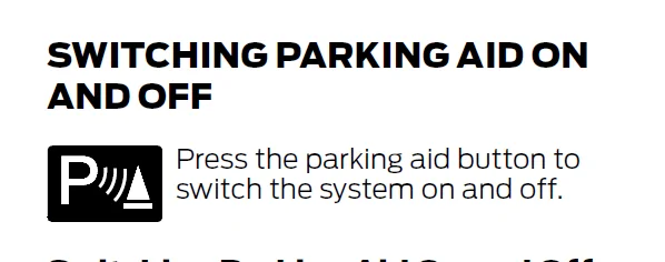

Anyone know what the “P” with the tower button does?

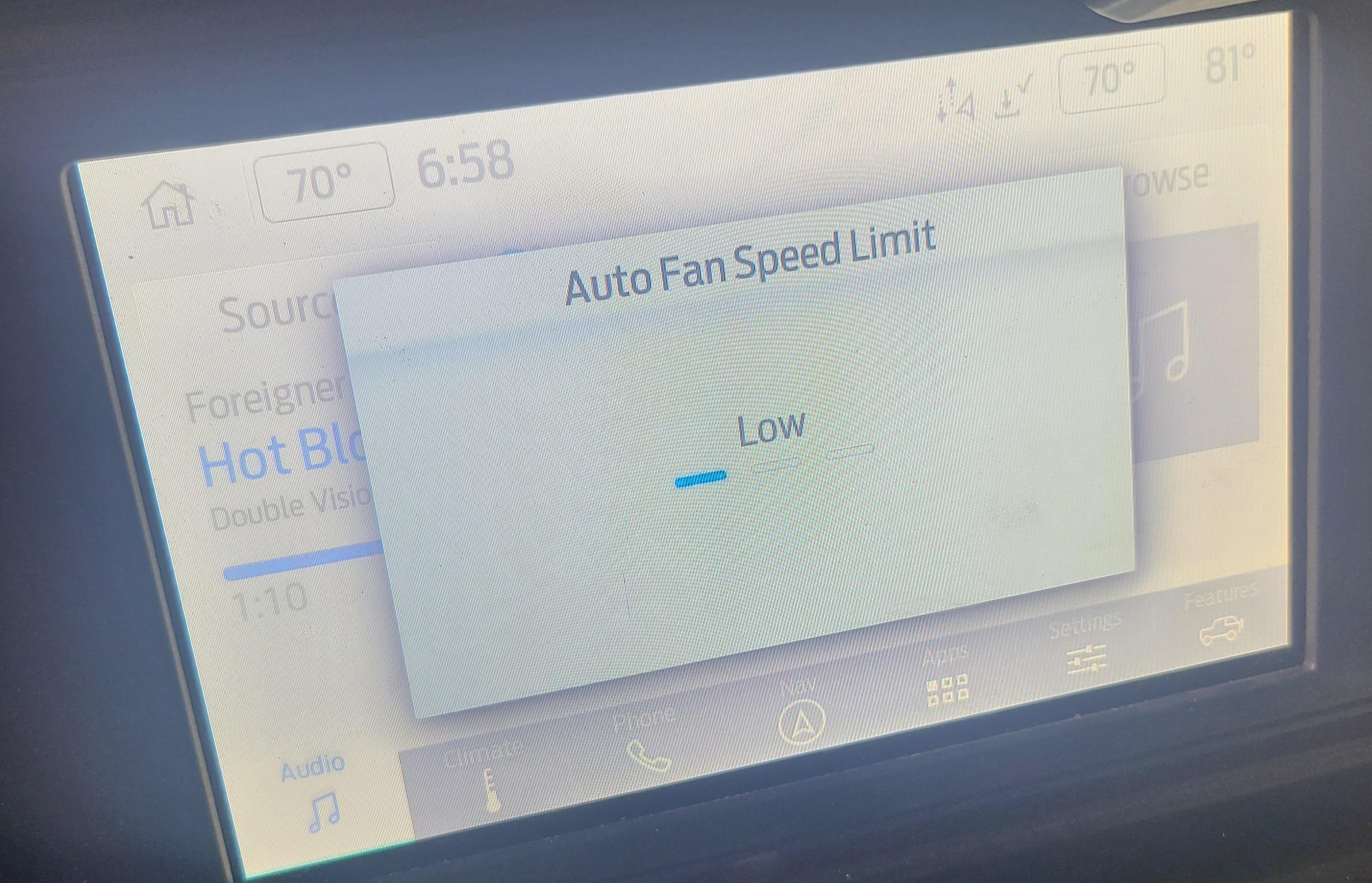

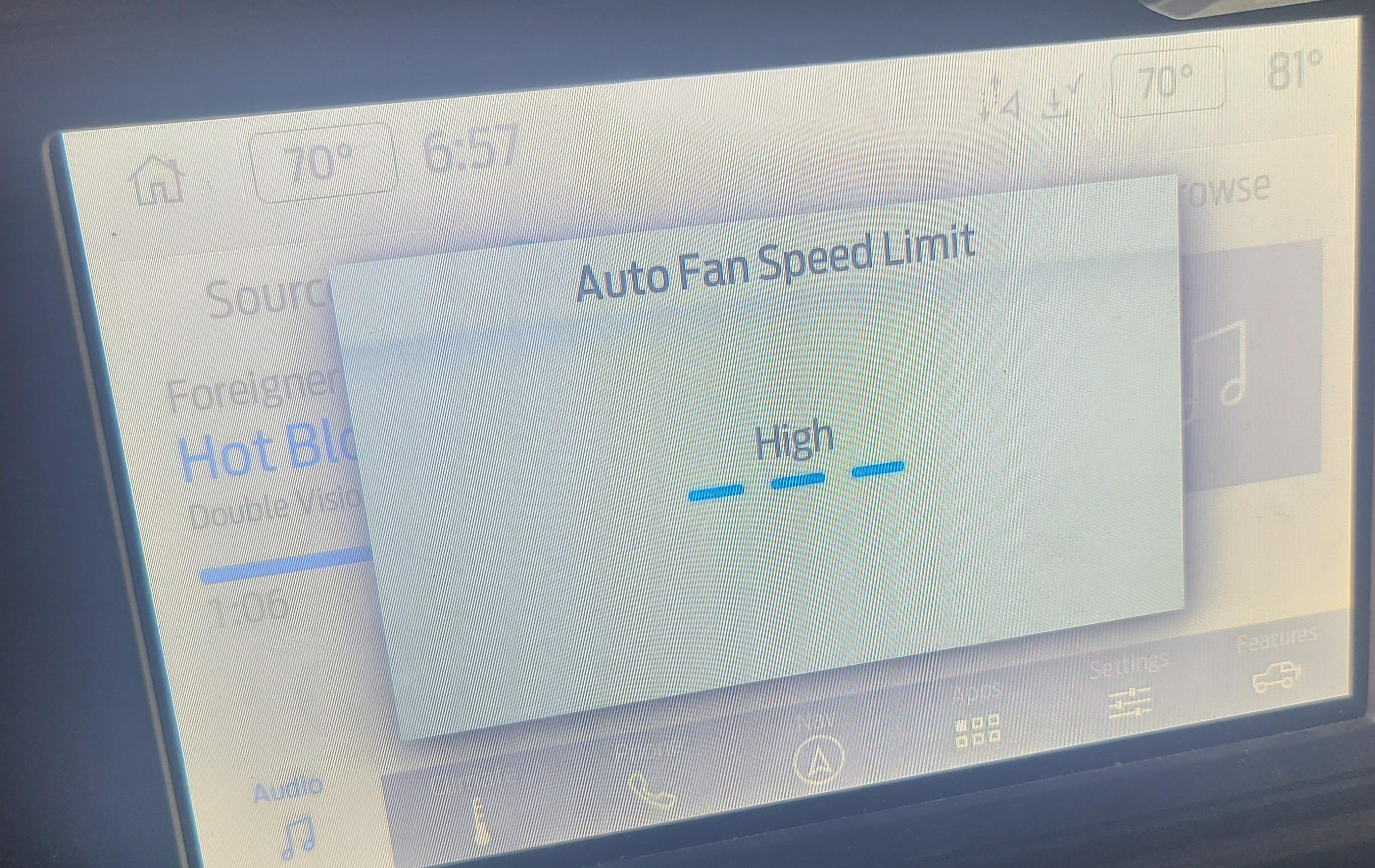

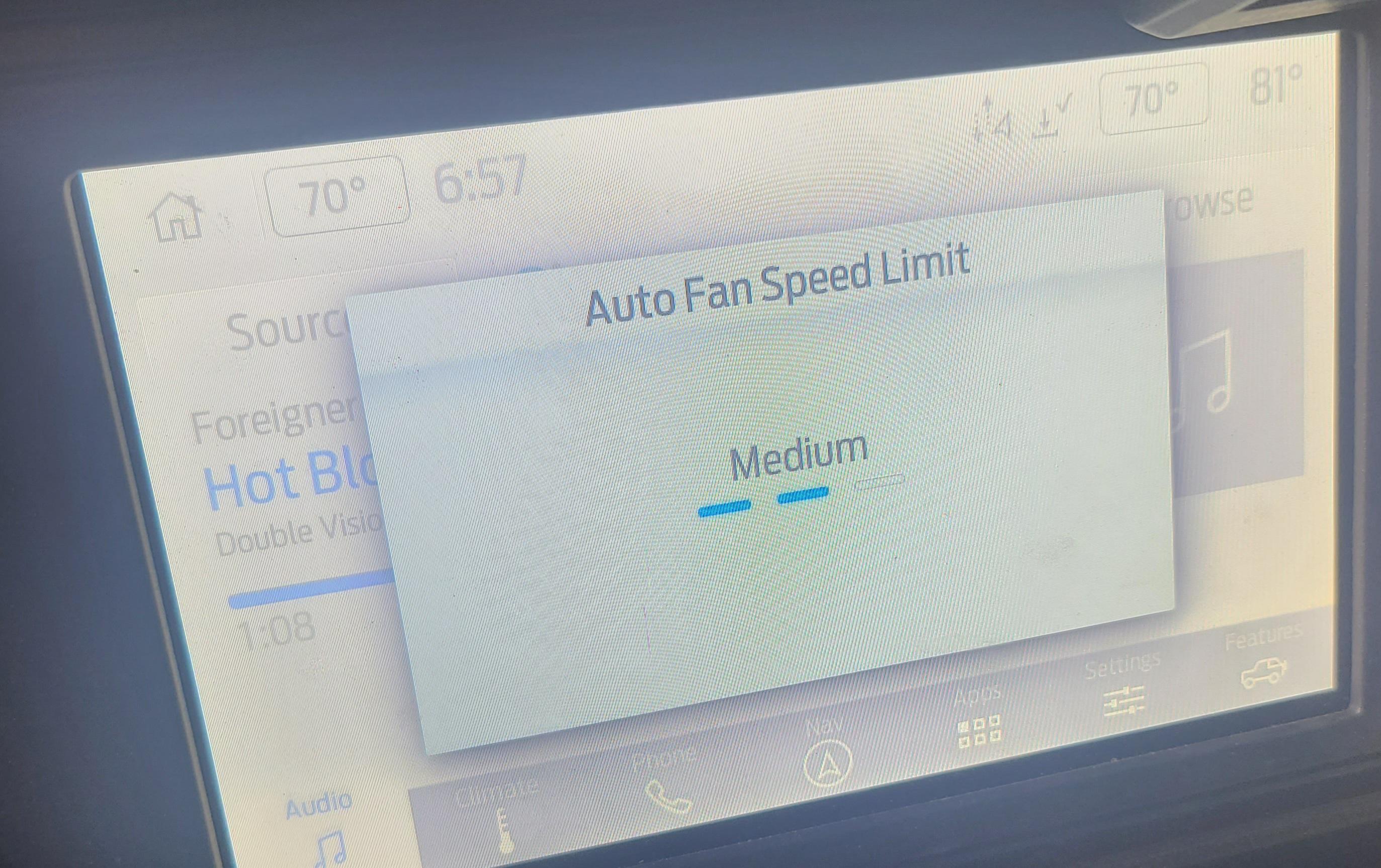

Ford Bronco HVAC Climate Control Auto 3 Lights- what do they mean? 1685228974297
It's been answered, but when I push it, I get this in the display (I turned some things on in FORScan)

The dot on the auto button each represent the fan speed output to get to the temperature that was selected on the rotary dial only when in auto. 1 dot is slowest fan speed, 2 dots medium fan speed, 3 dots is the fastest fan speed.
So is are the fan speeds in auto 1, 4, and 7?
