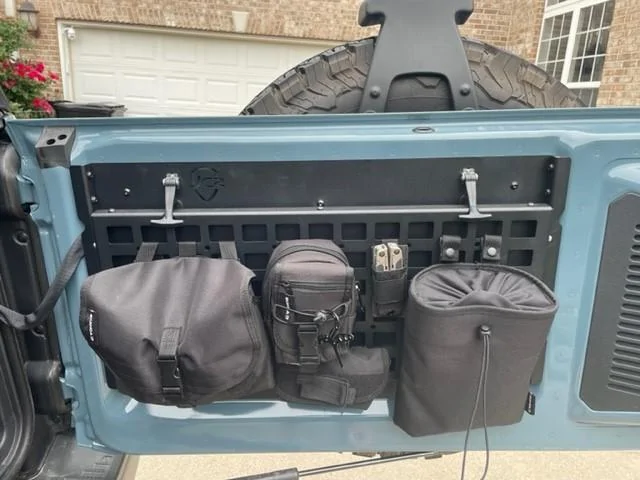

Check out JCR off road's no drill option. High quality, nice hardware, no rattles, 'Merican made.
I originally had the MOLLE bag panel, just moved the bags to the new table. Its NOICE.
https://www.jcroffroad.com/product/BR6-TAB.html
I'm not offiliated with JCR outside of being a very satisfied customer who's been happy to send them a couple grand at this point. :)

I like it!
I may get that and replace the OEM table. I’m guessing it would hide the holes?

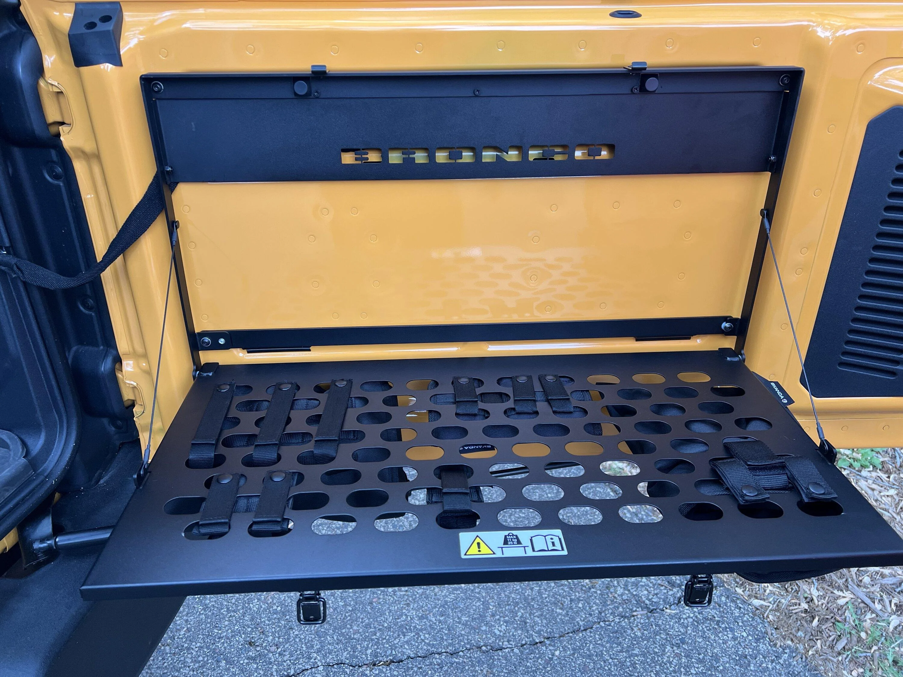

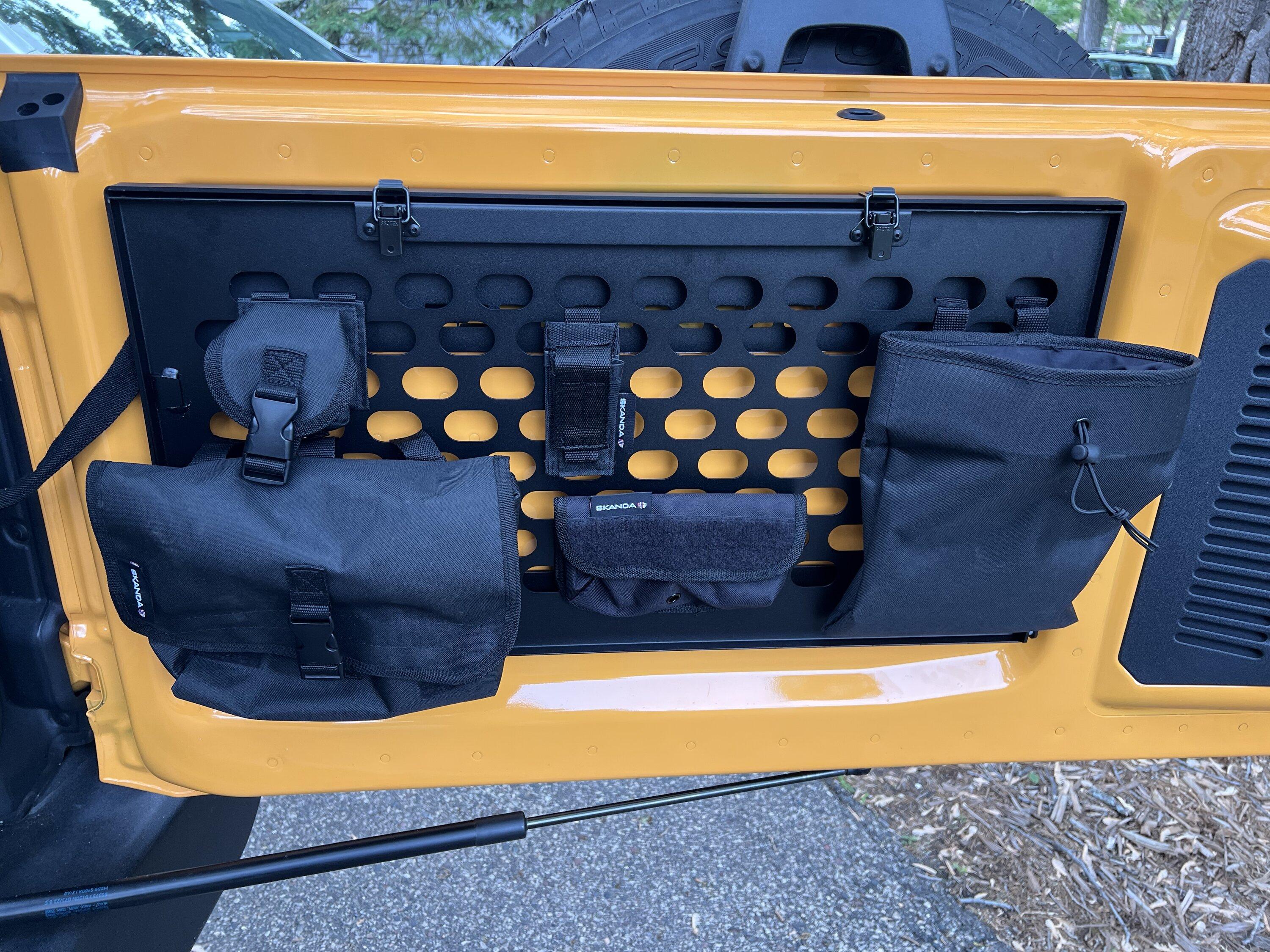

I finally got around to installing the tailgate table last night. Reading the threads I was a little uneasy about it but I bought it and waited too long I couldn’t return it. With it now installed I wish I didn’t spend so much time worrying about it. It was a 4/10 install difficulty if you watched YouTube videos while doing each step (which I did). If you were following the directions only, I could see why it’d be harder or more confusing.
On to the tips for you:
- With many saying the provided hardware can fail, get the Hillman jack nuts. I have extra I can send you if you’d like for free. DM me.
- Use a centering punch, eliminates the need to build up to the big bit.
- Use the bit stop, also eliminates the need to start with smaller bits and get to the big one.
- I don’t have a torque wrench that goes as low at 6.5. So I used a hand Allen wrench. This helped me from over tightening and breaking the jack nuts.
- Take it slow.
- Watch these YouTube videos while installing
I can report ZERO rattle and it works great! One disappointment as others have stated is the unfinished area behind the plastic trim. You can see it through the Bronco letters. I’ll have to come up with a solve for that.
