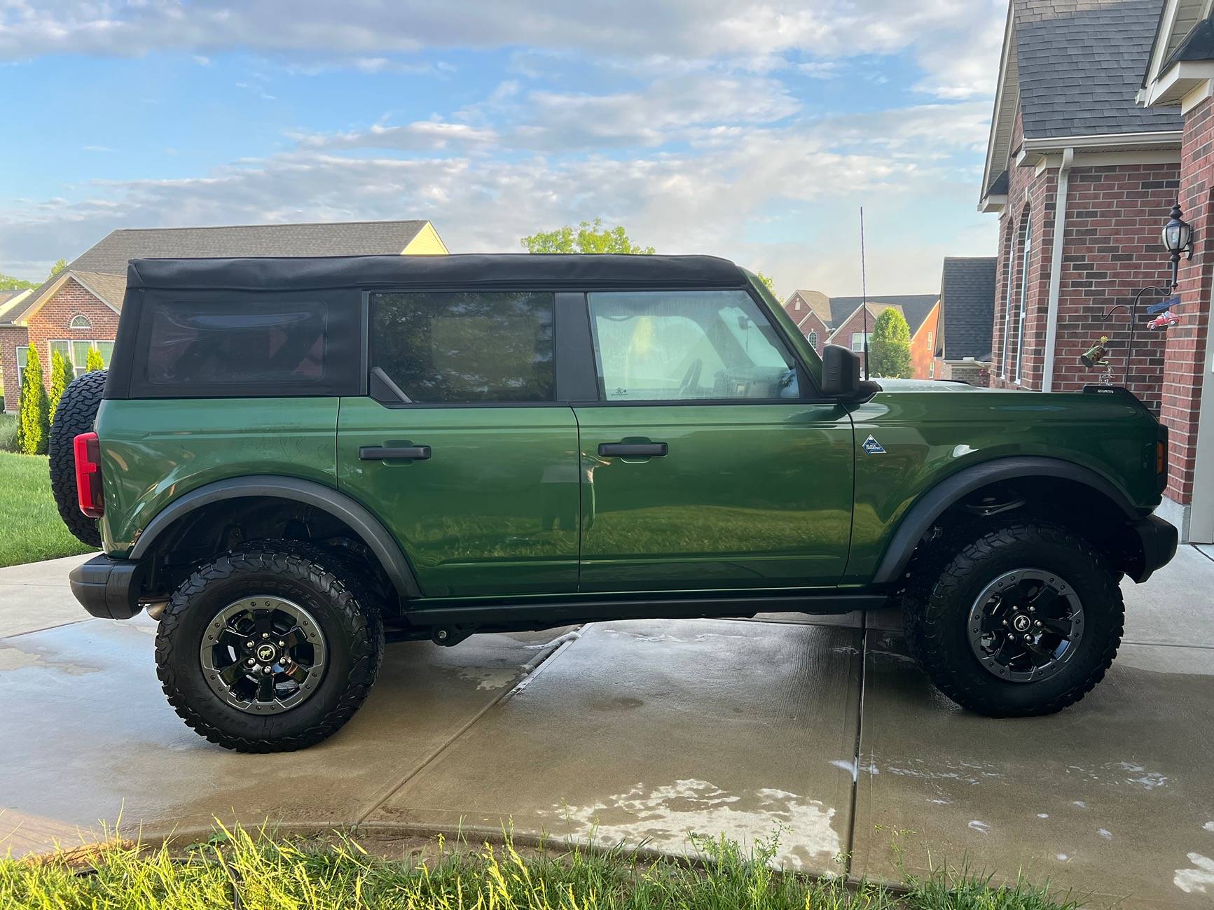

I installed these on my ‘ 23 Black Diamond V6 4 door and only got .75” in the front and 1.75” in the rear… I do think the ride is much better than stock on the street and excellent on rough trails…
Ford Bronco Just installed Ford Performance Bilstein coilovers IMG_2730
