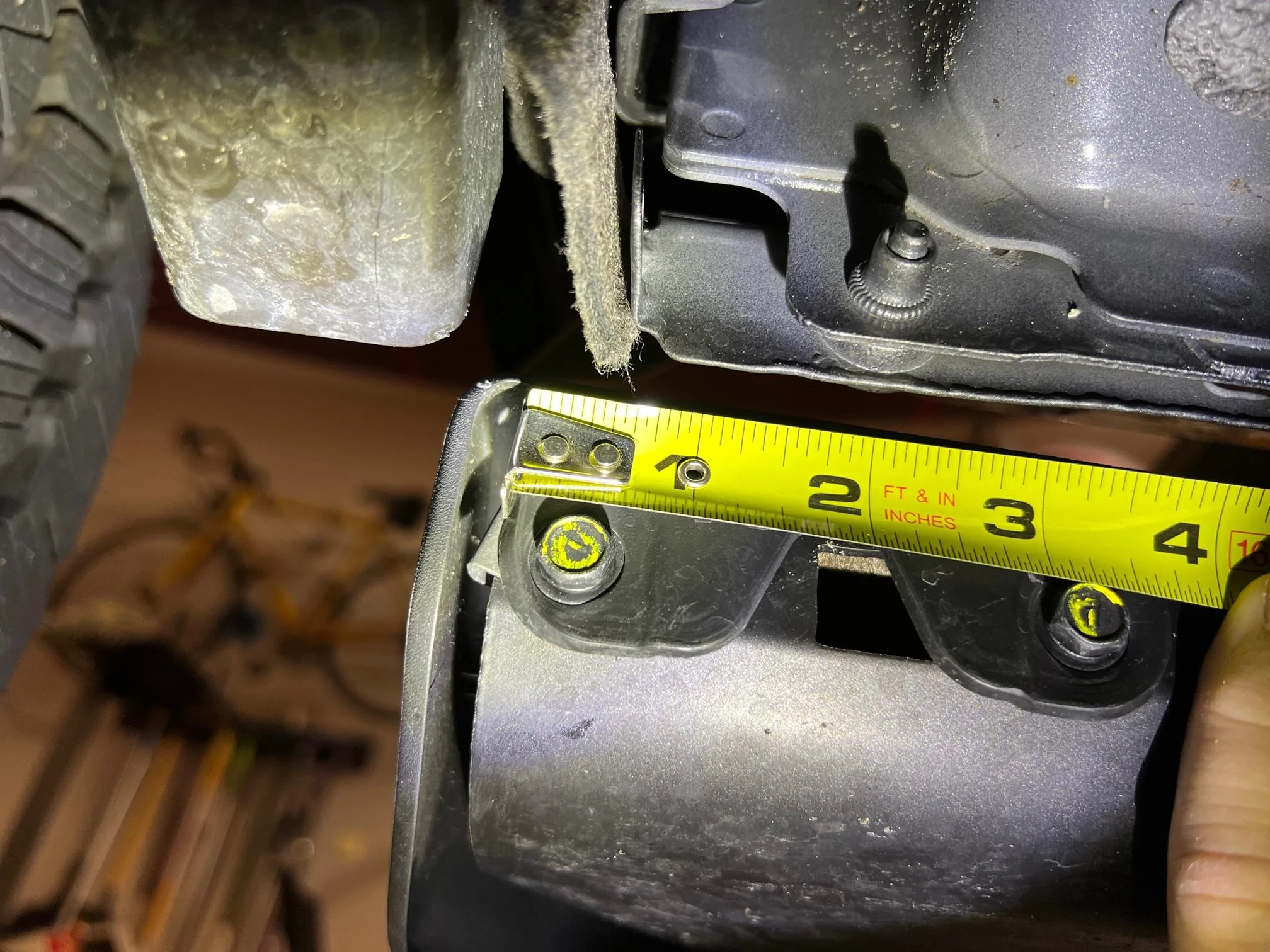

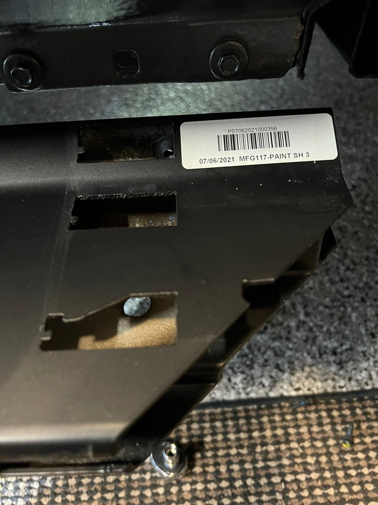

Did you remove the crash bars? I have a 4 door and as mentioned, they are 3/4 inch too long. I just haven't gotten up the nerve to cut them down and then work on the notches.
I swear those rails are plastic. I am going to try a heated box blade on the notches instead of a dremmel tool when I do it. Miter saw on the end and angle cuts.

Yeah, had the crash bars removed when I added the lift and 35s.

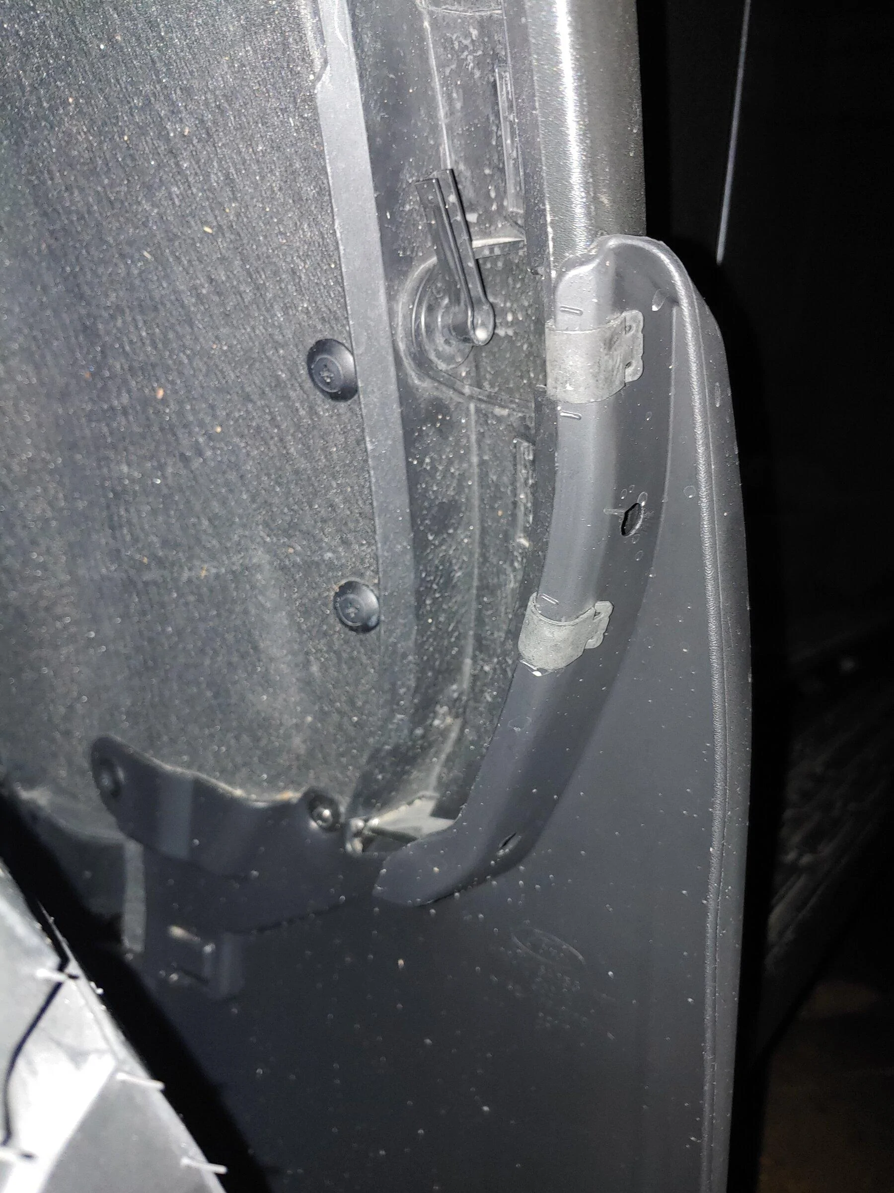

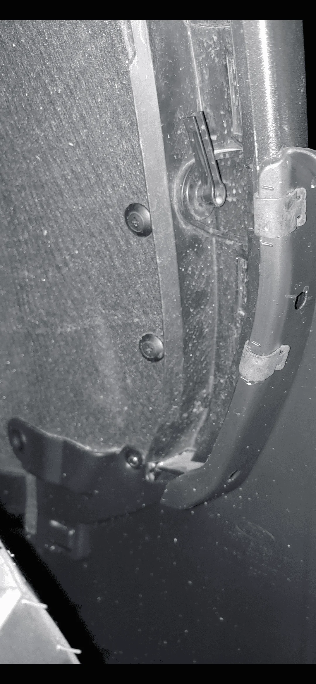

Thanks for the info! The instructions included with the mud flaps are terrible! Do you put the mud flaps behind the wheel liner? Are you able to take a photo of the installed front mud flap at some point? So I can get an idea of how it's installed? So no drilling? I see in the instructions that the tools needed includes a drill bit, or am I thinking of my rear mud flaps?
On top of the wheel liner. I have a 2 door non sas Bronco (added lift and tires later) and only installed the front flaps. Not sure about rear flaps, or differences if you are installing on a sasquatch. There are 2 pre drilled holes you use and 2 fender flare clips.
